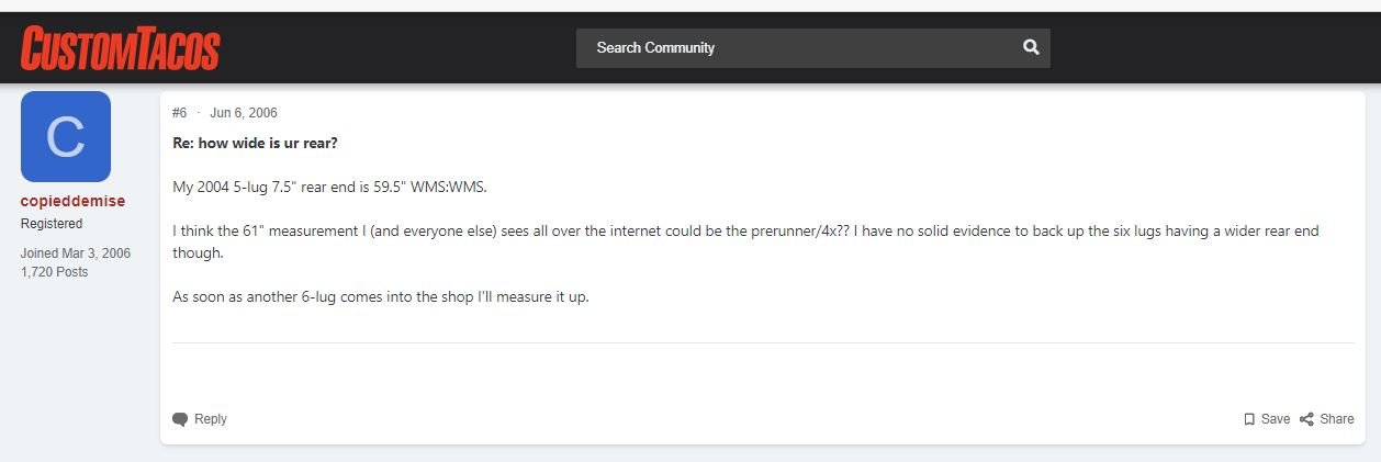

    Im a 5 lug street truck so LT might look kinda silly, lol. I can always cut down the housing and get custom axles if need be but I doubt I will ever get that much traction to need one, guess we shall see!

    Tundra has five lug.

    A double slip is another option. If need be.

    Depends on the year

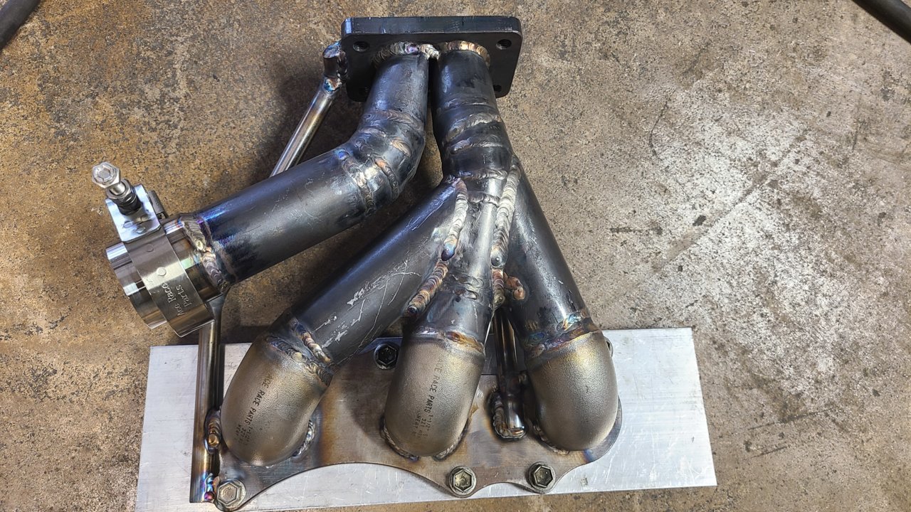

    @Torspd we took the manifold off, and it was cracked in the same spot as last time :annoyed:
    Brought it to a welder I work with, and he cleaned it up pretty well, and got actual good penetration (giggity) this time.
    I'm ordering another manifold, this way if it cracks AGAIN I'll just replace it. I actually didn't think it was cracked this time, as shining a flashlight up into it didn't reveal anything when it was on the truck.
    BUT- if it cracks again (Or once the new manifold comes in and I just replace it), I can certainly send you my cracked one to use as mockup for a manifold. I even have the old manifold gasket I'd throw with it so you have a reference point, too.
    I tried messaging the manufacturer to see if they've upped their quality control, or changed anything in the design, since this is the 2nd time I've had to fix a crack in the collector area. We ran out of daylight today by the time we got done with welding it, but we'll be putting it all together tomorrow so I'll get some pics once it's all in. Hopefully this solves my problem of making ZERO boost, and running like ass lol.

    There are a few actions that could help. The easiest is to add a support/s. Due to the fact that it is thin wall, it will alleviate some stress.
    Here is an example of what I did.

    Thank you, about the supports. 1/2" 304 stainless, if I didn't mention it before.

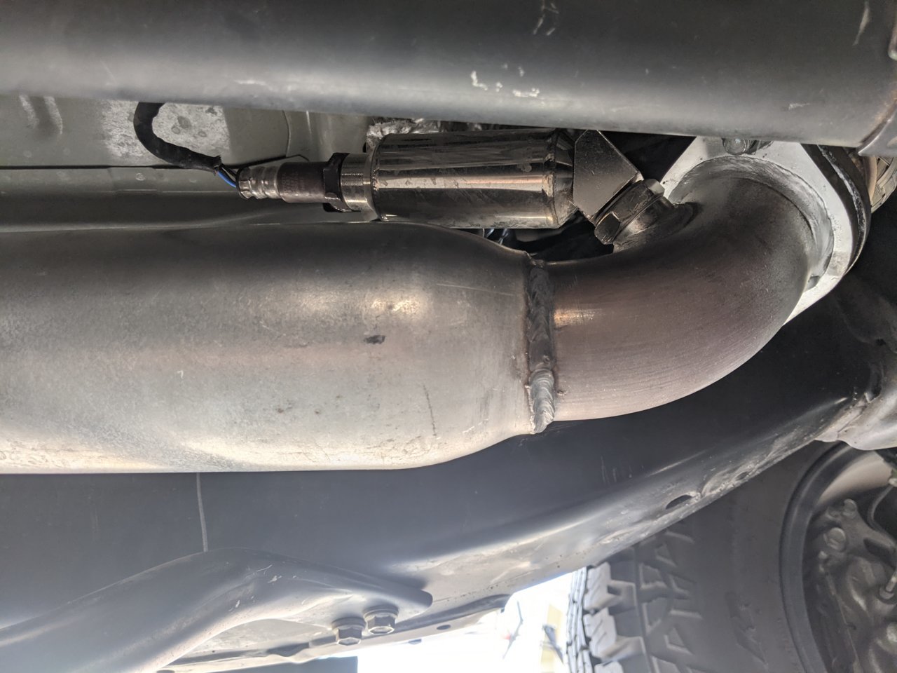

    I did that for my gf, years ago.

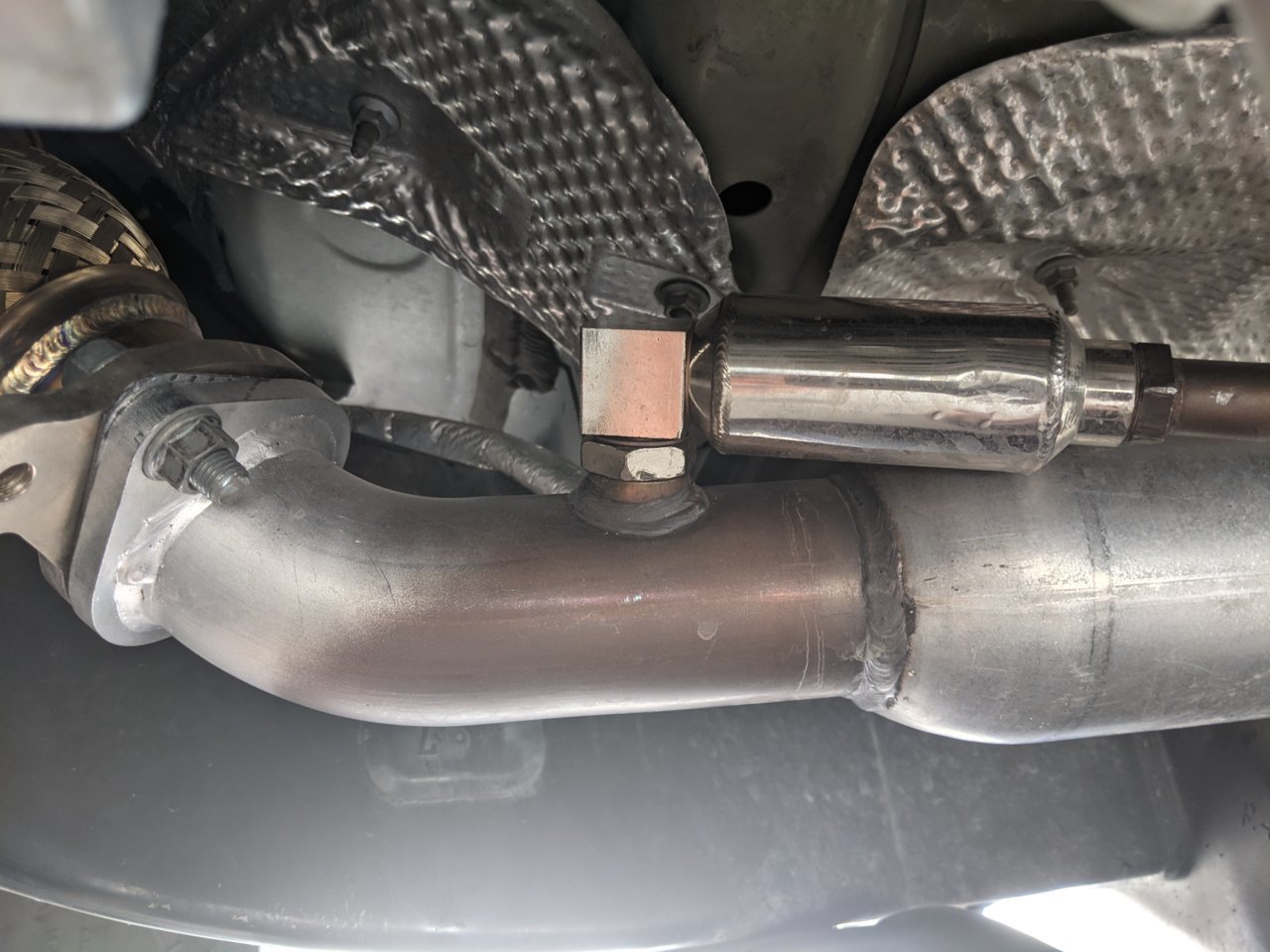

    @mZiggy used something similar on his 3rd gen. They may work on yours. Only one way to tell.

    I'm using Fabspeed o2 sensor spacers with mini-cats for my rear o2's, with catted downpipes installed. One 45° fitting and one 90° fitting, because the driver side y-pipe o2 bung location for both OEM and aftermarket means that a 90° fitting would have your mini-cats trying to sit where the pipe does. Doesn't work. So the 45° does the trick. You'll need a 27mm wrench. Lol
    I also recommend Remflex gaskets for a good seal at the connections. The Toyota donut gaskets are shit, even with brand new ones I had leaks. Downpipe/dumptube/whatever to y-pipe is 2.25"
