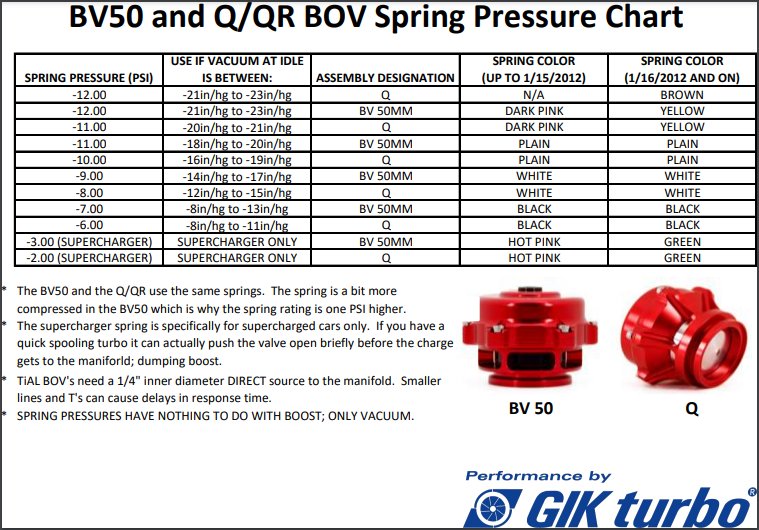

    Swapped my knockoff HKS BOV for a Tial Q knockoff lol.
    What spring are you guys that have it running?
    It looks like I'll need the 11psi spring based on the chart of vacuum readings at idle:
    In other news, hopefully swapping to the URD Power Pipe tomorrow after work!

    Old one was leaking slightly, and there's no adjustment on it. It was a knockoff so I wasn't too upset about it. Plus, when I was removing the vacuum line for it (We did a boost leak test with the BOV eliminated), the fitting came right out the back. It's press-fit so I said screw it I'm going with one that's known not to leak and still has juicy sounds lol.
    I ordered a 10psi and 11psi spring for the Tial. I see at idle I usually pull about 20in/Hg of vacuum, so it seemed to line up on their spring chart. Figured might as well get both to be safe.
    The 6psi that came with it was staying open at idle, which wasn't affecting anything since it's pre-MAF. But I want it to be right.
