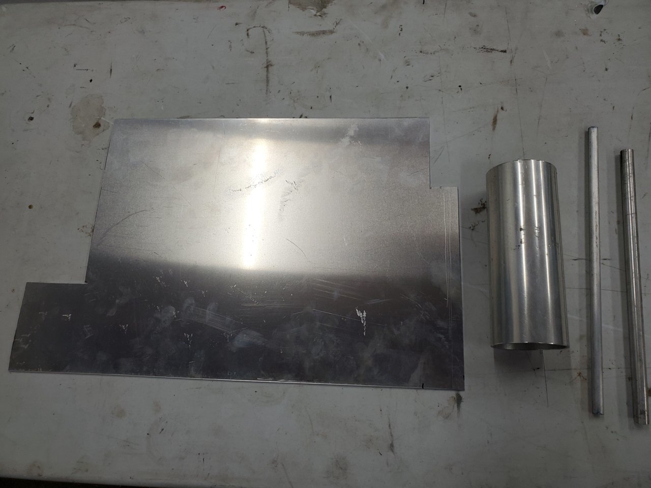

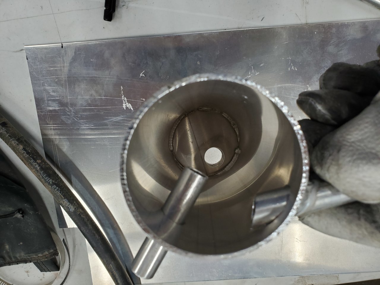

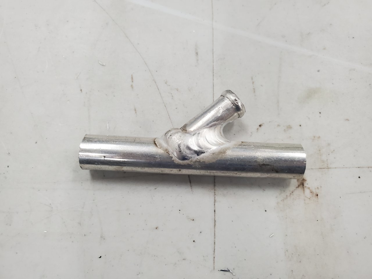

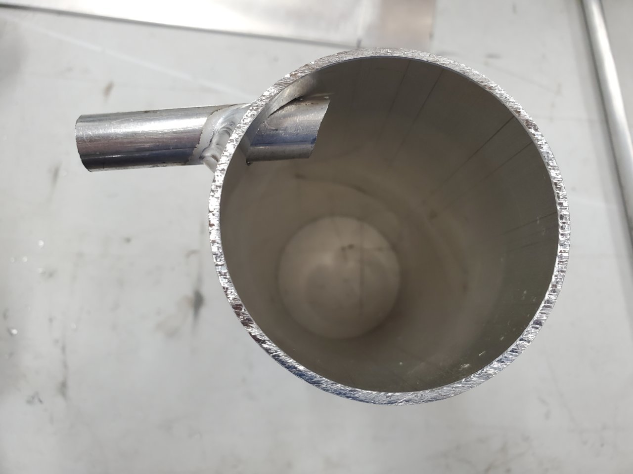

    I had the crank vent and Pcv recirculating into the intake pipe pre turbo. I would always notice a little oil in there when I clean the filter.
    Finally made a little Aos using what I had laying around. I didn't have any extra line to lengthen the Pcv hose, so I turned it around towards fire wall to merge with the crank vent hose. I had to salvage the nipple off the intake pipe and make a Y fitting. Crank hose was perfect length. It then goes to the can where air/oil collects/separates centrifuge style. Center draw from can then back to the intake.20210730_160210.jpg 20210730_170234.jpg 20210730_170242.jpg 20210730_174503.jpg 20210730_181221.jpg

    By the looks of it, you have a petcock or plug on the bottom for a drain, yes?
    You sure made that simple, compared to what most aftermarkets like to do. Simple and effective. :thumbsup:
    Jon64l likes this.

    Yes, it has a drain port on the bottom.
    I'll keep an eye on how well it works as I put some miles on it.
