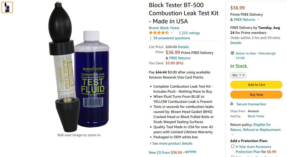

    Unfortunately, if Coolant is being 'Consumed' then you have much bigger trouble than a leak. Just to be sure you are aware, the level in the overflow will vary noticeably with temperature? So be sure to compare levels either always when the motor is Hot, or always when cold.
    If you suspect consumption: Head gasket trouble would consume coolant, and there is a neat and quick test for this at any typical garage. They attach at the radiator cap and sniff any air out of the radiator while the engine is running. If there is exhaust present in the coolant, a chemical in the device turns color.

    @mZiggy Sorry, I did not intend to cause you undue concern, I simply responded to your statement of possibly "Consuming" coolant. Loosing coolant is far less troublesome.
    It would cause white smoke, depending on the extent of the leak. It also would eventually show black oily residue floating on the coolant in the overflow bottle, often sticking to the sides of the bottle as a dark ring.
    Should observation raise any hint of concern, that radiator test is quick and definitive.

    Good news! Happy to hear. And even though you do not need it at this time, I found the tool on Amazon complete for $37. This is what I was talking about, in case it helps anyone. Amazon has a video, takes 5 minutes.
