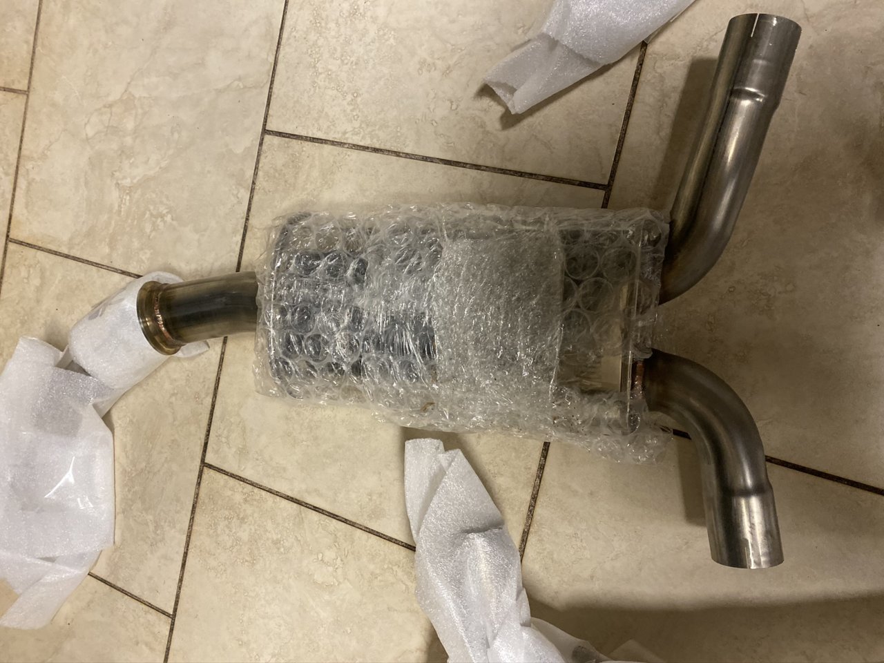

    Maybe you have an opinion; my latest challenging decision regards exhaust. It must be 304 SS, so URD seems to be the option, but there are two ways to go there. They offer a direct replacement Y-Pipe to 3", and a separate cat-back in 3" to complete a set. Or for similar money, they offer the Spec-U complete system, which has a nice write-up of equal length pipes to the Y, and crosses over behind the T-case instead of under it, and they say the equal length has a great sound (European Exotic), but here the Y and tailpipe are 2-3/4" not 3". I have aspirations for 400hp, and research indicates 3-1/2" preferred. Not sure which one to buy? Hesitate to make my own exhaust, at this point, but maybe down the road. Happy to hear opinions on this.

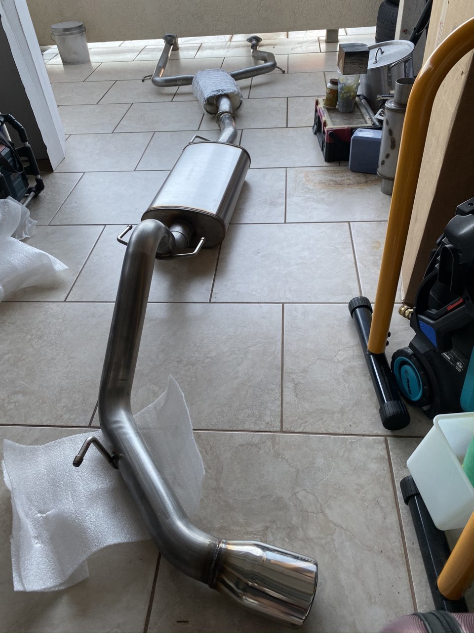

    You can make a ton of power with 3” exhaust. Supra’s and other vehicles use 3” that make way more than your power goal.
    I have the Urd spec-U on my truck but modified. Went this route because it’s something bolt on and wanted something I could revert back to stock. Also the spec-u has an extra bung so you could put an o2 for AFR gauge.
    I’ll try to get photos of it. It has a resonator built in at the Y.

    here’s photos of the Urd spec u out of the box.
    I replaced the muffler it came with with a black widow muffler. I bought 3” exhaust tubing and basically used exhaust clamps to join them to make up the difference in length.
