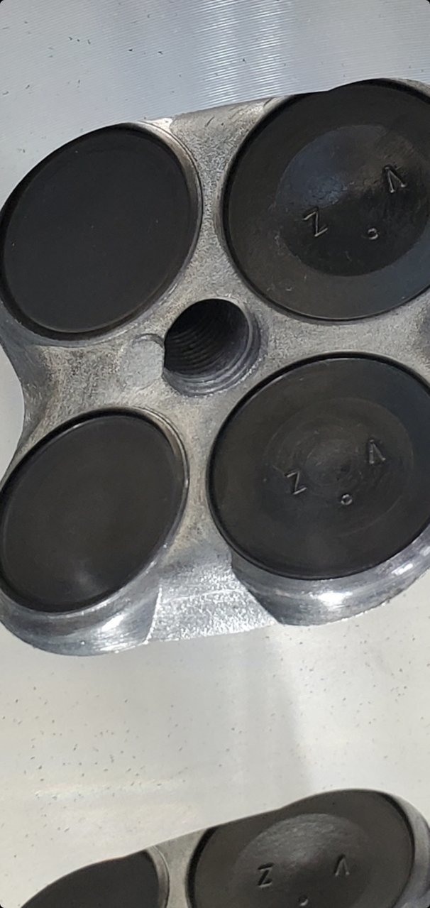

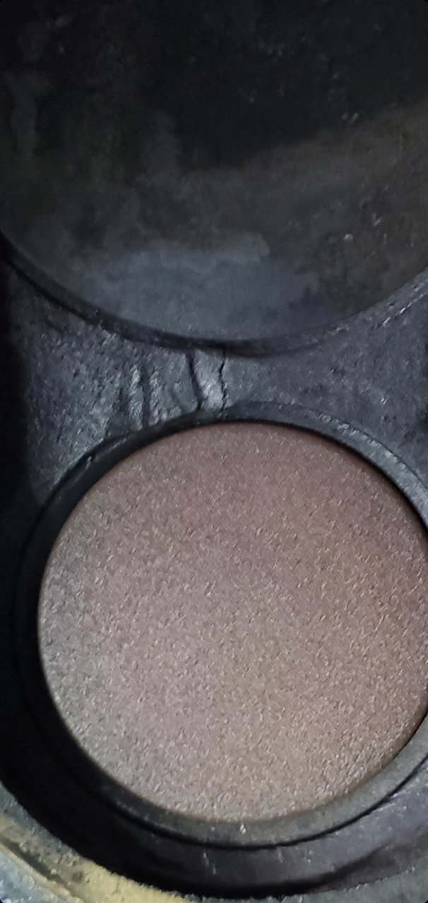

    I'm really starting to think something went through #3 the more I look at the pics. Head looks like something was bounced around in there, piston looked fine. Definitely can see a crack in between intake and exhaust in the pic.
    I guess this confirms my issue on start up followed by compression and leak down numbers for those cylinders.
    Now if something possibly went through #3 and almost #1, how is the turbine?

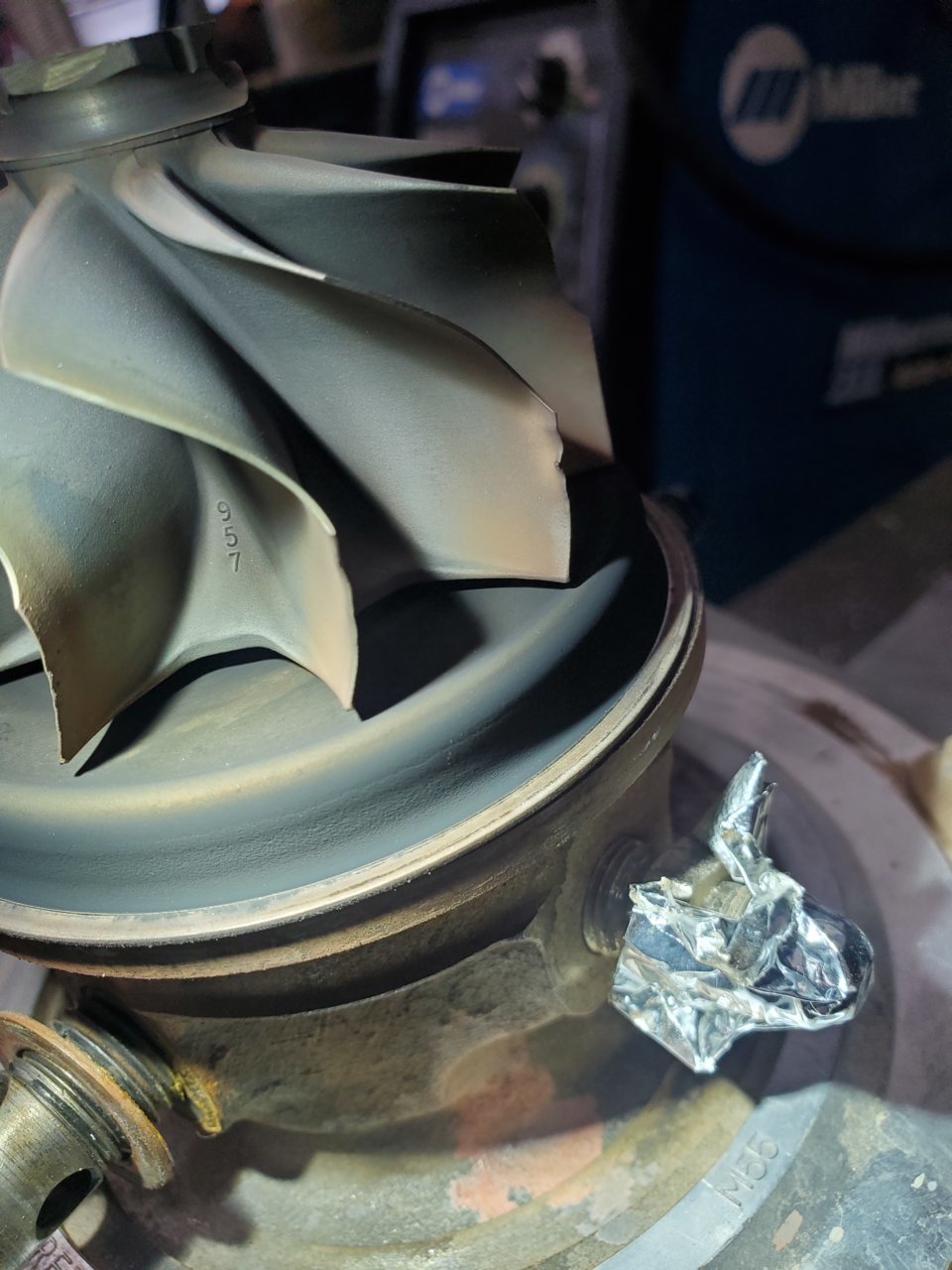

    Pulled the housing today, something definitely went through there. Pretty minor though, I think I'll just send it out to check the balance and see if they can work any magic.

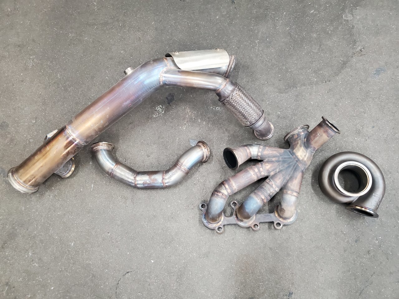

    On a positive note, I took the hot parts over to get ceramic coated. Will see how they look sometime next week.20210830_130006.jpg 20210830_112530.jpg

    You sir, were very lucky!

    I'm baffled. If the cylinder head is recessed 3/16" and the piston is dished about the same, that's alot of space to fill for a bolt/ect. It's weird because there were no marks on the piston and the damage to the turbine is relatively small. I dont know what beat up the cylinder head. @Torspd

    Ever pull that piece out of the intake valve?

    No, just poked it with my fingernail before putting the head in a box out of the way. Definitely soft, like old grey rtv, which I haven't used on this truck, especially on the intake system.

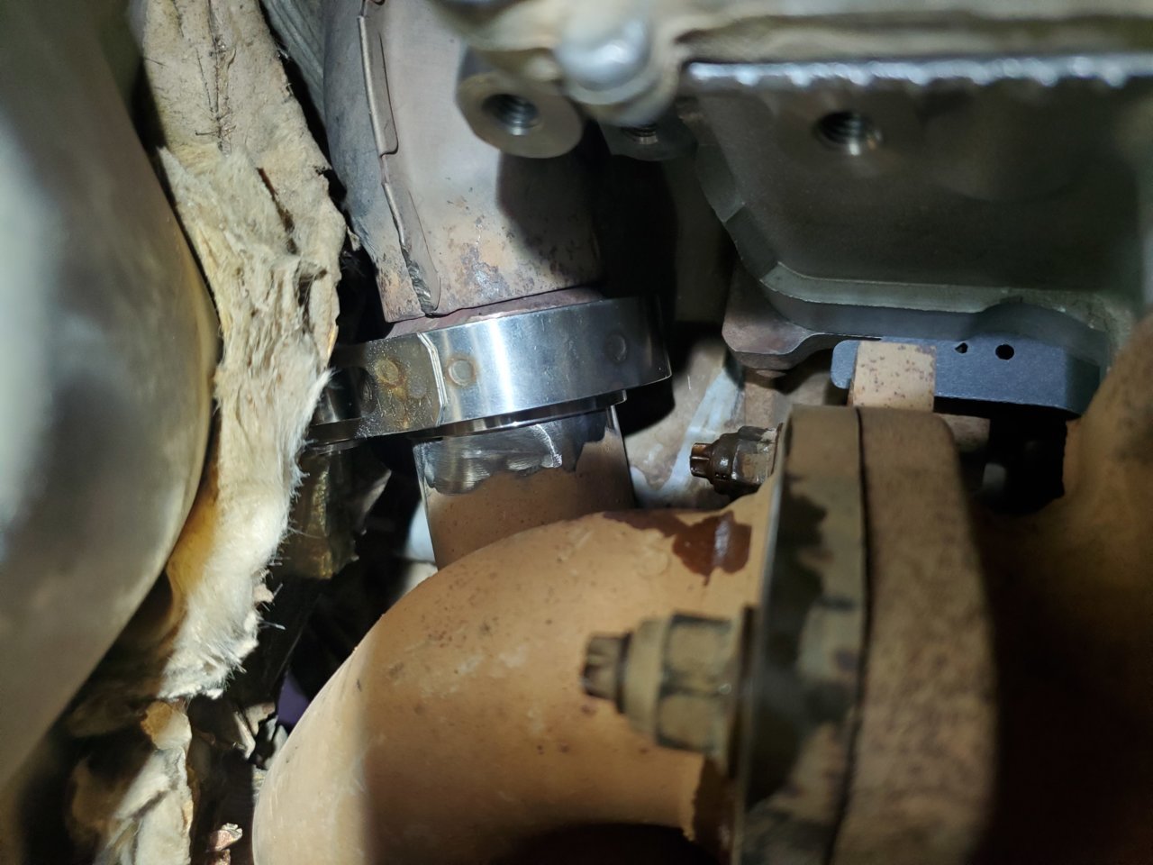

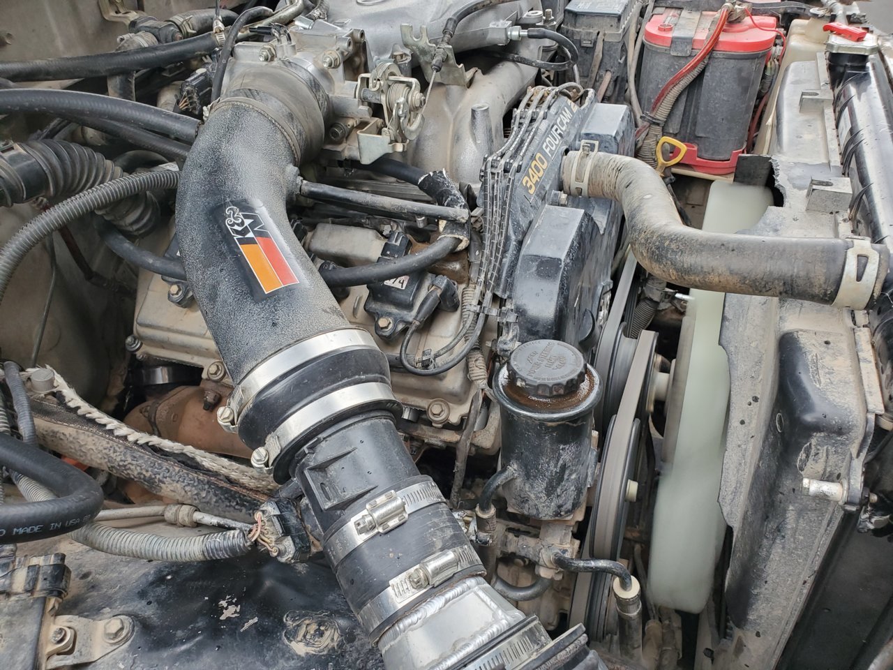

    Got lucky I still had the Cai and adapter to 3.5" air filter. Also super lucky where I cut the stock exhaust Y pipe, literally just cleaned it up and the V band fit the cross over pipe.
    Started right up. But now there is something wrong with the gas pedal. Truck barely moves. It drives fine but damn is it a dog!

    That is mysterious then.
    :yay:
    Man. You got really lucky with that fitment. Or.....you planned it that way in the event of a "just-in-case." Regardless, Bravo man!

    Lol I definitely didn't plan that. I needed that though, pretty tight area to work in if it needed tubes fit up, which is what I was planning to actually happen. @Torspd

    Only if they Had routed the exhaust under the transmission.
