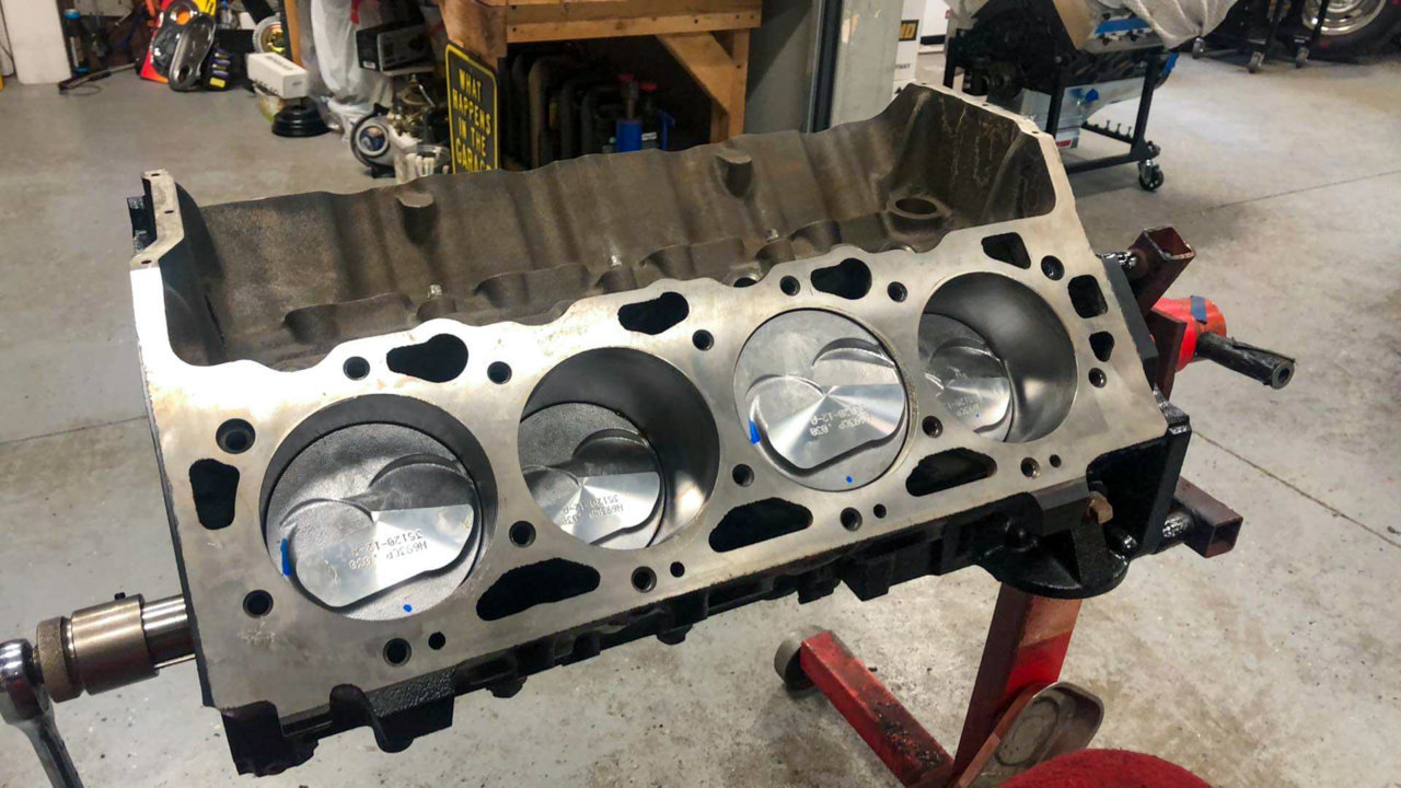

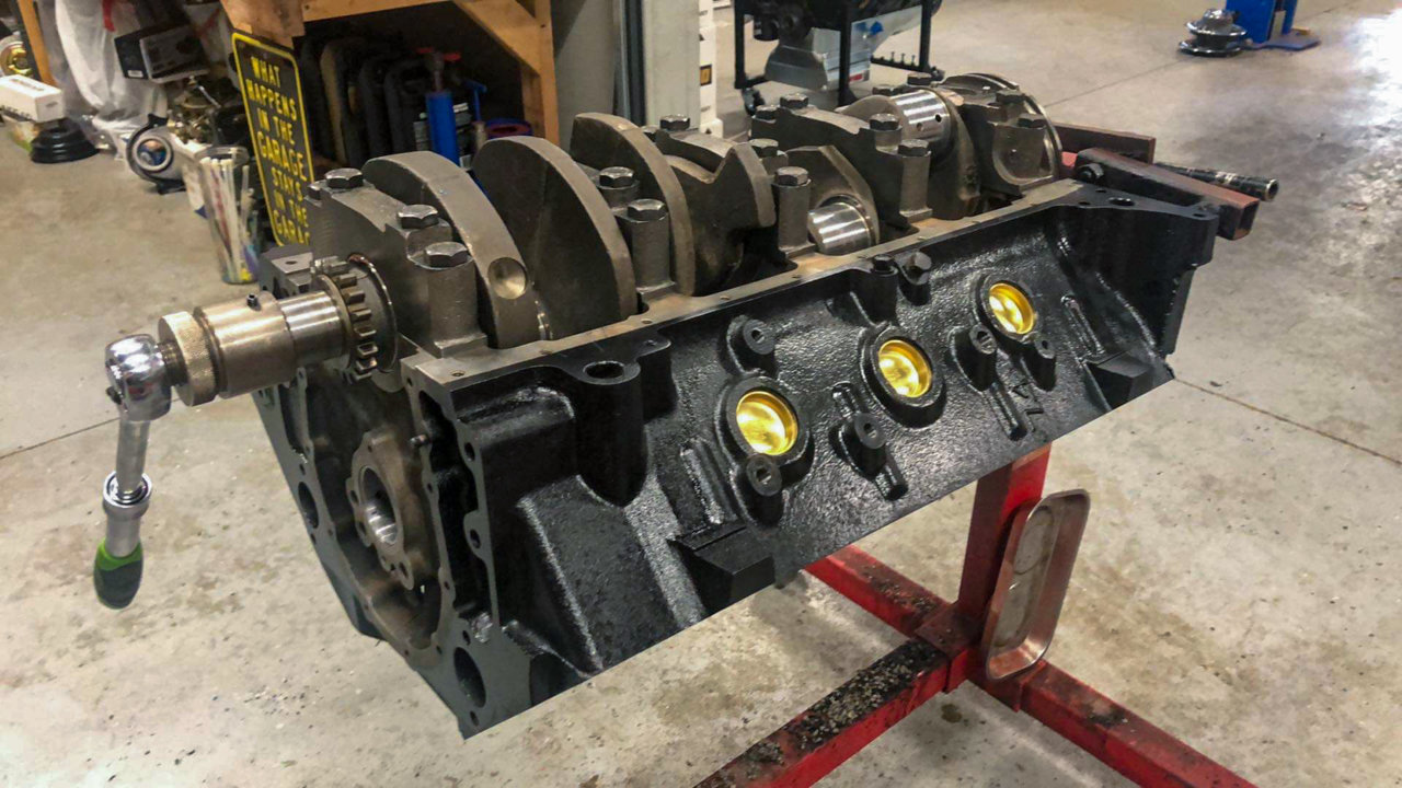

    It's less Tacoma and more mod
    Not quite to the whole putting turbos on part, or the putting the engine in the truck part either... But here's the bottom end of my 454 (now 460) for my C10 drag truck project.

    Completed the valve to piston clearance, already, yeah? I am assuming that is what those blue marks mean.
    Otherwise, that is going to be a monster!

    Oh yeah, I did a quick mockup using a hand crank to open the valve since I didn't wanna size out pushrods yet. Plenty of room even with the generous dome. Should be 9.32:1 compression ratio, so still boostable. Just finished porting a set of heads for it and I've got to finish cleaning them to put em back on.
