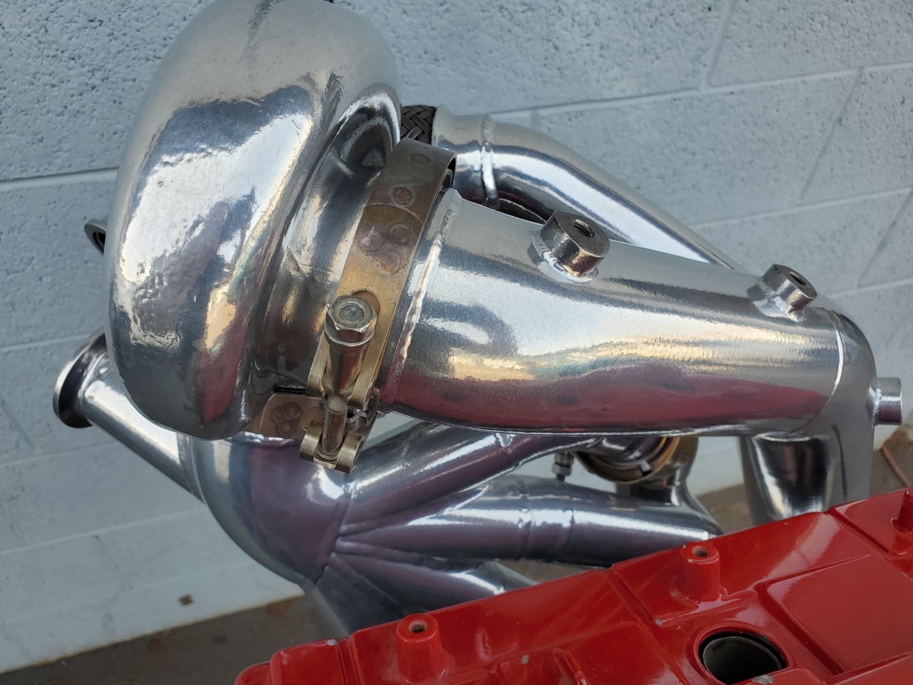

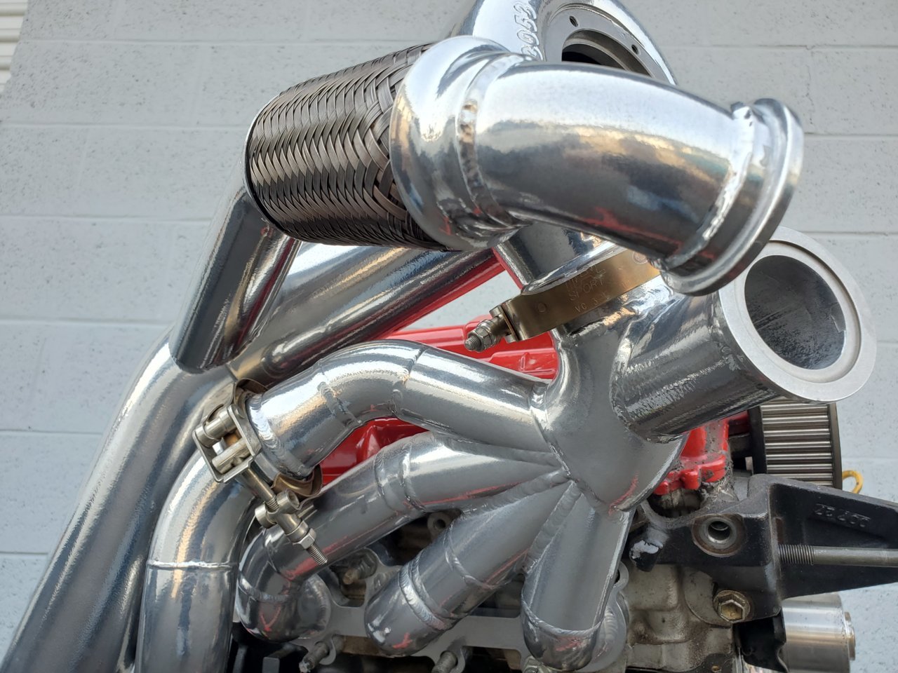

    My hands have the strongest desire to build some 1GR turbo headers. For a single setup.
    @JustDSM , I have been contemplating how to do a twin setup and make the 3 into 1 merge. Just depends on what kind of flange that you would want it to be.

    What flange is on your manifold? T25 or T3?
    Is the turbo flange parallel to the head flange, or at an angle? As in closest edge of say T3 flange to the head flange, being in parallel with each other.
    I cannot remember. Did you get your turbo in yet? If so, what flange is that?
    For @BassAckwards, his is a ~2.5" v-band flange. So that is what is being built first.
    For those with the alibaba manifold, what I don't know is if the mating surface of the turbo flange is perpendicular to the head flange or not, and what I asked dirtdigginjoe.
