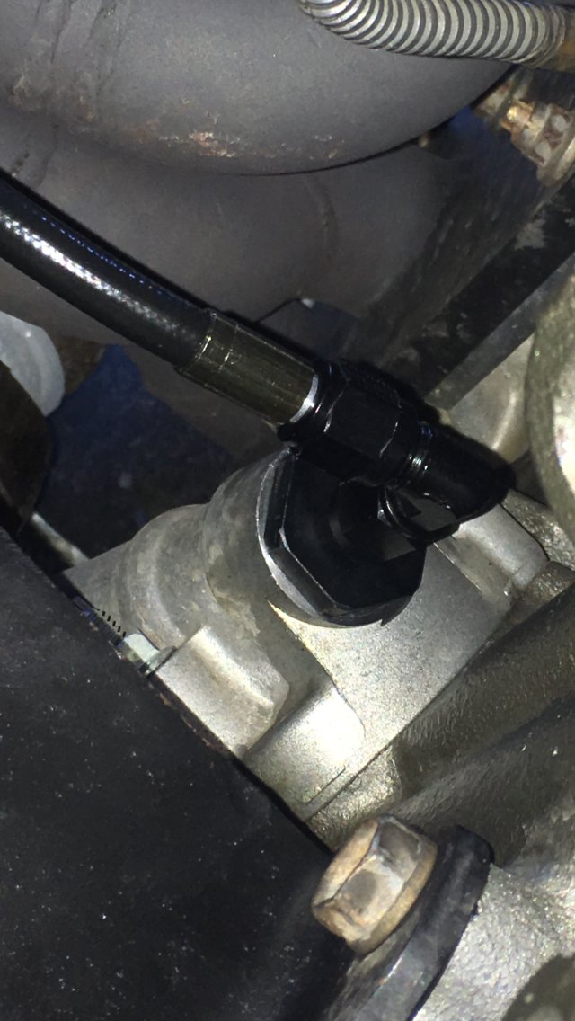

    Do you recall what size fitting this is on the oil filter housing? I think I am going to try to set up my oil feed the same way

    Not 100% but I think it is M16x1.5

    I can’t sorry, but some reason m22 is coming to mind idk

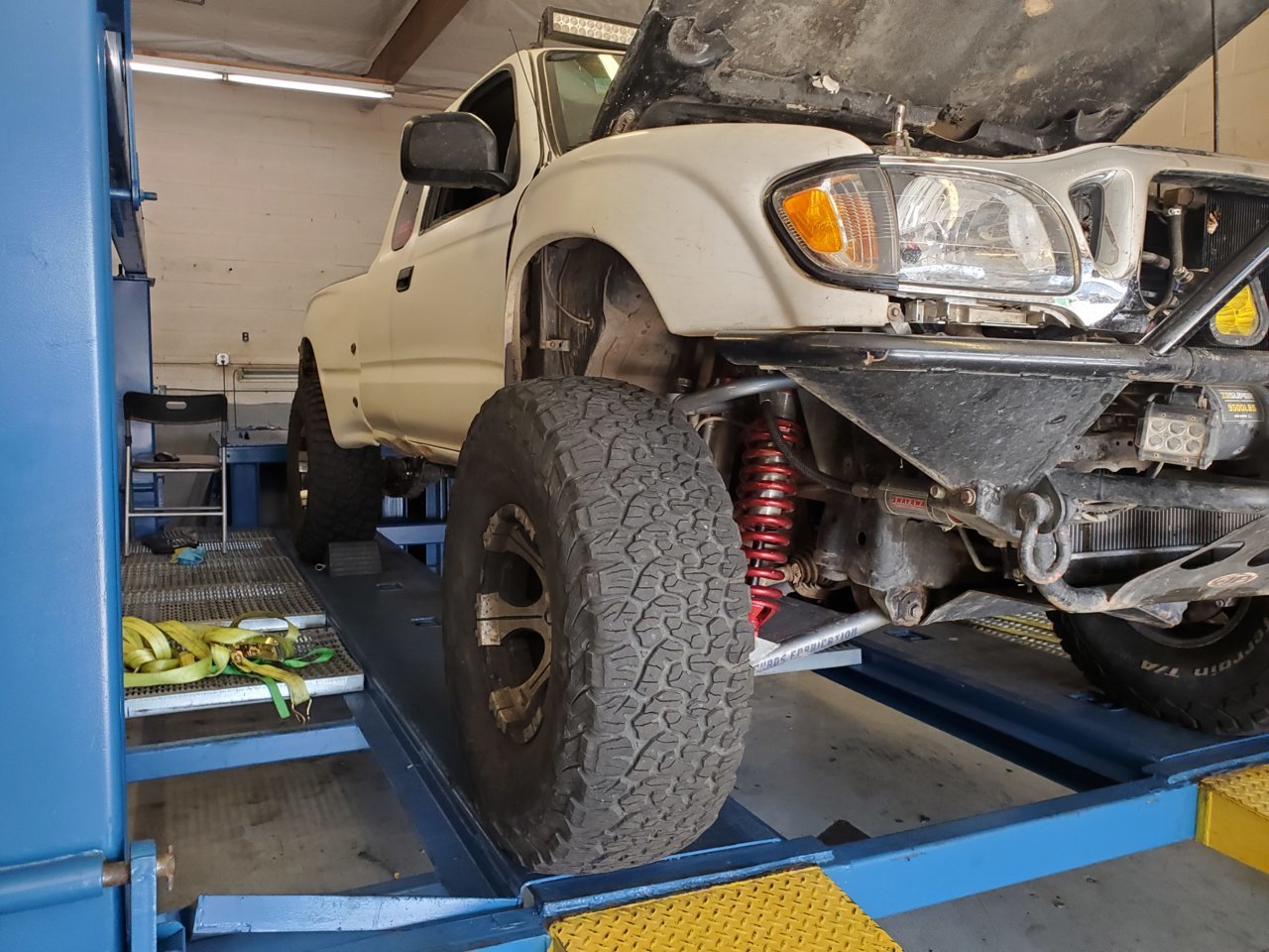

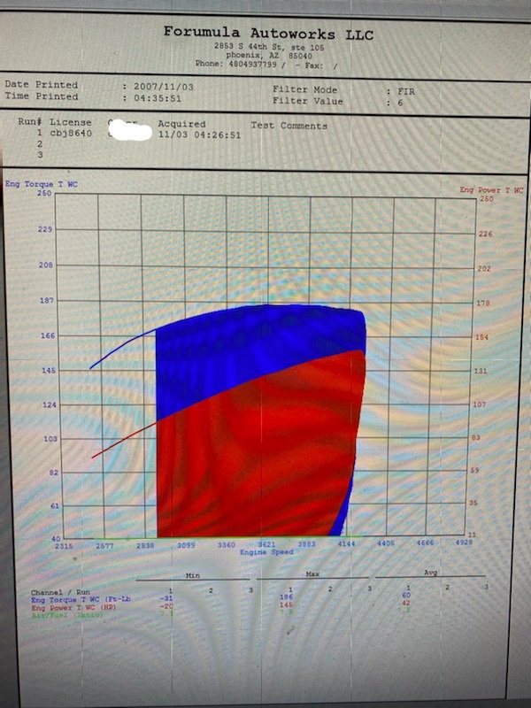

    The saga continues...
    Base line dyno with the truck in Na mode.
    Stock 3.4
    Auto
    35s
    4.56 gearing (from 4.10)
    K&n intake w/Afe dry flow filter
    2.5" exhaust from cat back to axle exit
    32" led light bar
    Had to let out of it because the Auto slipped or flashed. Thought it was down shifting at first, its not.
    Kinda bummed but also glad I didn't get stuck out in the middle of nowhere with a neutral box.
    I guess two years of boost finally took its toll. Crazy I didn't have any problems before, but I never rev the engine out that high, just use the bottom end to move around.
    Already looking into rebuild kits, but if anyone has a good known lead, shoot me a link.
    Until next time, happy boosting!

    Are there upgraded clutch pack kits, and/or valve body kits?

    Only looked for a second but yes there are upgrade clutches, I still need to do more research though. I actually have a valve body kit on the shelf, just didn't use it since the line pressure mod seemed to work so well. It will definitely be going in this time.

    Well, you have all the imperical data and knowledge you need now, to share with others.

    Ive seen some companies that rebuild A340 for drag when I google. Maybe some of the parts work with yours.
    I'm only familiar with desert stuff. All of them use the th400 and a high stall converter with lock out.

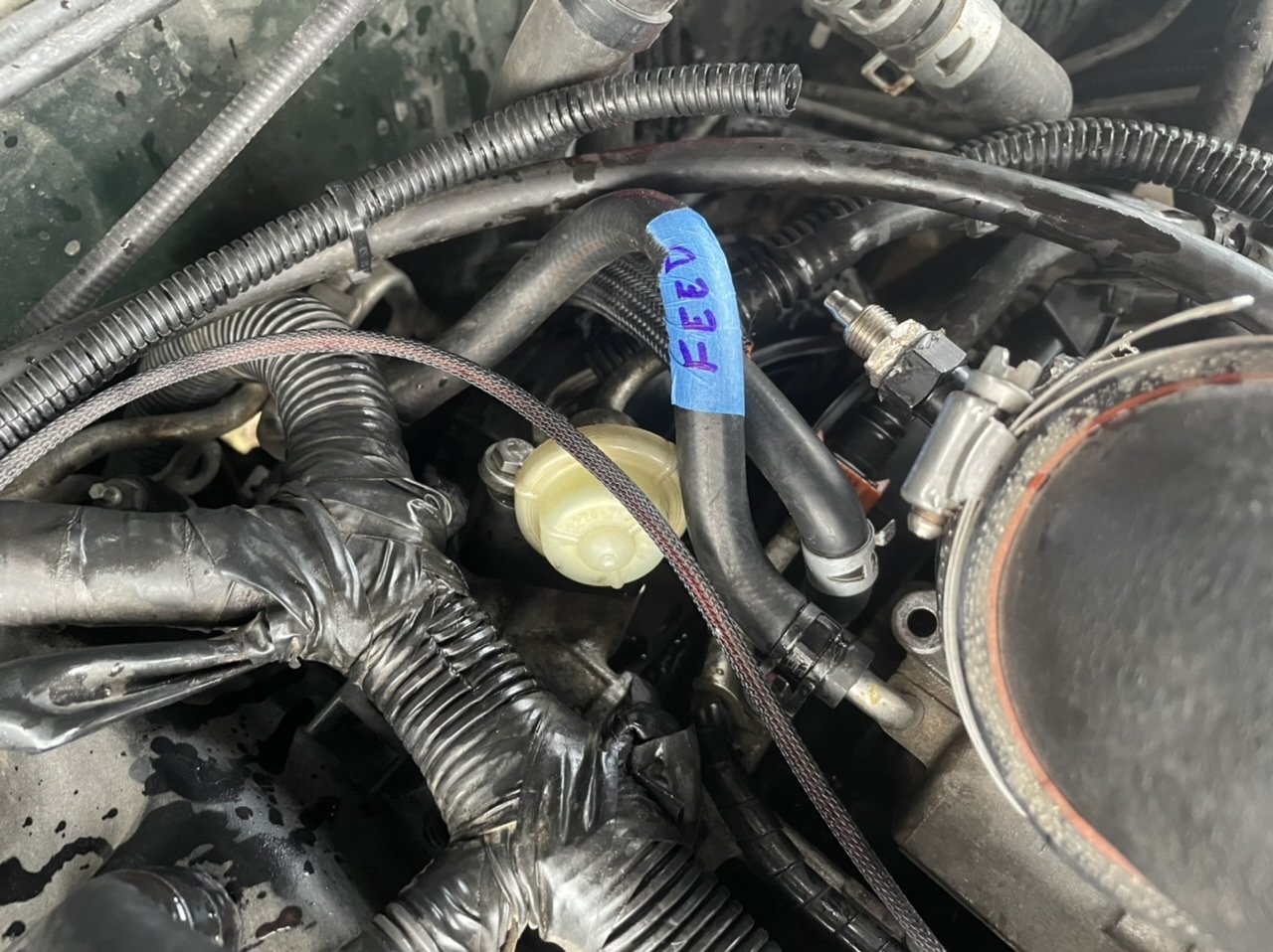

    Did some research today on the throttle body inlet and outlet for my coolant source for the turbo. I got the truck up to temp and pulled a line to determine which one of the two on the throttle body was the feed and which was the return. Here’s a pic for future reference. The one going into the top of the TB is the feed and the one coming out of the bottom is the return. This is on the 2TR-FE.

    That's how I did mine.
    Yeah for the a340 you can do a transgo kit which I found I needed when I had the turbo as I could start to feel alittle slippage. I did the hot rod setting which I would advise against lol. There's also kevlar clutches and more upgrades when you need them atf speed is a big a340 company.
