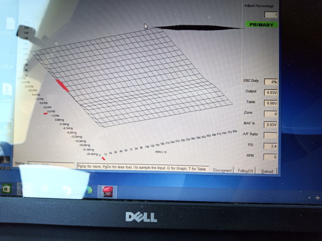

    Hey so I just noticed with my truck off, I'm making 2.4 psi according to mapecu3... Any remedy for this?

    Where does the tracker move to when you turn it on?

    Like -15 inhg ish

    That's too far off. Unless you have a vacuum leak, it should be around 21 inHg.

    But when the truck isn't running it obviously isn't effected by a vacuum leak... I just feel bad it has taken me like 4 years to realize this but to be fair, I don't usually have it hooked up with the truck off

    Are you using the map sensor built into the MapECU or an external sensor? Did the sensor cal selection accidentally get changed?
