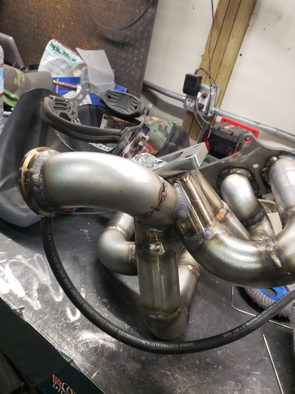

    But it is done. As long as the welds hold, it doesn't really matter. Not long now before you can install it. Is yours T3 or T25?

    Yeah i put quite a few beads on each joint, so she should hold up. I back purged it as well. It is a t3 flange mount.

    I did the same on the manifold that I made for the Desert PreRunner. Double passes on most everything. Lots of rod. Pretty sure I used 1/8 filler. What size did you use?
    Got some flanges on the way. T3 and T4. Then need to drill out the jig plates for the flanges. Simultaneously, I have been working on cutting the tubes for the merge, for @BassAckwards 's.
    Going to be making one for him and one for my neighbor, before making those for the rest of the guys on here that are interested.

    I used 1/16th rod for the first passes, i tried 3/32 at first but it kept cooling the weld pool down too fast at the amperage i was running. Second hot passes i used 3/32 bumped up the amperage too.
    To the flanges i turned her up real hot and only had 3/32 309l but she worked good.
    I bought pre cut/welded merges from i think cr racing. They were ok, poor penetration and schedule 10 but ace race parts were out of merges.
