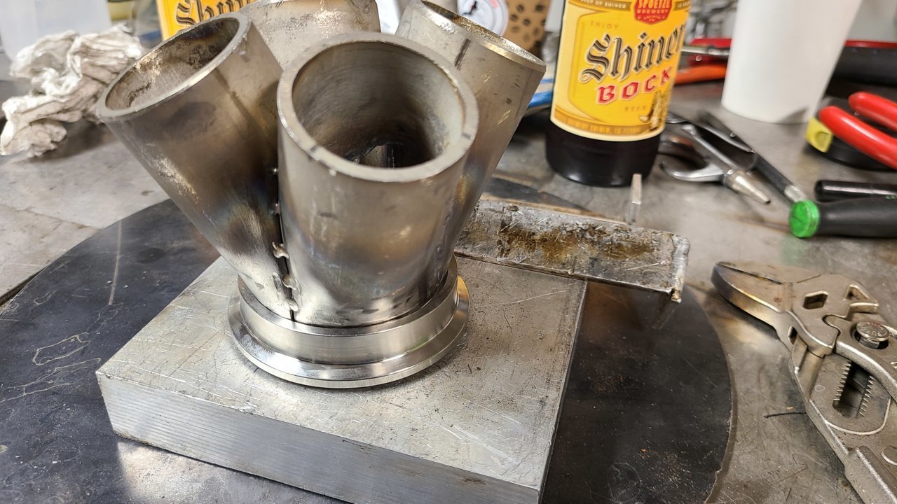

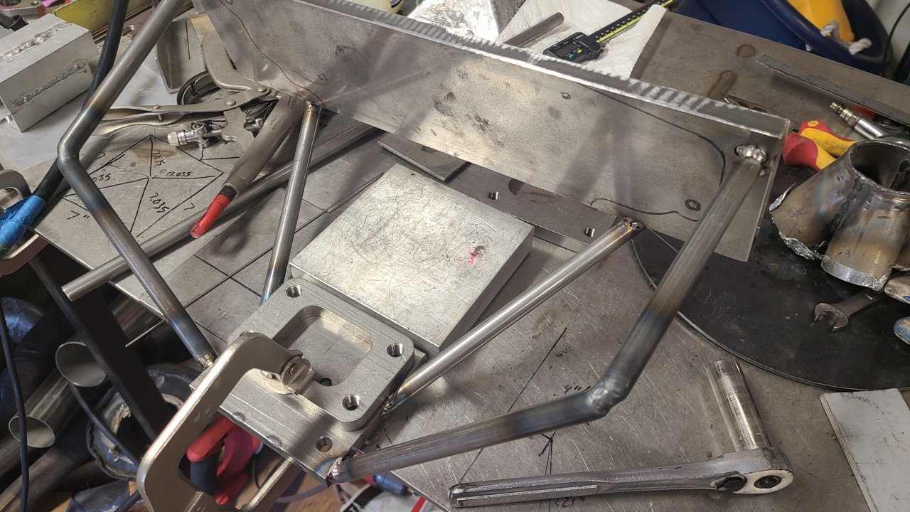

    Latest updates on my own, from the progress for some 2TR headers. One merge, for @BassAckwards, has been made and fully welded. Also, the Jig for T3 and T4 is nearing completion.
    A lot of material is coming in for my neighbor's header build. I'll use his truck to make sure my jig is accurate, based off of the Chinese manifold.
    To note.* I had a challenging time even tack welding the top jig plate to the T25 flange. This is after sanding and cleaning it. They really use some poor quality material. It was splattering and popping from the impurities. Similar to rust and other whoknowswhats.....

    Effectively, I'll be making two at the same time. My neighbor's will be slightly different in that his will be planned for twin scroll, where as the other will be modeled after the look of the Chinese one.

    Good luck my friend. Those jigs really help out. I like the top two braces that are bent. I tacked all mine up and then welded all the seams except to the collector and the flange to minimize warping and distortion.

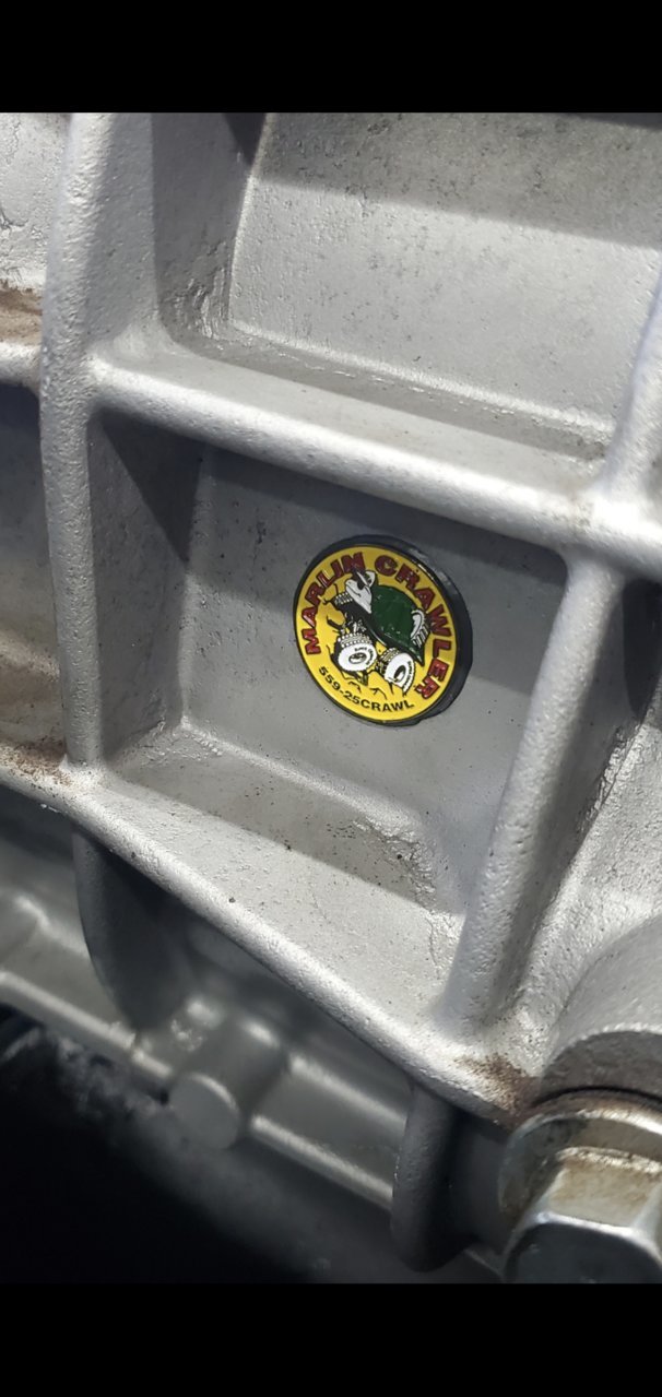

  13. Nov 15, 2021 at 7:15 PM

    Turtle power.

    Am i not turtle enough for your turtle club. Marlin makes some good products, i put theyre 4.70 gears in my crawl box

    Sounds like you were in the Turtle club before me. @Bloodytaco208
