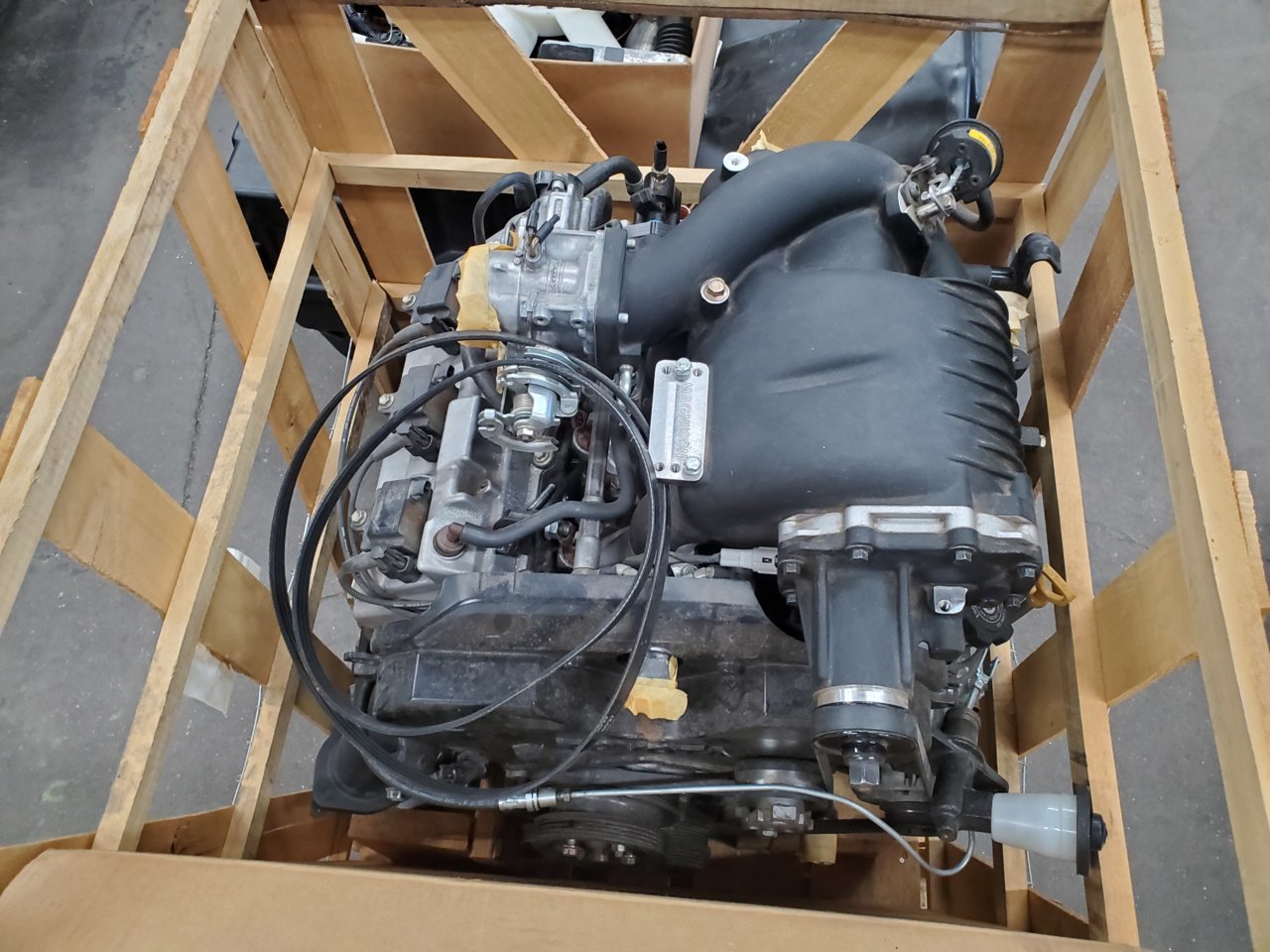

    Stock. Doesn't need them, it's just a back up engine at this point. My current engine has been up to 13 psi twin charged with non metal gaskets and stock head bolts. Timing is everything, or atleast a major part of it.

    Thats a bunch of spare parts which is great. If you get the chance i would put a drift brake in. I need to.

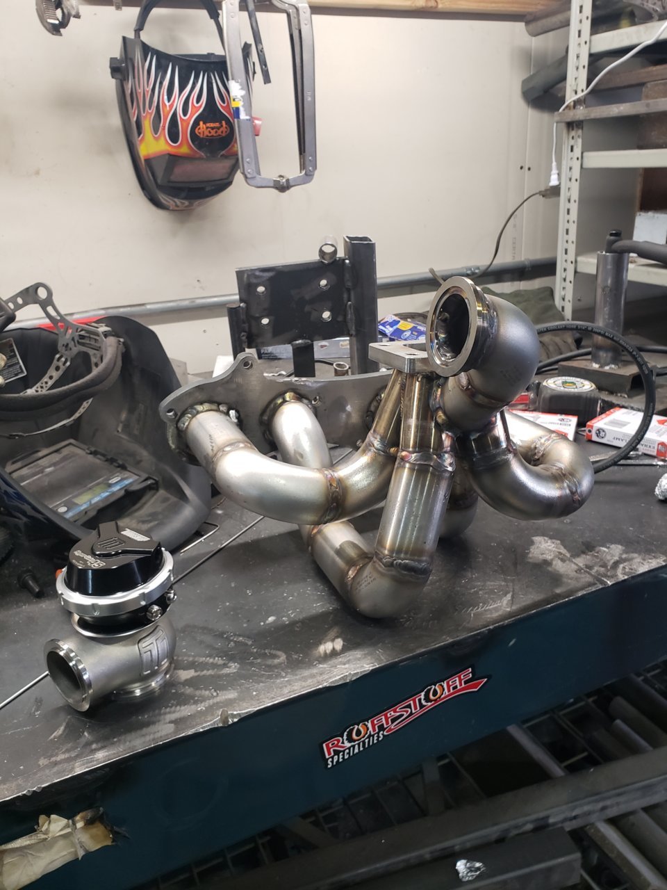

    Finally finished the manifold. Time to deck it, and then barking wheelies

    I like it! Ready to see it installed. Nice wastegate too.

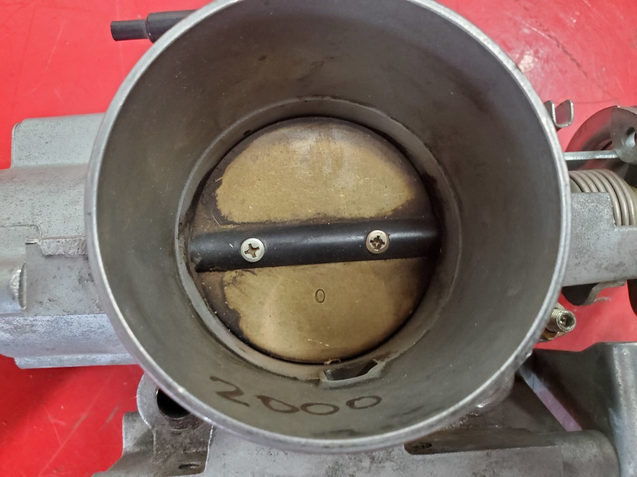

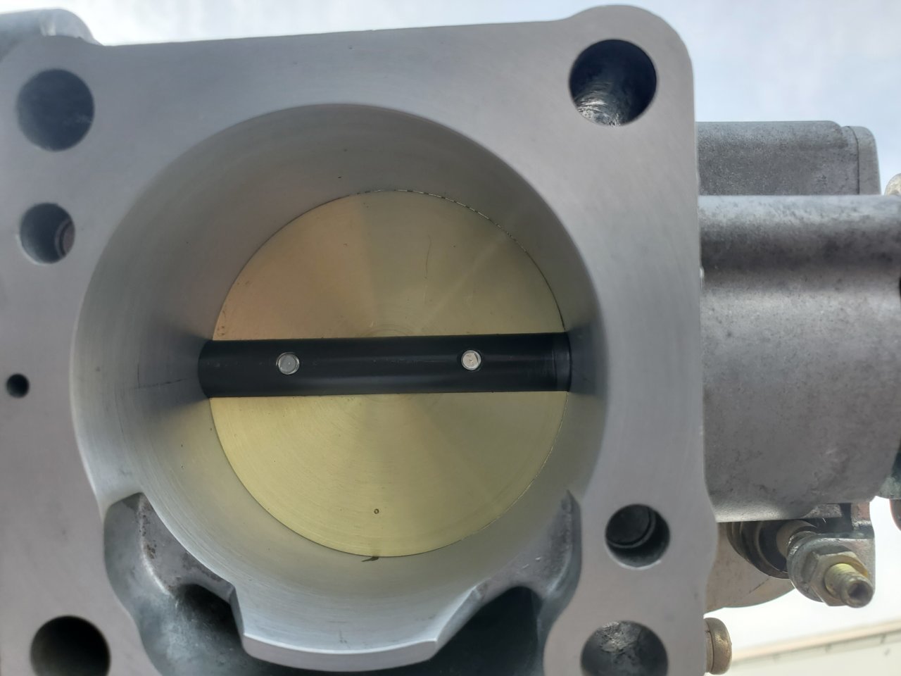

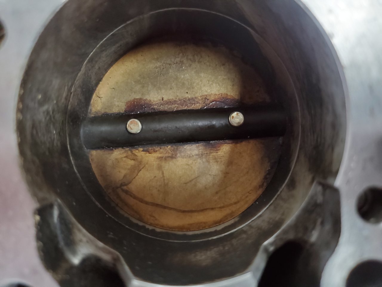

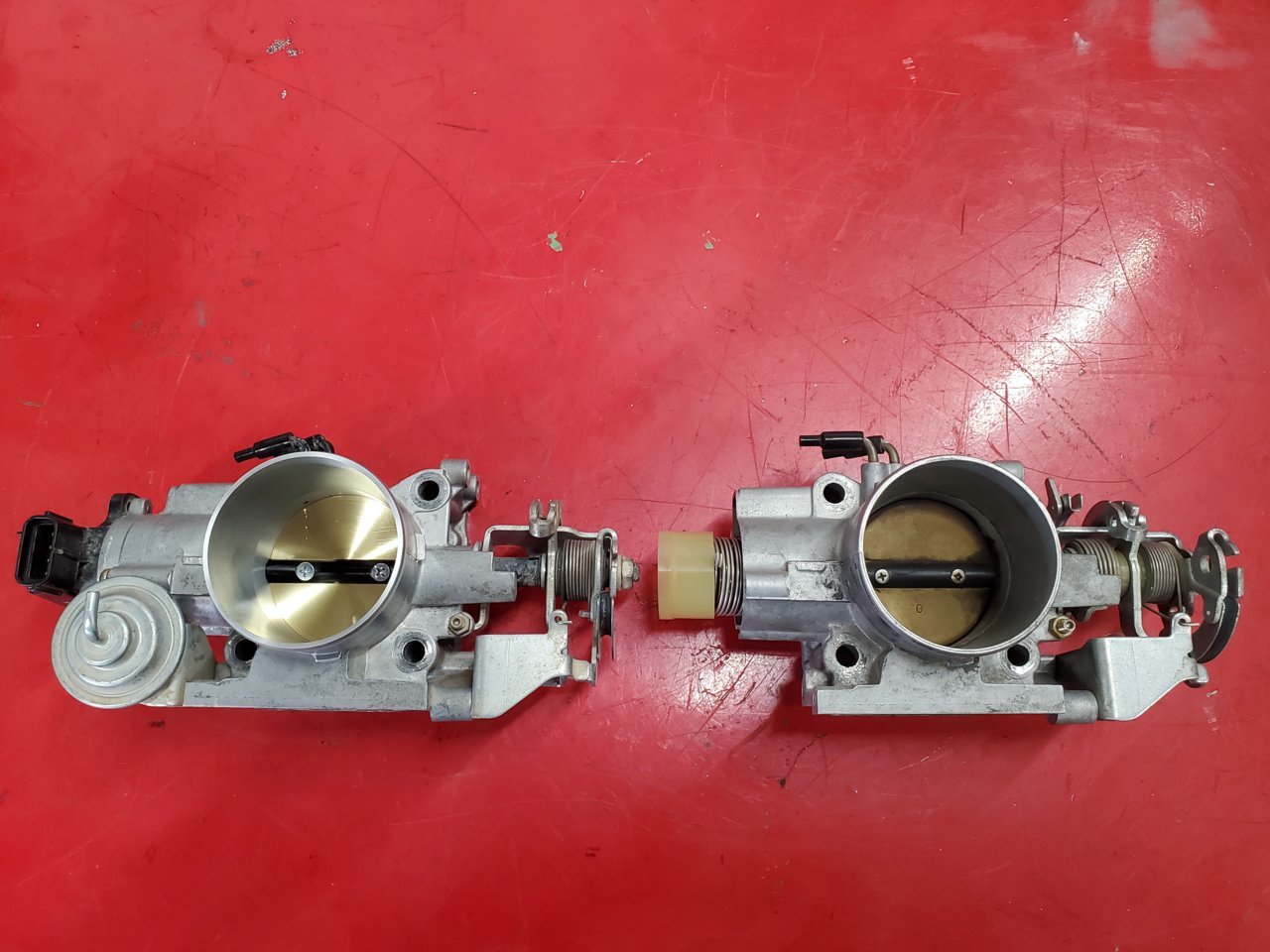

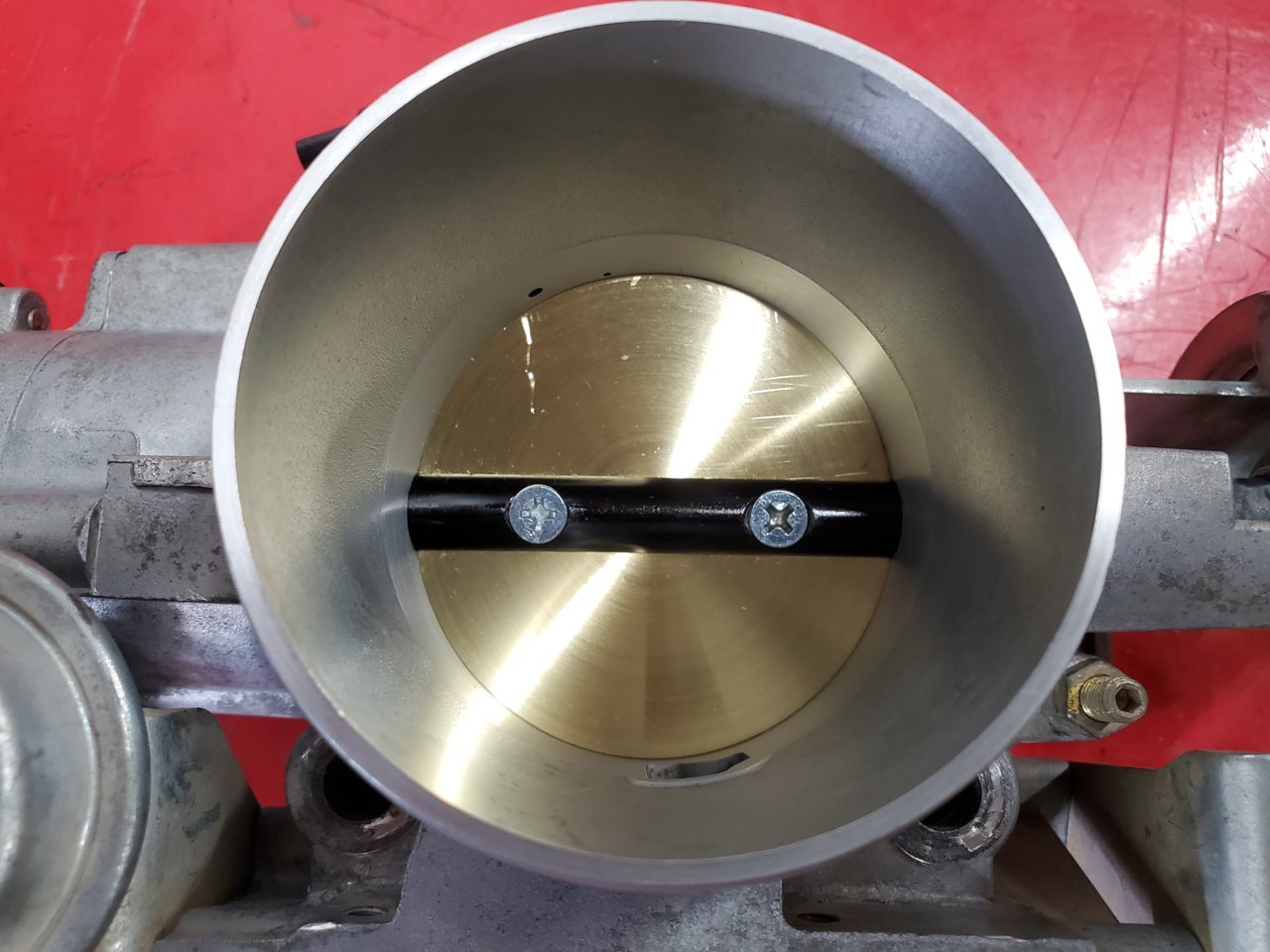

    Inching closer. My throttle body returned from Maxbore.com today! Super happy with the work and now I don't have a high idle.
    For those with a 3.4, the butterfly wears into the throttle bore over time and creates a leak. This is because there is no thrust bushing on the throttle shaft.
    Maxbore opens up the bore a bit and machines a new butterfly valve to fit. Perfect seal. They also put a washer on the shaft to prevent walk. Additionally they recalibrate the Tps sensor to spec. Finally return shipping is included in the price. This ends up being $10 more than a used junk yard throttle body after shipping. Sooo worth it!
    I thought I took a pic of the before gap (it was bad) but I guess not (Found it and added). Here is another old one I have and the reworked one side by side.

    Wow. Never seen one worn out like that.

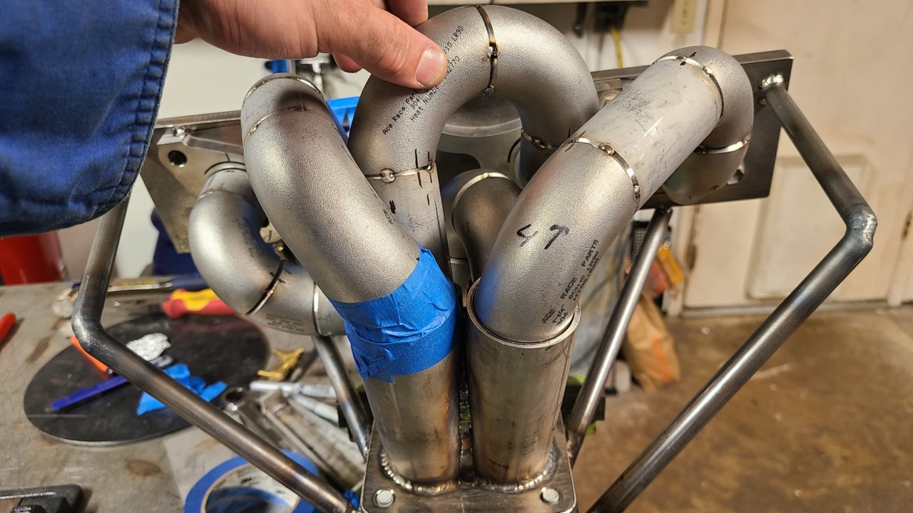

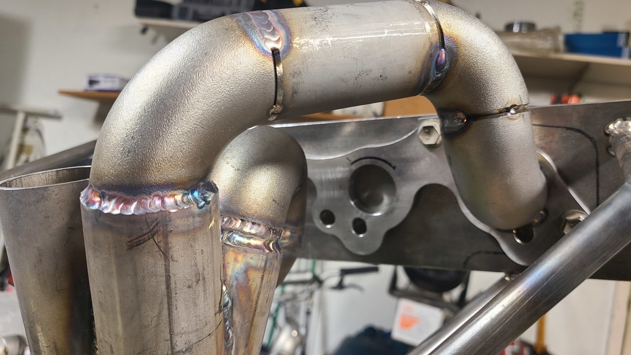

    Here is the latest. The twin scroll setup for a T4 flange.

    That painter's tape rated for 1000°?

    Looks good, lot tighter then mine. Is that 1.25 pipe?

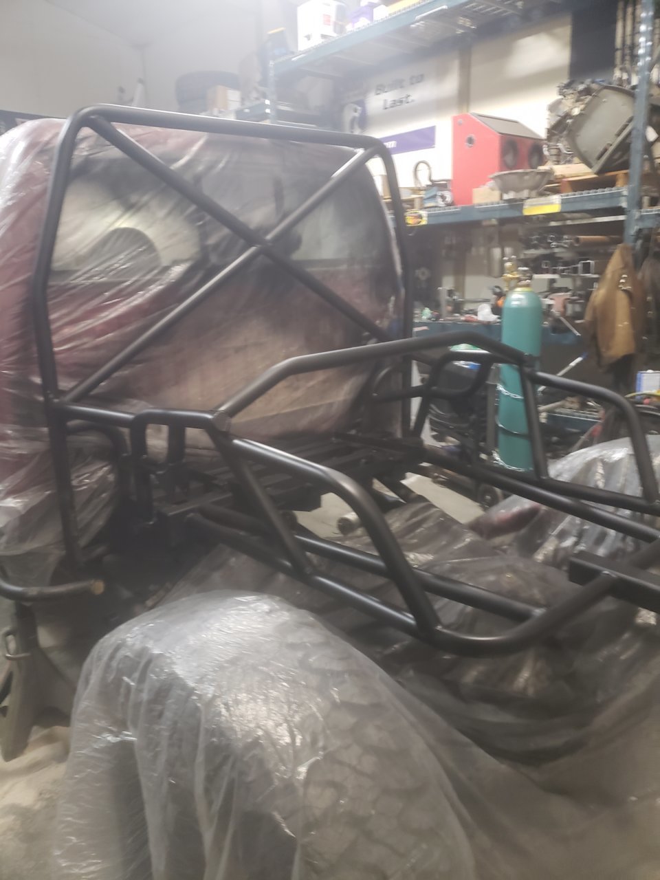

    Finally got it all wrapped. Fucker barks a wheelie now. Now the speedometer dont work. If i didnt have bad luck i wouldnt have any luck. Got the rear chassis painted. Probably shouldve opened a door, but its colder then a coal miners ass out there. Plus i cant smell anything cause of the wuhan wheezer.

    Thank you! You are correct. That was the closest to the OEM primaries. From the header that @BassAckwards sent to me.
    That turned out very nice! Got a coal miner's black nose too, I imagine. Lol. Sending some positive vibes that you heal up well! :pray:

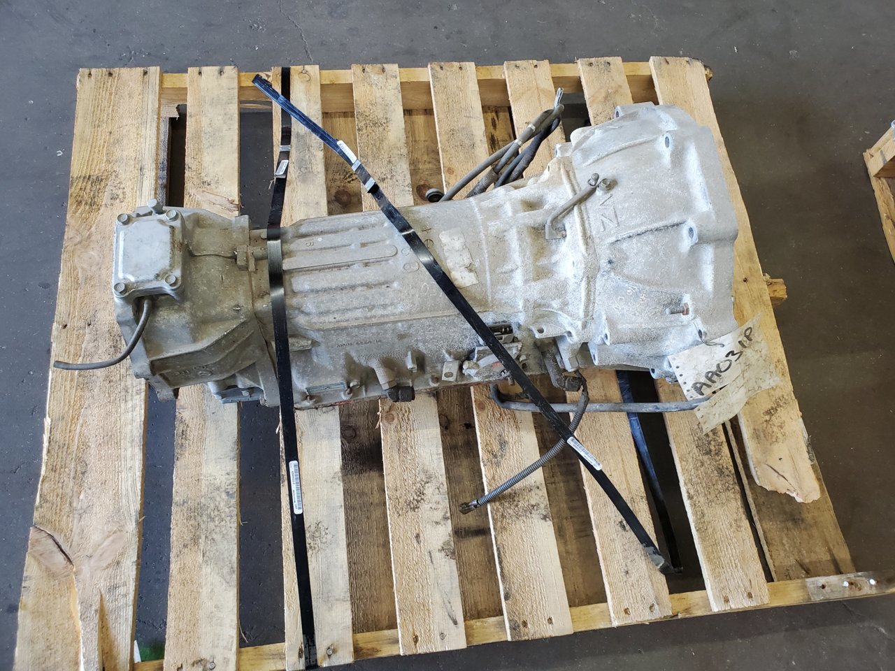

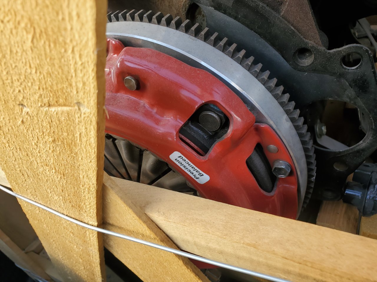

    Starting 5 speed swap right meow.

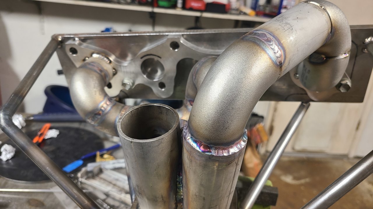

    Made some progress in the short time I have had.

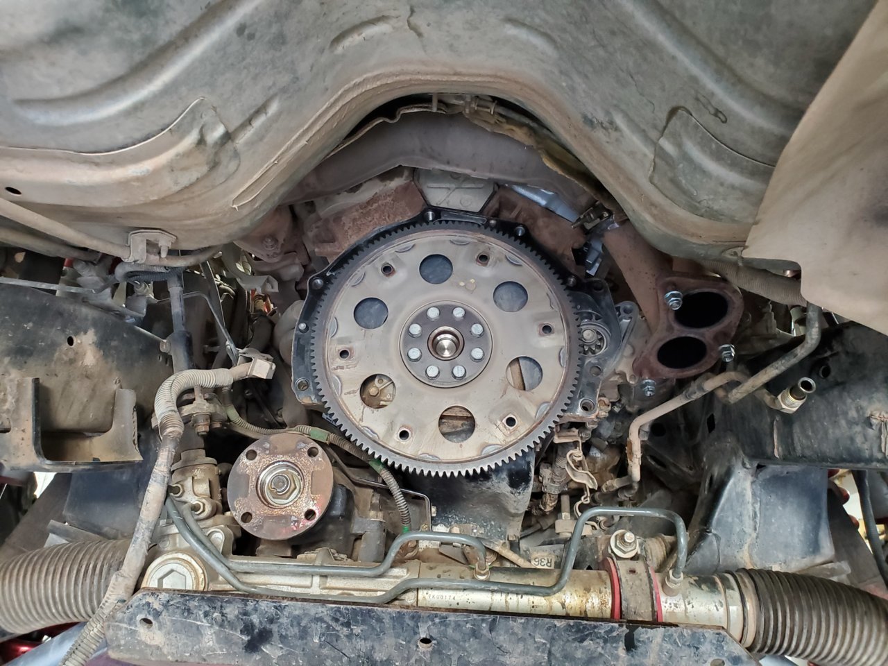

    It's out.

    That went quickly. Do you have to change the ECU?

    that looks like pretty heavy gauge tubing (pipe?) for an exhaust manifold.
