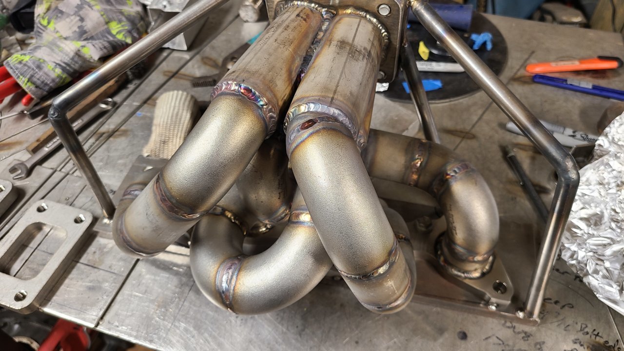

    It's less Tacoma and more mod
    sched 40 stainless is pretty common for manifolds

    I guess I’m used to seeing the Gucci Ti stuff on the gram. Probably way overkill for our trucks. What is that stuff? 11ga? Looks like it makes for a nice little groove weld.:welder:

    It certainly does, with those beveled edges.
    This is schedule 10 stainless pipe. For this one, since his is going to stay low boost. It is 304 stainless. The one for @BassAckwards is 321 stainless pipe.

    Any particular reason for the merge collector pipes being bigger than the other pipes? Just what was on-hand when building the collector?

    You are correct. All that was available which had a divider in it already, for a twin scroll application. To save time as well. And since they slip into each other, quite precisely, it works out very well.

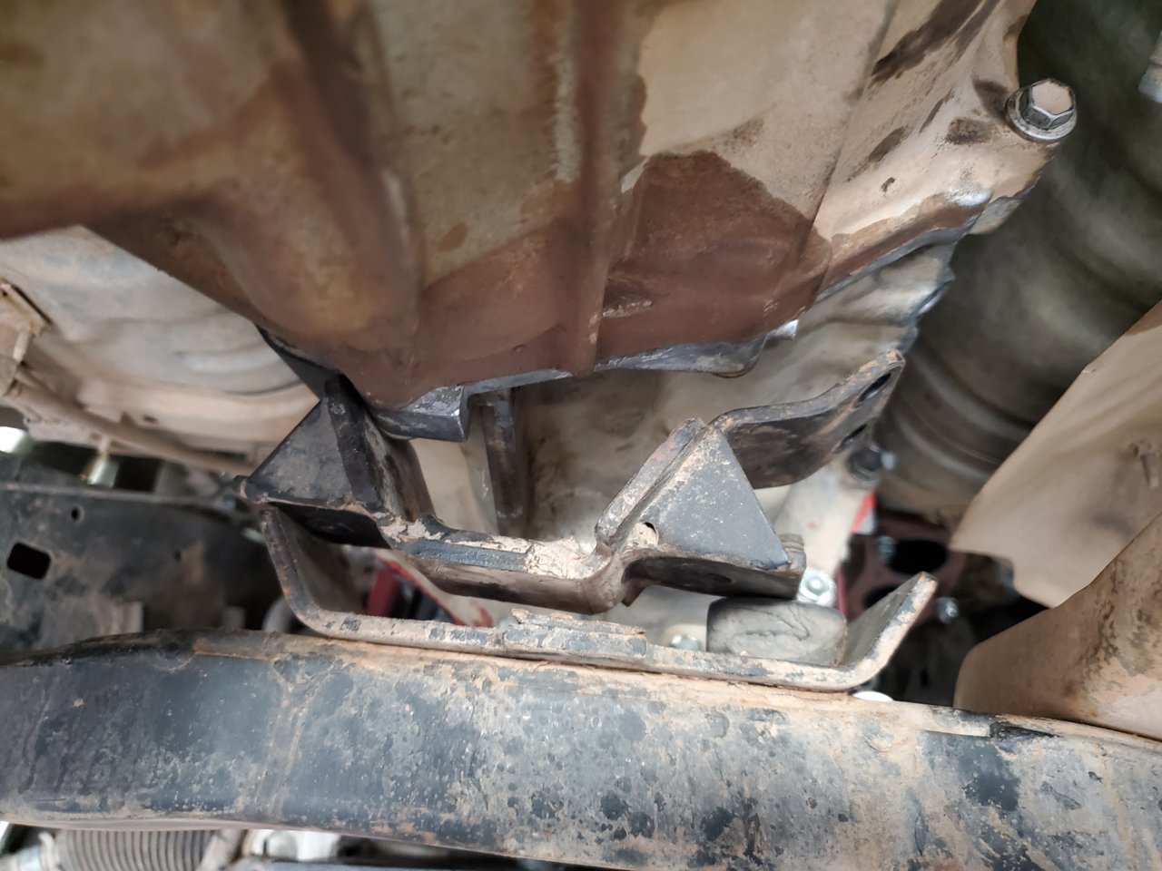

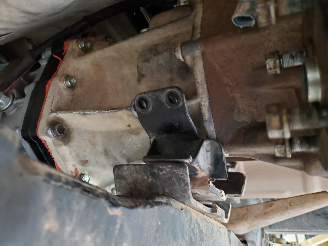

    5 speed is in! Now to fab the mount.

    Just drove it! Wooooooo!
