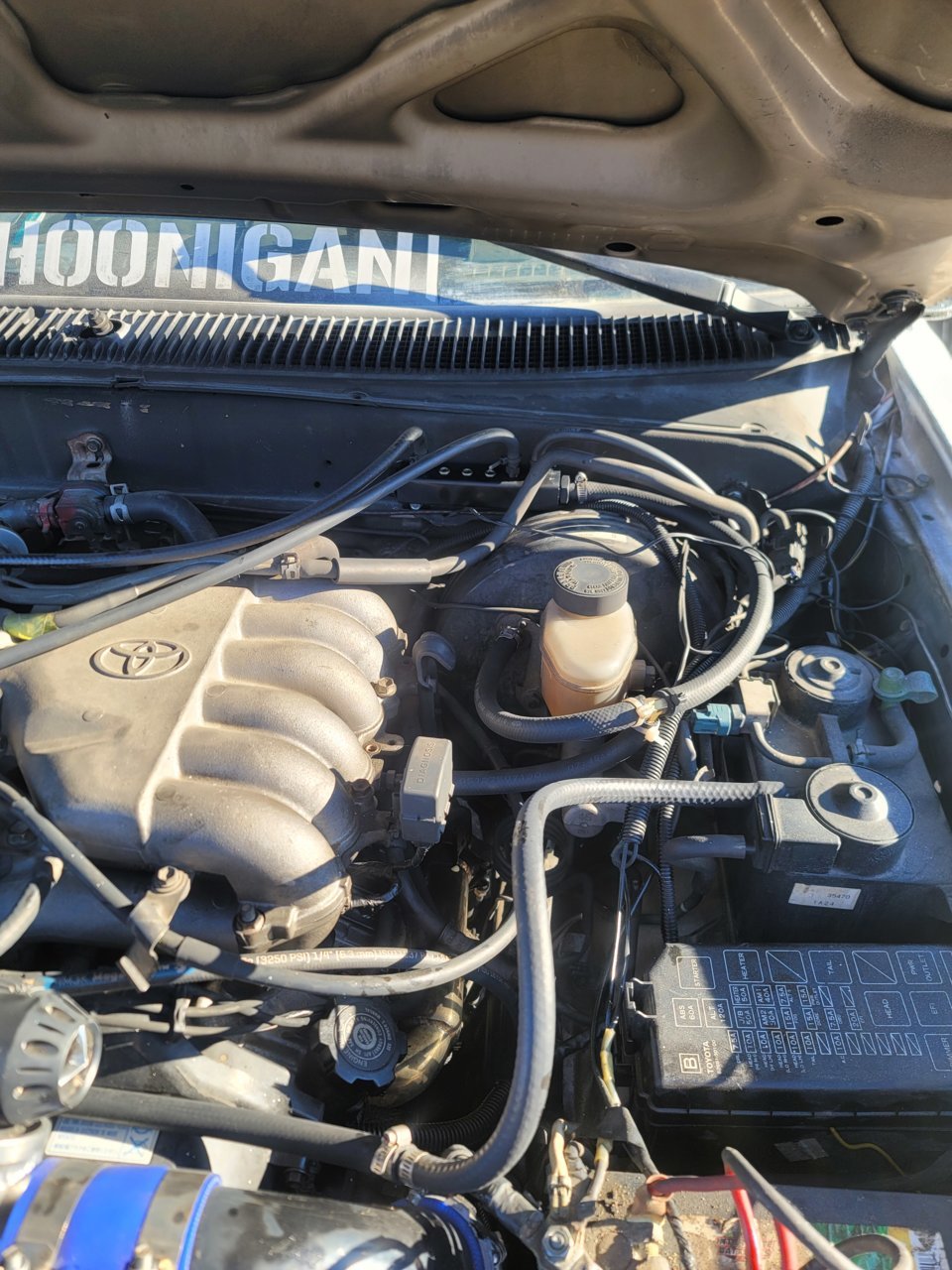

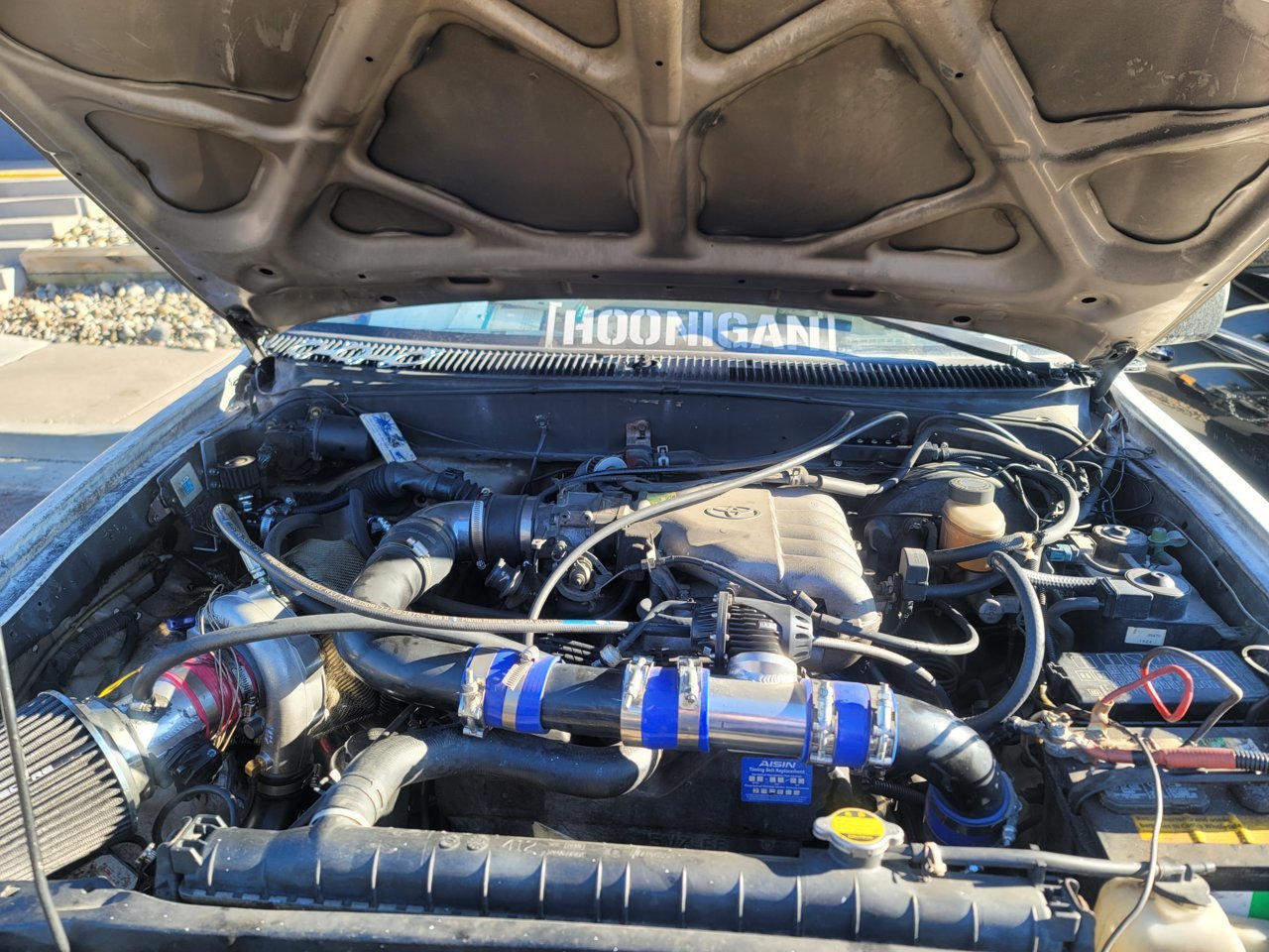

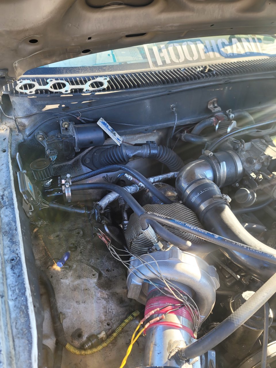

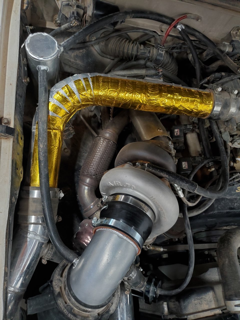

    There were requests to see my current setup. Please speak up if you see something that needs attention

    I have a strong feeling that the PCV line, right on that MAF sensor, is creating some turbulence. Or even oiling of the MAF. I'd be surprised if it wasn't.

    The boost reference for the wastegate should be right off the compressor housing. I can see you have a line there but can't see where it goes. Also this line should be going to the bottom port on a external wastegate. The top should be open to atmosphere (until it's time for a boost controller).
    Tor has a good point about the pcv recirc location so close to maf. It sucks you only have a few inches of pipe available there. It is a good spot for both the maf and pcv, just kinda too close and probably oil fouling the maf.
    Do you have any type of piggy back controller? How is that setup?
    Also, I've seen a few other cx manifolds for other engines and the flanges havnt been decked after welding. This makes it near impossible to seal them. Yours may be in similar condition. If that is the case you need to have them surfaced either on a mill or belt sander. When installing, make sure to tighten from the center outward in a 2 or 3 step process, getting tighter each time.
    Edit, just looked at photos again. You have a vented catch can. How is this setup? Where does the line on the intake go? You probably are sucking in unmetered air through the vented can minimally.

    Unhook the can from the intake manifold, cap the manifold.
    T the rear crank vent and passenger valve cover pcv vent together and send them to the can. Run a line from the can to your pre turbo intake pipe. Cap the can.
    Like this..

    In the passenger side, you have to remove the starter IIRC to get at the bottom bolts. I also remember having to remove one of the engine mount bolts as that was in the way but I forget if it was in the way of removing the starter or getting at the header bolt.
    Also, the CXracing headers are not flat. Make sure you use the Toyota multi layer gasket, no cheaping on this. You can also use some high temp RTV if you want but I don't know how long that would last...
    To Torspd's comment, yeah, I would move the MAF to where your BOV is located and just remove the BOV (unless you are boosting to the absolute limit of the turbo, its not really needed :crapstorm::crapstorm:)
    The other big issue with the MAF placement is the intake runner size is too big for that MAF. Its designed to run in a 2.5" (ish) runner.
