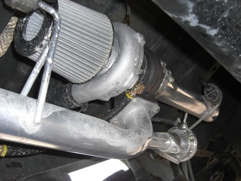

    Here is a simple example of good wastegate priority. Even commented as so, by customer service from TiAL. That is a TiAL 38 as well.

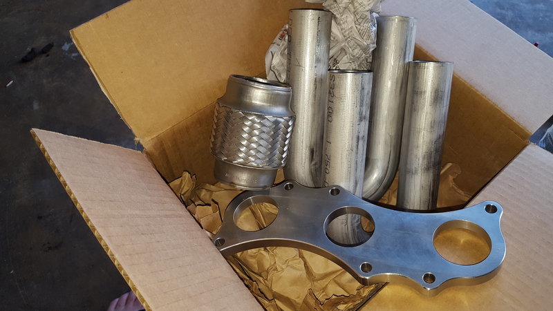

    321 beeshes. Made in mutha fawkin' the best damn country ever! USA.
