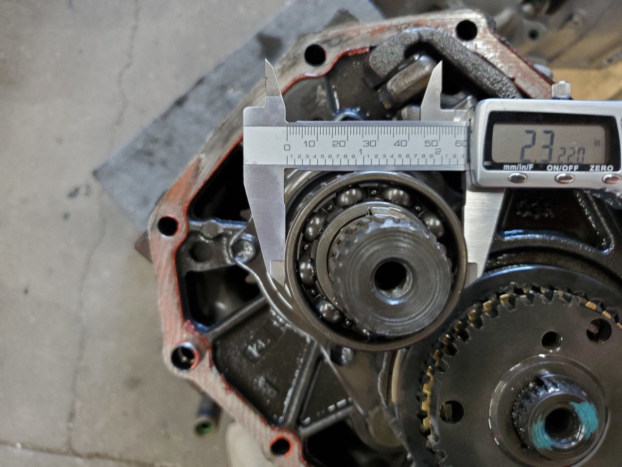

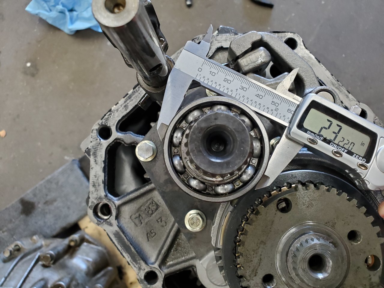

    For anyone wanting to put a r151f behind a 5vz and use the left hand drop chain transfer case, you will need the 5 speed out of a Hzj79. Then all you need to do is swap on your Vz bell housing and r150f extension housing/shift lever/rail. No adapters or mumbo jumbo. I will say be very careful when separating the extension housing from the 151. It has sealant on both sides of the center steel, so if you don't plan to take the front case off and reseal, don't break that seal. If you are refreshing it then it doesn't matter. You can use the transfer case from a A340f or r150f, you just need the shift lever from the r150f. The auto lever will hit the 5 speed stick.20211108_155707.jpg 20211108_155751.jpg 20211108_155804.jpg

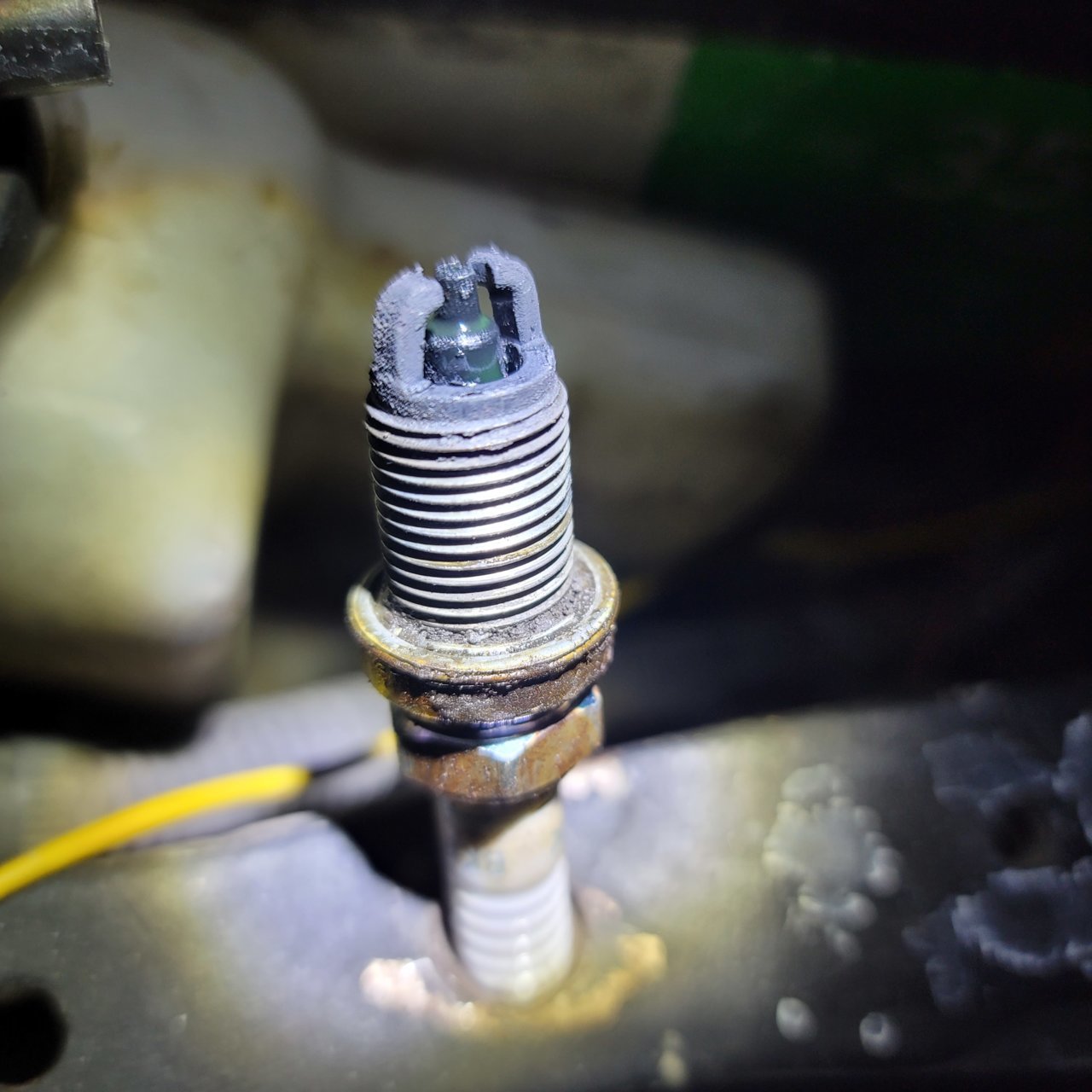

    Hey yall. So am i delirious from working too many hours, or is this coolant on the end of this plug?

    A little blurry but it looks green. What did that come out of? Looks like bloody hell.

    Don't know. What heat range and what gap are they?

    Ouch, yeah, maybe want to check for a head leak. Looks like your temps are way low, way rich, lots of build up synonymous with a head gasket leak.

    look like original dual ground plugs that have been in for 100k

    Could be that too...

    Yeah i was afraid that would be the consenses
