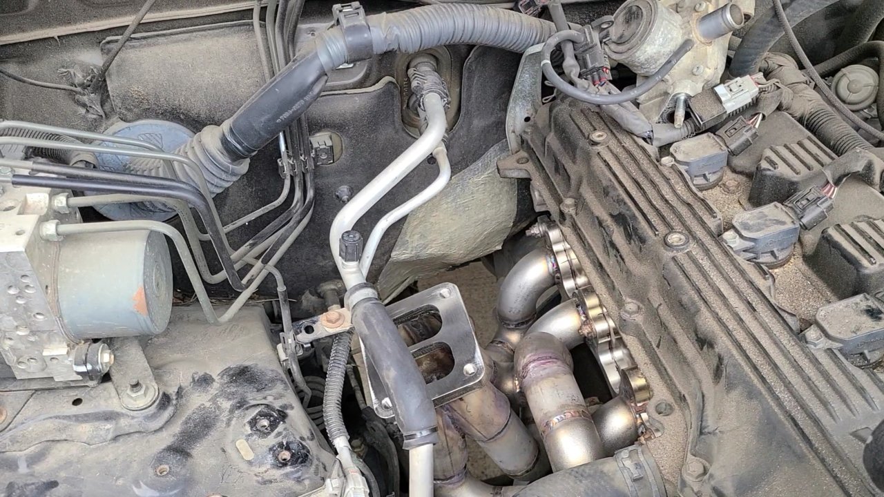

    Yeah. RHD manifold doesn't like A/C lines on the LHD Tacoma.
    Even without the A/C lines issue, the header was too close to the fender well. The design with the w/g on the BW EFR 6758, would have contacted.
    Not ideal, if I want to make more of these for other people.
    The new design, raises it, obviously. Allow for a larger sized turbo. Up to the Borg Warner EFR 9180, I bet. Should someone be so bold. ;)
    Now if I could do a hanging style, that would really make for an easy down-pipe routing. As is. Should be very easy intake routing.

    that’s the sweet spot for fitting any turbo nicely up to the big boys. My current manifold is very close to your latest design.
