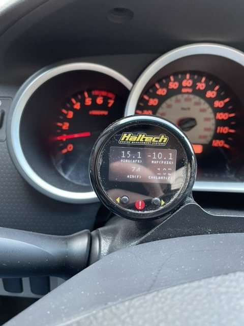

    Seems the AFR sensor on the Haltech WB1 went out

    All back to good?

    So much less lean. That's healthy. Lol

    Just now getting on ESP to see how this might have screwed with my tune, there's a P2A00 code but no engine light so I'm going to have to look into that.

    It did try to make adjustments so I cleared out the O2 adjustment table and went for a little ride, all good now. I believe had I had the auto learn feature off the truck would have ran fine. I forgot to tell earlier that this went out on my drive into work this morning during interstate driving and after about a 3 minute period the truck was jerking around and vacuum was showing like I was driving into a hurricane head wind. It ran incredibly better at 50MPH on the way home, much more normal behavior but I got some nasty looks haha. After another week or two of driving and it relearning the fine tune I'll turn the auto learn feature off and it'll be locked into the tables. One day I'll have this thing pro tuned, I just don't want to drop any more money into it until my home reno projects are finished.

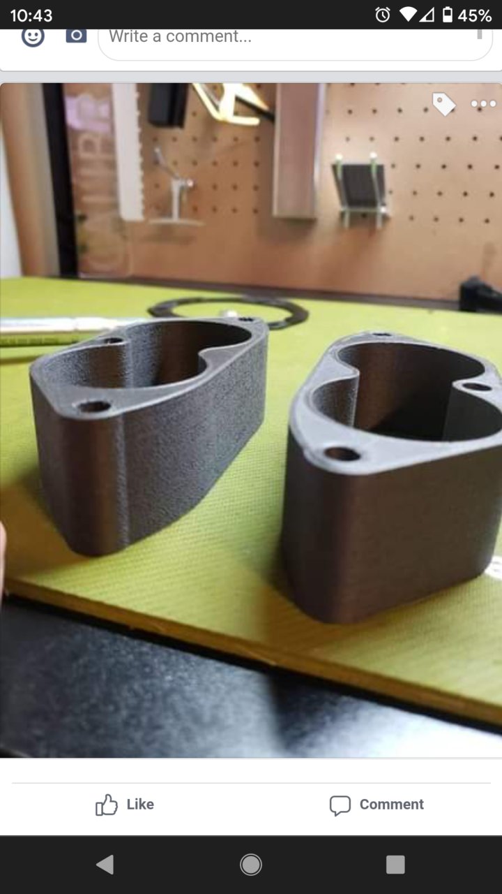

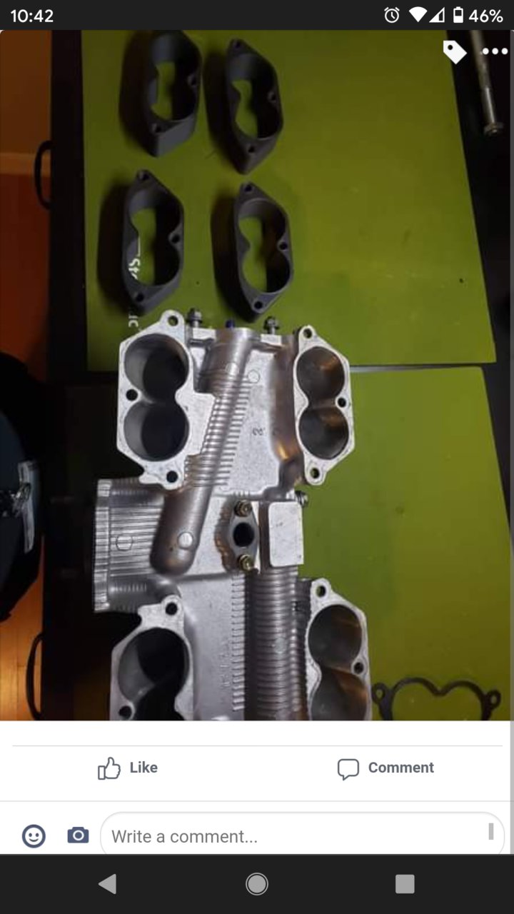

    What's your opinion on extending the intake runners on an NA. I've seen people 3d print some spacers but don't know if it's worth trying. I do have plenty of space before I reach the hood.

    What do you have to lose by trying?

    Theory is you should gain more bottom end power and flatten out the top some. Works like a 2 stroke pipe.

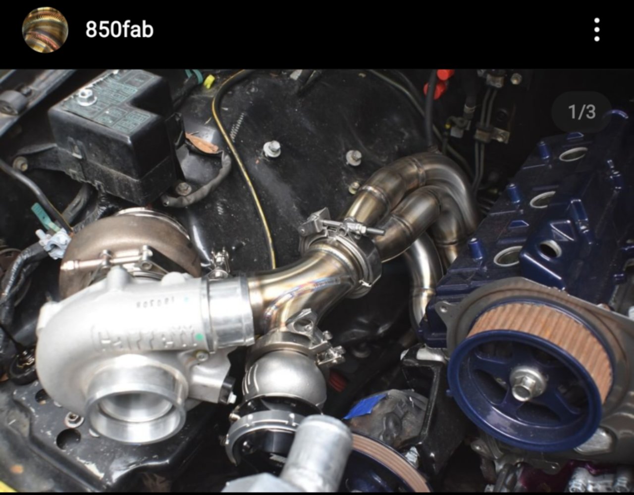

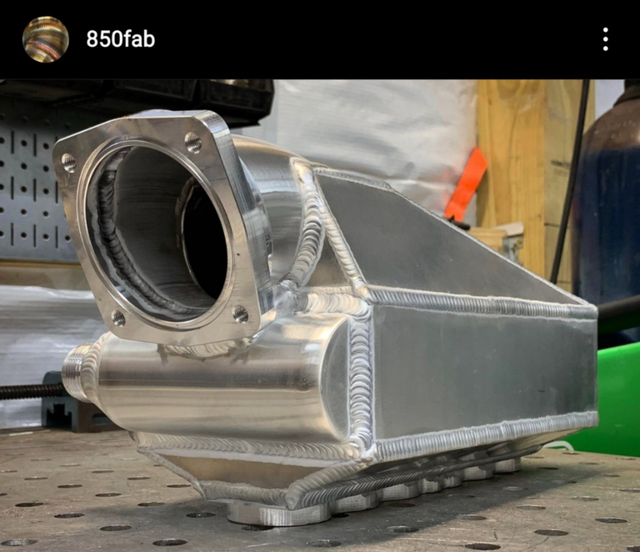

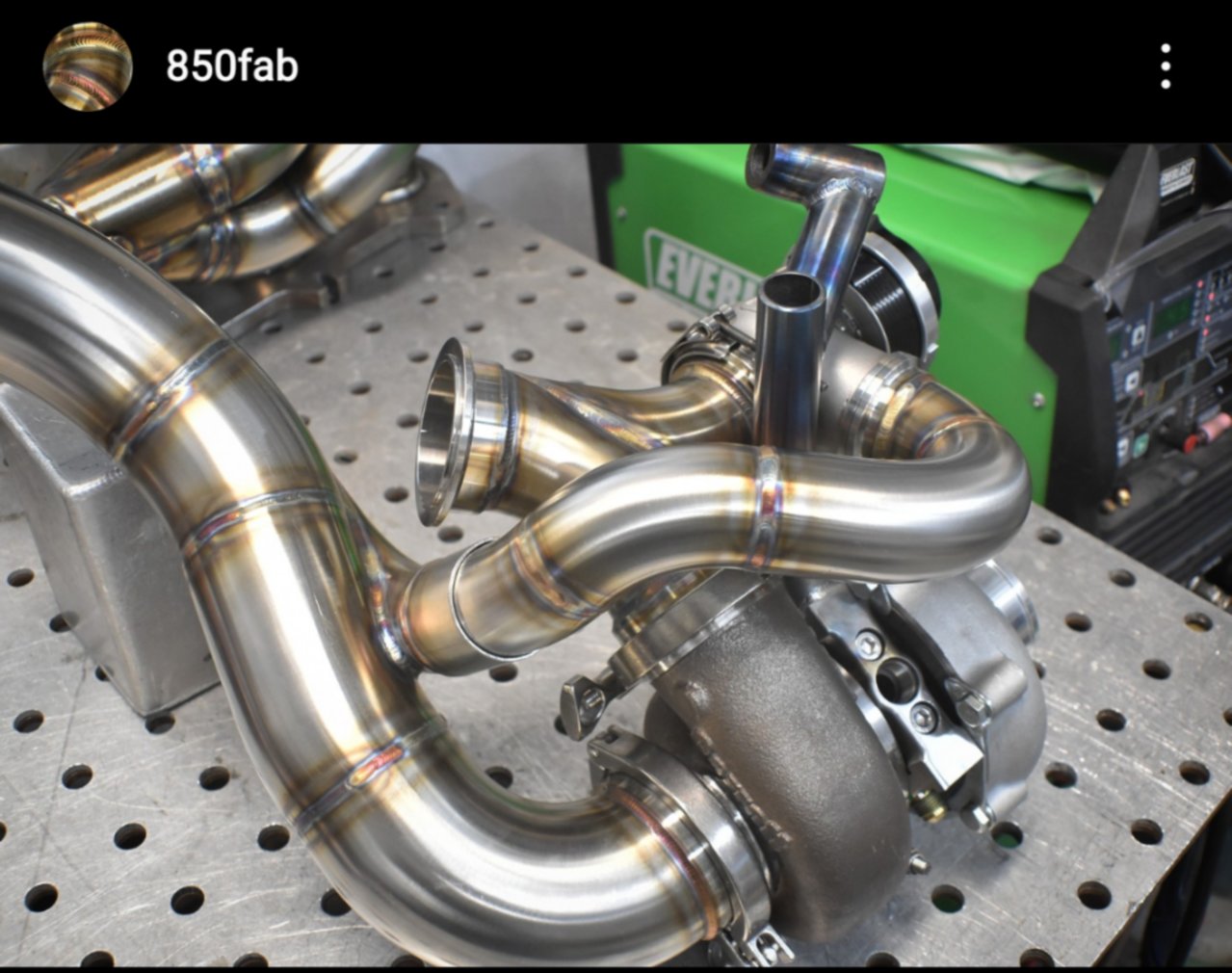

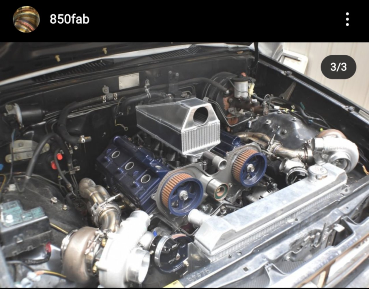

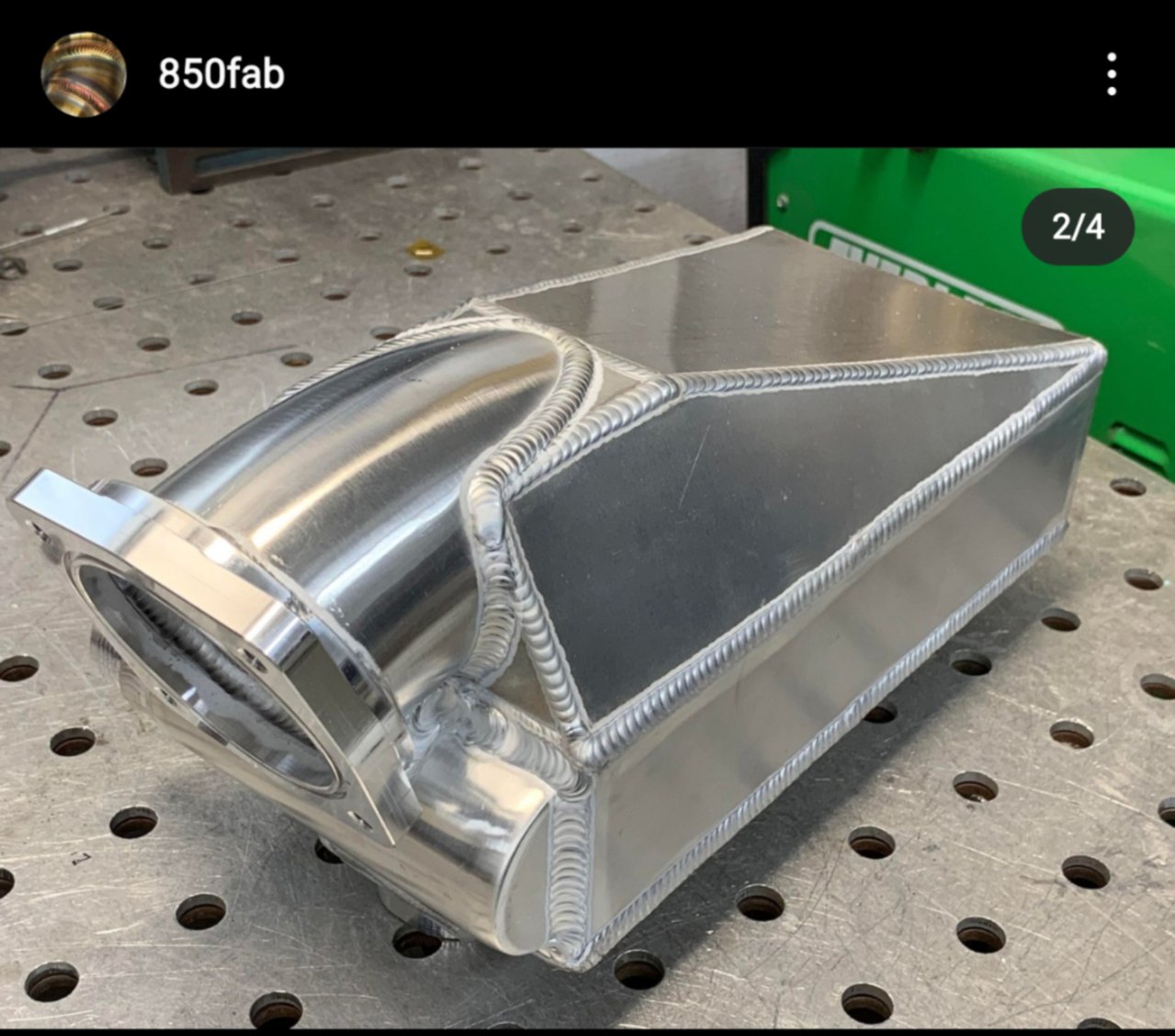

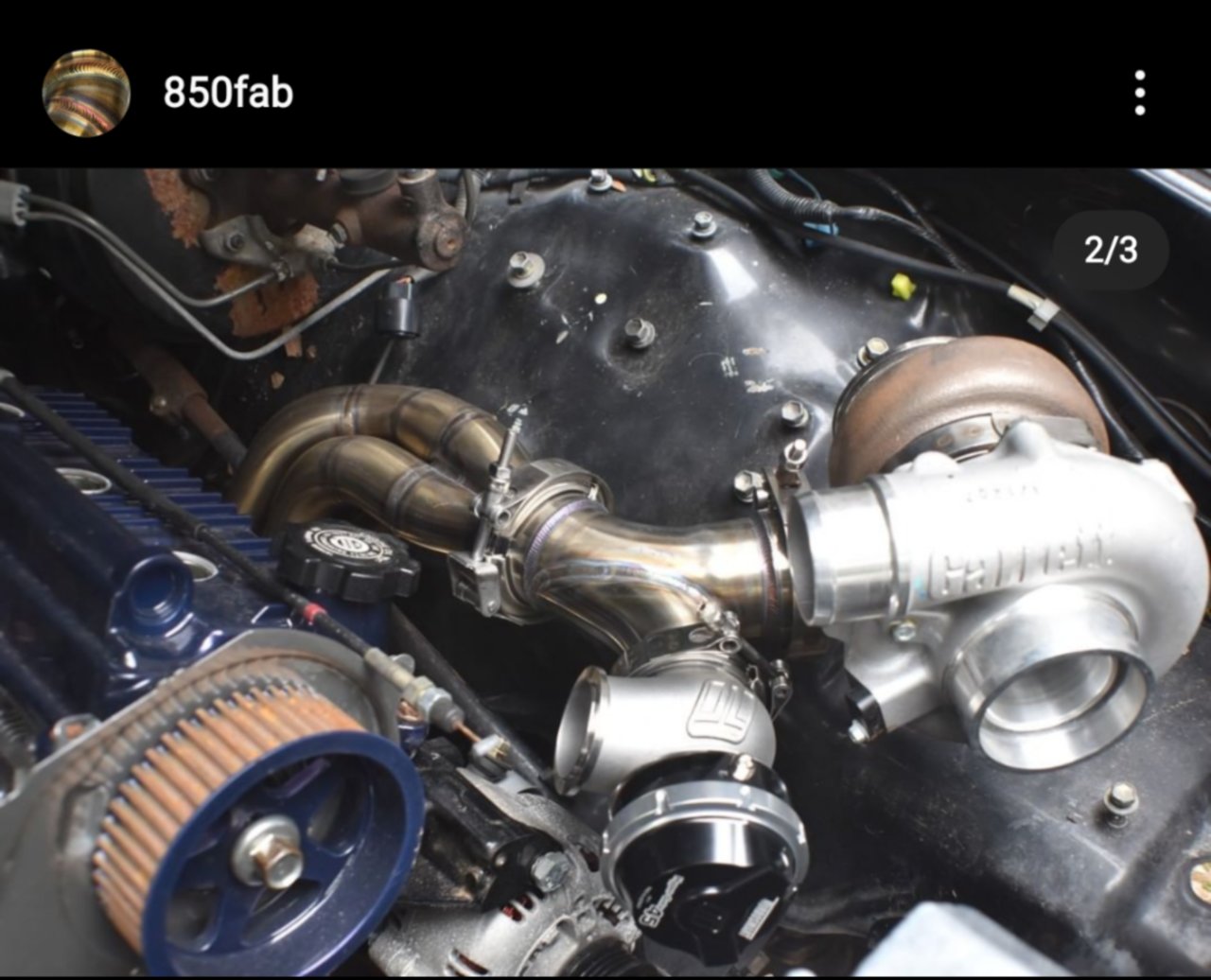

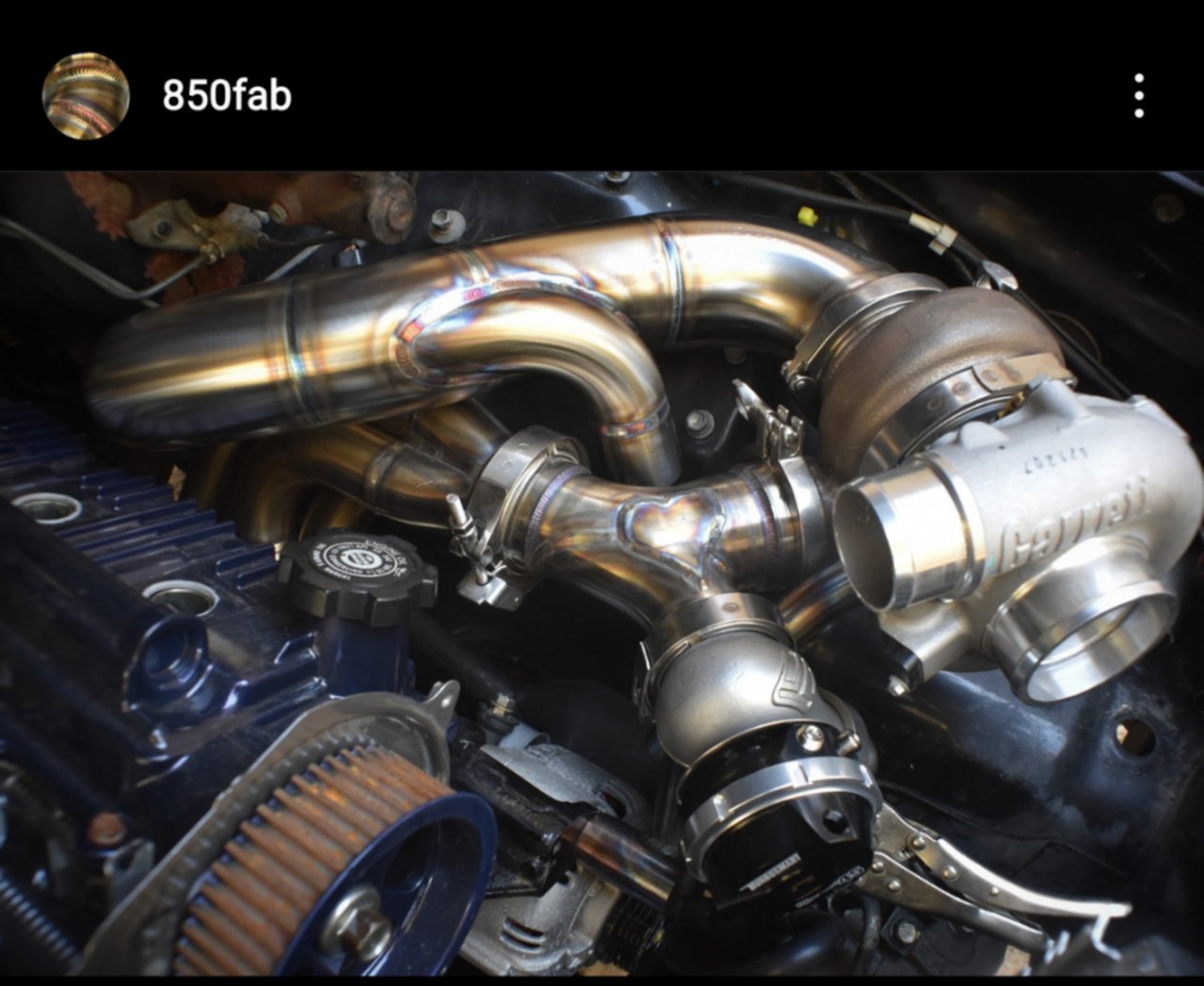

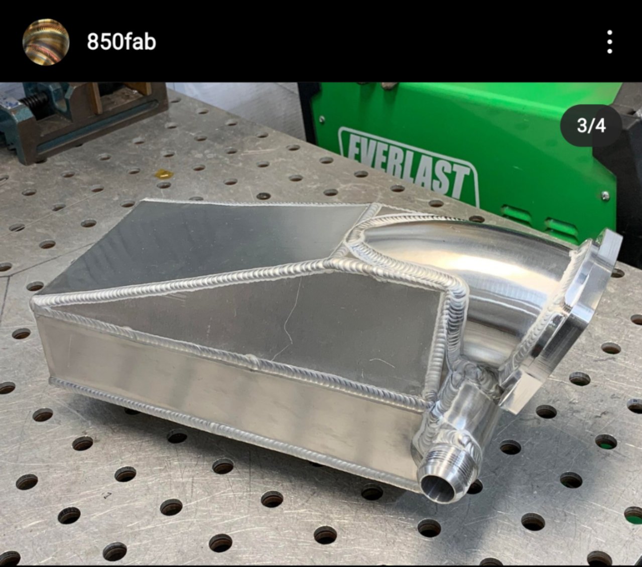

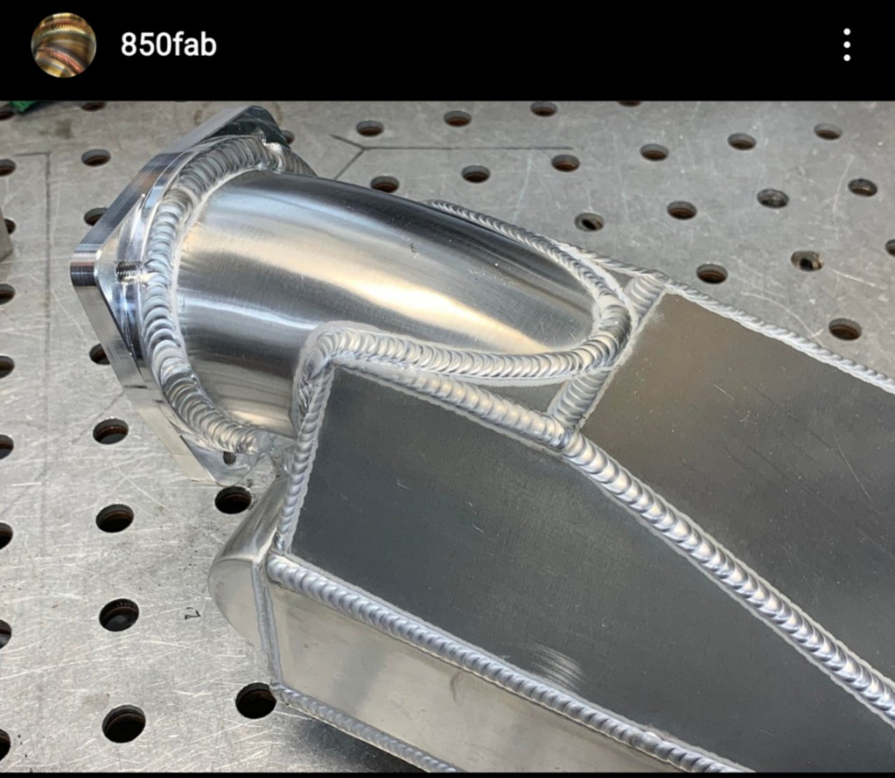

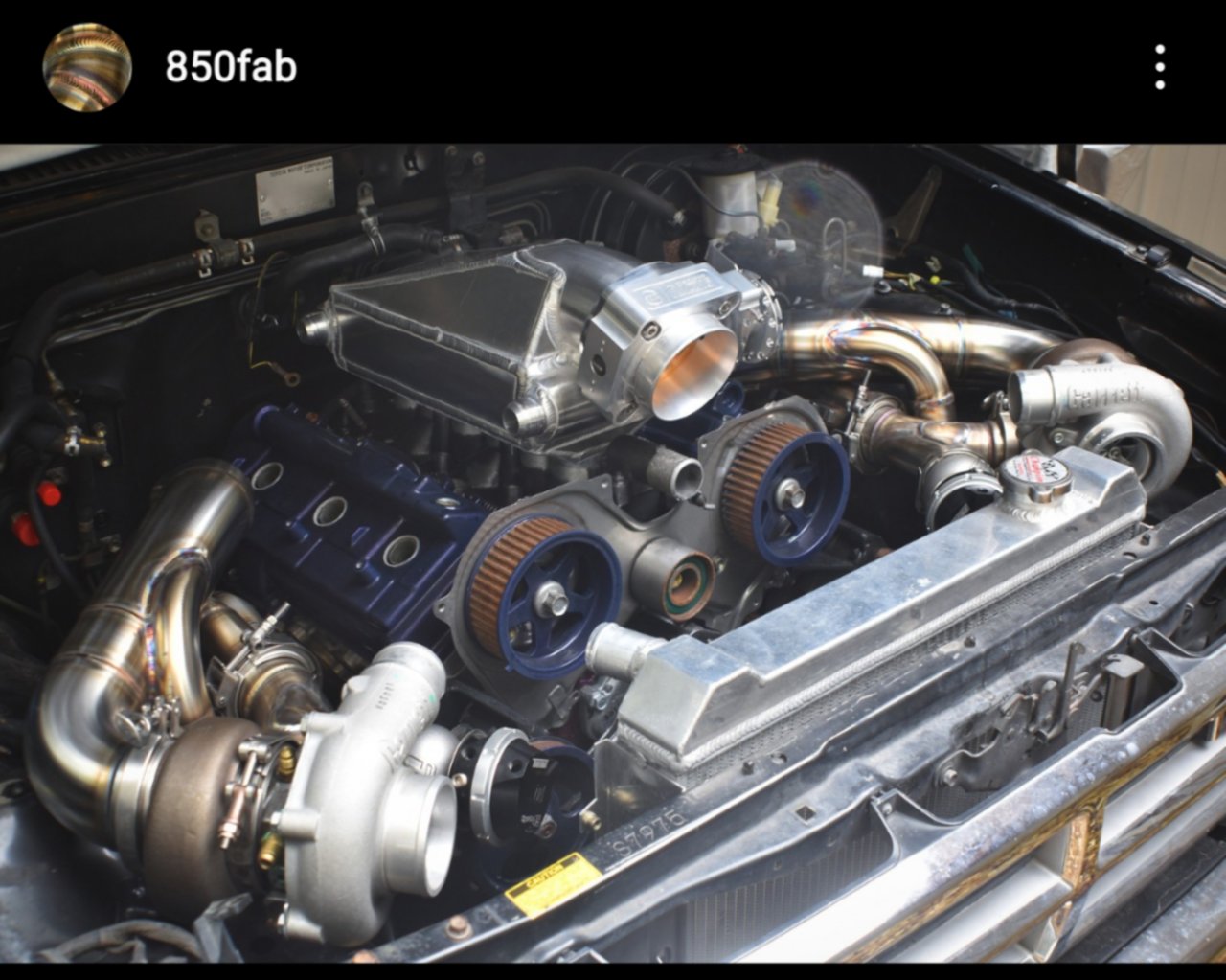

    Thanks for the reminder. I haven't checked in a while.
    Of course it doesn't disappoint. Work of art.
    Screenshot_20211229-153103.jpg Screenshot_20211229-153131.jpg Screenshot_20211229-153151.jpg Screenshot_20211229-153212.jpg Screenshot_20211229-153236.jpg Screenshot_20211229-153448.jpg Screenshot_20211229-153523.jpg

    That looks wickedly good! I like the fluid motion look of the exhaust.
    I was also curious how they planned on supporting the weight of the turbos. Now I see it.

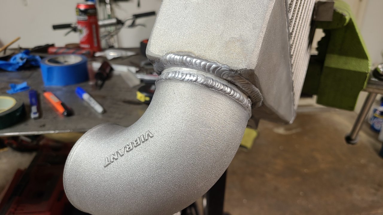

    Yup. Brushed my weld so that it wouldn't take away the thunder of that fabricator's welds. :cool: :D

    That dude has a steady hand.

    Machine steady. A true artist.
