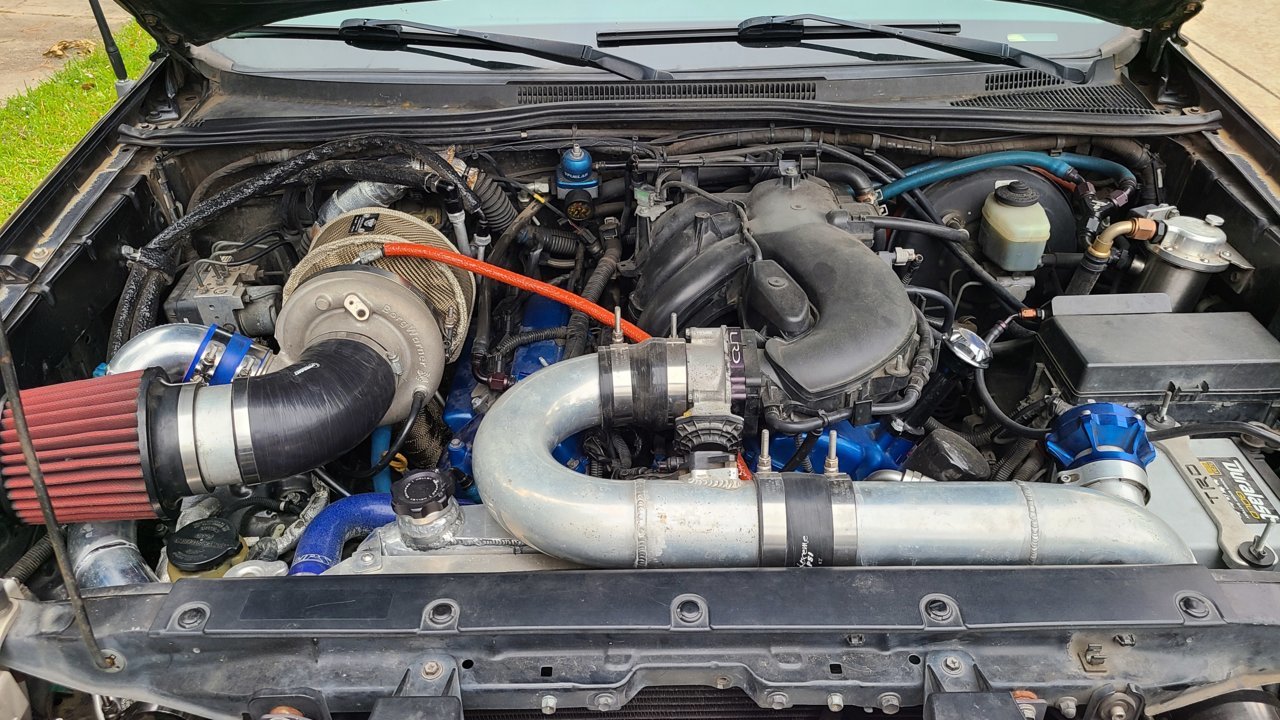

    Nothing like a nice 38 degree catless cold start to begin my morning :D

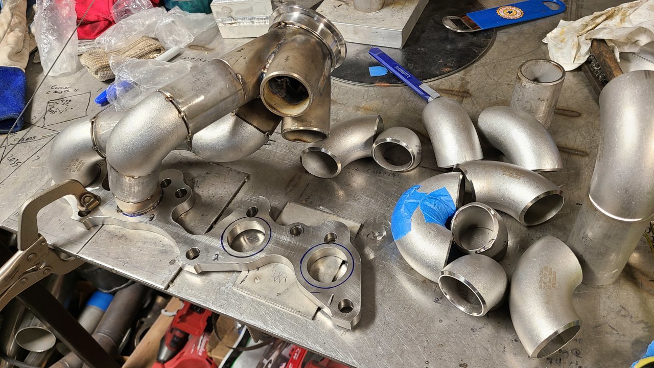

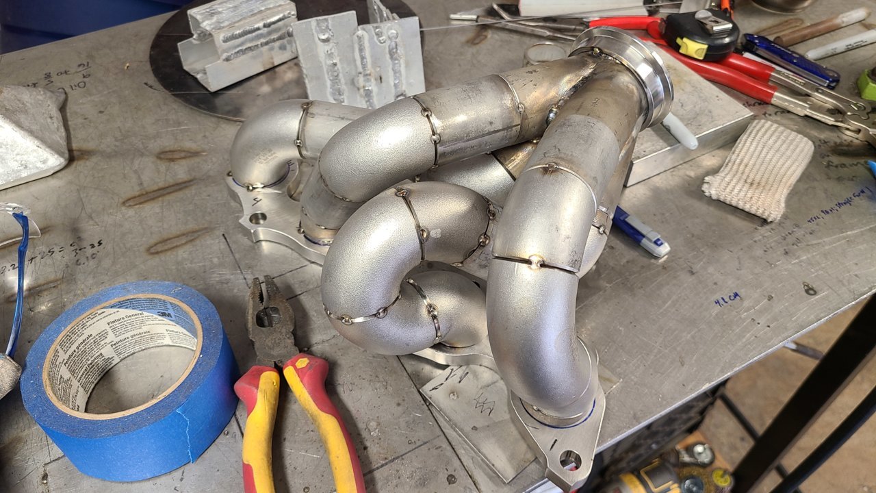

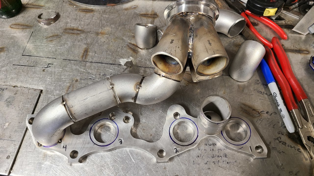

    4. For those that have not perused through @BassAckwards ' thread.
    Finished a few full welds yesterday, as well as fully finished fusing in the v-band merge.
    For my other friend's build, we finished the down-pipe to under-cab bend location and v-band welds. Need to grab a picture or so of that. For his, once we sort out getting the oil pan drain fitting installed, then his will be ready for start-up.
    His will need the URD intake tube extended closer towards the center of the radiator. The down-pipe will then need to be connected to the catback. So close.
