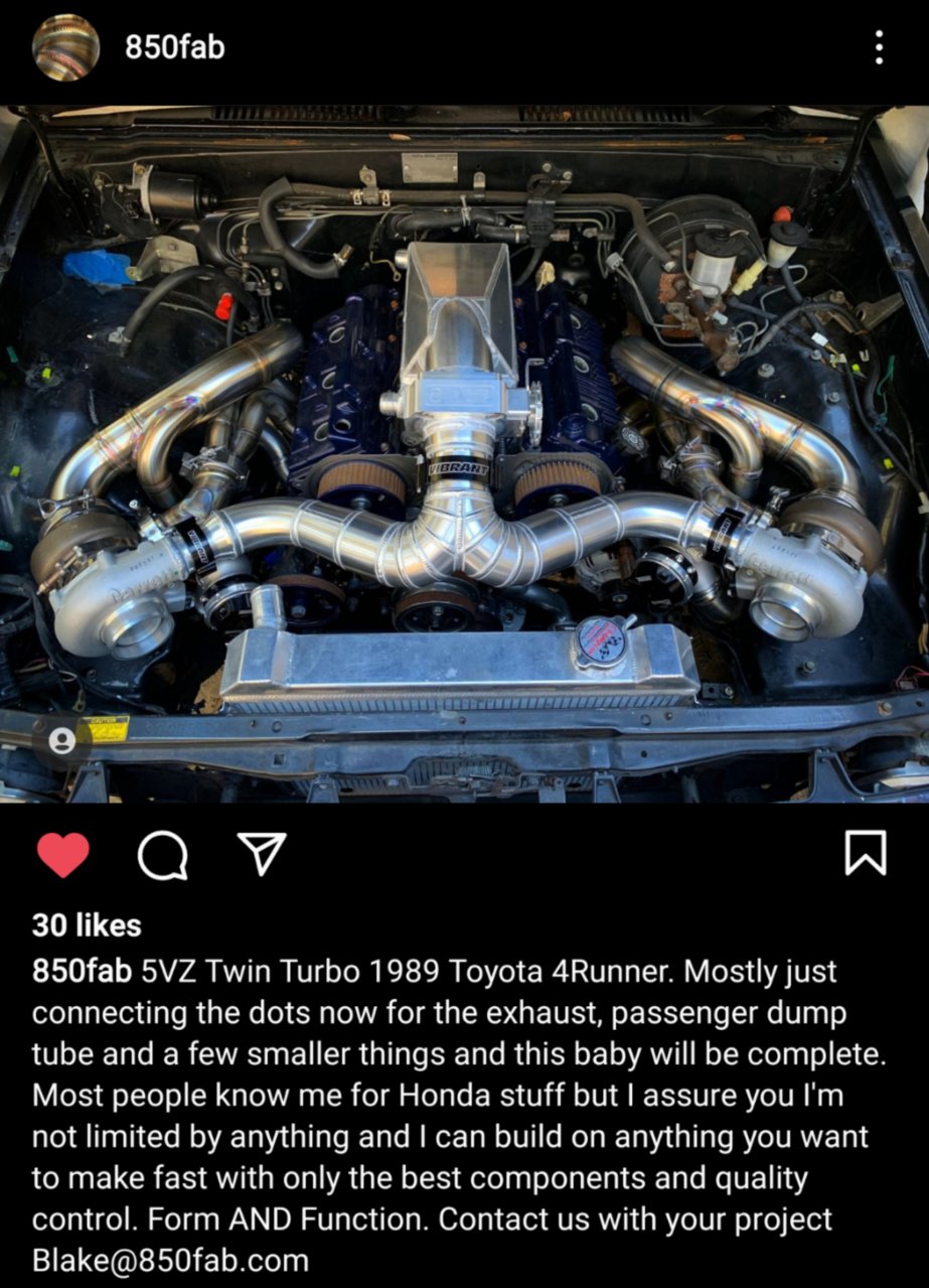

  4. Jan 13, 2022 at 7:02 PM
    MadTaco461
    MadTaco461 BRO runner
    Dec 30, 2009
    #28470
    13,409
    CA
    99 turbo 5 lug long travel
    Kinda stock
    The complete product. :jerkoff:

  8. Jan 14, 2022 at 4:42 PM
    Pinchaser
    Pinchaser Flipper Crazy
    Sep 6, 2020
    #339938
    428
    Alan
    2020 Tacoma ECU 04B82 AT
    Stunning!! Very impressive! Congratulations.
  9. Jan 14, 2022 at 6:35 PM
    Torspd
    Torspd Tor-nication
    Sep 18, 2009
    #22958
    26,412
    Tor
    The Great America!
    MMVI 4.4L 4x4 Access Cab
    Torspd Custom Turbo kit [] Borg Warner 9180EFR Turbo [] Haltech Elite 2500 [] TiAL Q BOV [] TiAL V44 Wastegate @ 15psi [] CP Pistons [] CP Carrillo Rods [] ARP Head studs [] ARP Main Studs [] ARP Header - Head Studs [] Ported Heads w/ 1mm oversized valves intake/exhaust [] Brian Crower Forged Stroker Crank [] Darton M.I.D. Sleeved Block [] Kelford Camshafts [] Torspd 160* T-stat mod [] APR Large Fuel Rail [] Walbro 460 LPH E85 Fuel Pump [] FueLab FPR [] APR T56 Conversion Kit [] KP RACING Built T56 [] McLeod Racing Custom Twin Disk Clutch [] One Piece Aluminum Driveshaft [] MGW Shifter [] Custom lowering kit [] Ohlins Front Coilovers [] QA1rear shocks [] Custom Ron Davis Radiator [] Dual SPAL Electric Fans []
    My only criticism, comes from what I don't know. Is it going to run methanol, since there is not an intercooler? Or is it only going to run low boost?
    I can only speculate.

  10. Jan 14, 2022 at 7:48 PM
    MadTaco461
    Dec 30, 2009
    #28470
    13,409
    CA
    Kinda stock
    That intake has an air to water IC in there. Go back a few of my post and you will see that it is custom. The water hoses aren't installed yet. Those 2 big AN nipples on the left side.

  12. Jan 14, 2022 at 9:36 PM
    MadTaco461
    Dec 30, 2009
    #28470
    13,409
    CA
    Kinda stock
    Big nips
  13. Jan 15, 2022 at 6:18 AM
    Torspd
    Torspd Tor-nication
    Sep 18, 2009
    #22958
    26,412
    Tor
    The Great America!
    Huge nips! Those big eraser size nips. Like -12 to -16. Good eye. Made for some very tidy packaging. I like it.
    We were going to do the same thing on my friend's BRZ turbo build, before he went half breed LS.
    If F1 can use water to air for that duration and temperatures, then there is a lot to be said about its potential, as long as you start with a really good core.
    MadTaco461 and Brake Weight like this.

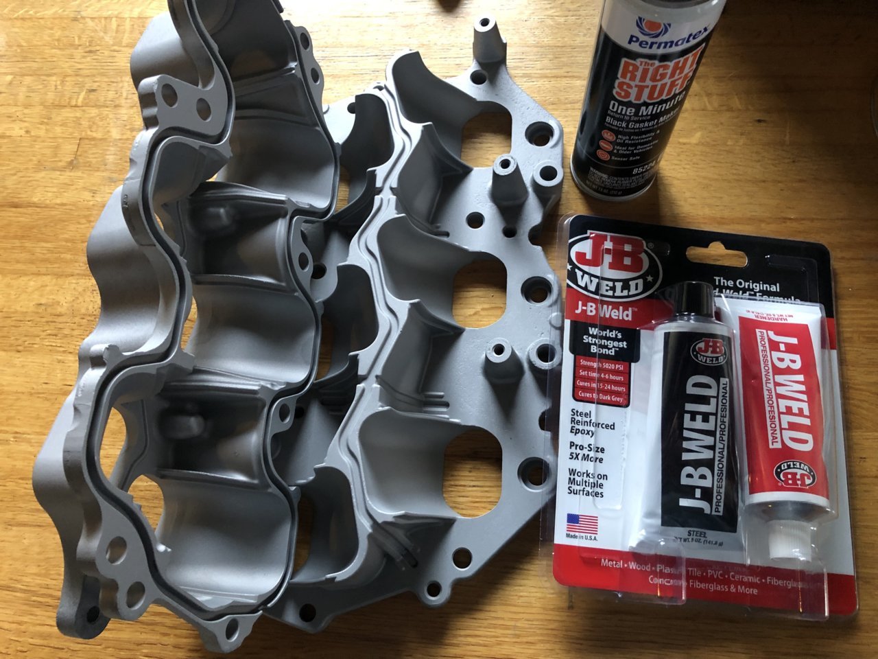

    I have two things to share: One is this tubing marker a friend of mine just picked up. The guy makes them custom to the tubing you’re using. Pretty cool concept to speed measurements up. My buddy is a pretty creative custom header building hobbiest.
    The other matter is more so my looking for opinions on which adhesive to go with.
    I split my intake runner top and bottom for a number of reasons and want to permanently affix the two halves.
    It looks like too challenging a job with the tight spaces to TIG the seems, so my thought was 78/22 aluminum brazing rod.
    It flows under 600 degrees so flows easier (possibly deeper) and minimizes warping. The few experienced guys I spoke to locally figured it’s not worth the extra effort and potential problems. They were skeptical about how far in it would actually flow, anticipating it would be very superficial in places.
    So onto adhesives. The two most popular suggestions are JB Weld and Permatex Right Stuff.
    Not that there’s a whole lot of fuel that reverts back up the runner passages, but the JB is more resistant and easier to sand when cleaning up the ports.
    The gasket in a can is the simplest application and plenty good at holding things together and easier to work with.
    I’ll be Cerakoting inside and out afterwards. That will adhere to the epoxy permanently.
    Before I blasted the runners clean I wanted to try an experiment. I chemically cleaned by boiling them in white vinegar. I think I would have had to do it over night to get a worthwhile result and the evaporation made tending that sort of operation unrealistic. Would have to have some kind of pressure cooking setup.
    Regardless, it was more out of curiosity than anything else that I tried. But, in doing so I discovered the runner passageways aren’t completely sealed from one other, they leak between the entire runner. I could see bubbles from the chemical reaction traveling from one end to the other.
    Not sure how much it might matter, or if there will be any improvement in airflow, but now they’ll be completely sealed and independent of each other. Might make more of a difference in a forced induction application. C4772A99-5AA7-47EA-B664-E9B79D38192C.jpg
    If you’ve never had to chance to see what these look like in two pieces, you can see the channels along the ridge and spurs of the base. There are corresponding raised beads on the inside of the upper that the factory lines with FIPG (which only partially seals them). As a result there’s considerable residual air volume remaining inside. The base of the upper has an o ring that sits in the groove and seals flat against the base; secured by the 4 security torx bolts.

  16. Jan 15, 2022 at 6:44 PM
    MadTaco461
    Dec 30, 2009
    #28470
    13,409
    CA
    Kinda stock
    I wouldn't cerakote the inside. You think it would flake off? Figure all the oils would get under it over time
  17. Jan 15, 2022 at 6:55 PM
    Hawk373
    Hawk373 Well-Known Member
    Dec 10, 2013
    #118276
    1,321
    2012 TRD Sport DCLB
    DMZ, ADS, King, JFR, SOS, ECGS, LSK
    It won’t flake off if prepped properly. The stuff sticks to pistons. It’s completely solvent resistant and has to be blasted off. If I use the right stuff as an adhesive I could see it disbonding from those seems and would need to address that.
    MadTaco461[QUOTED] likes this.
