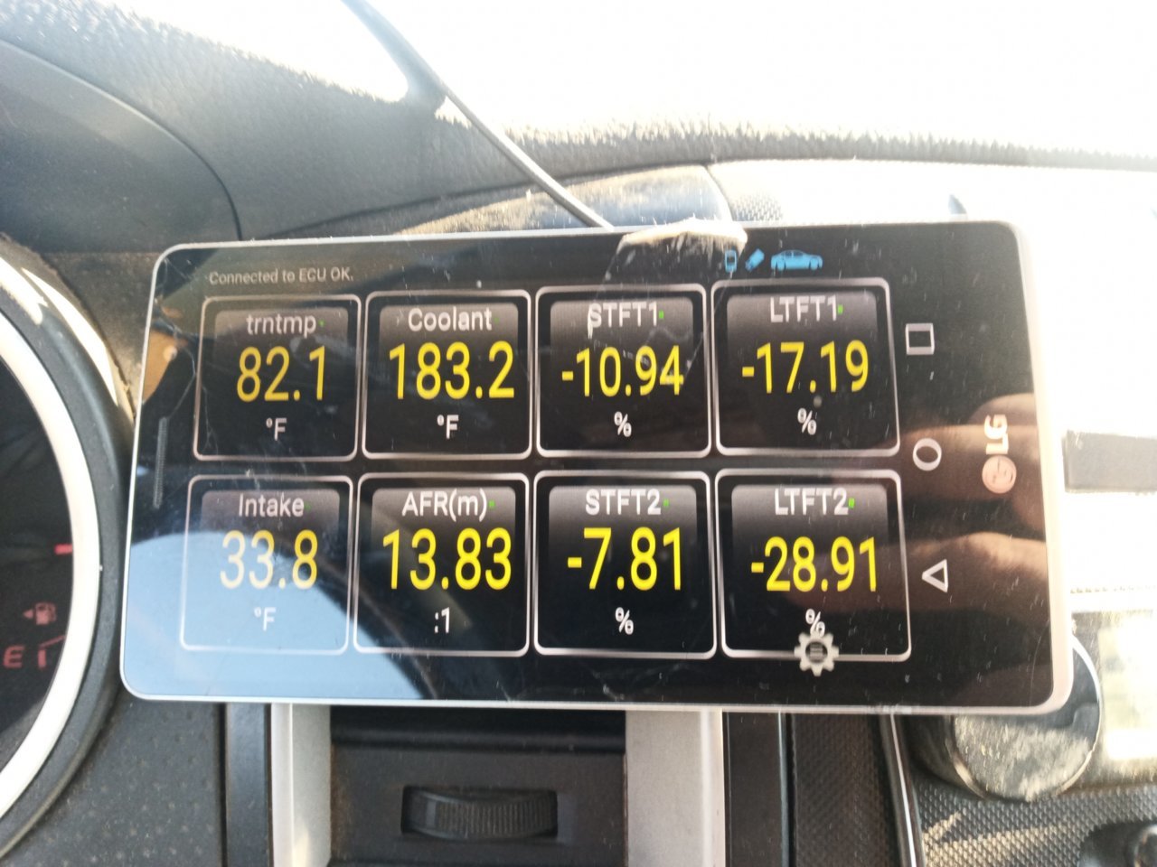

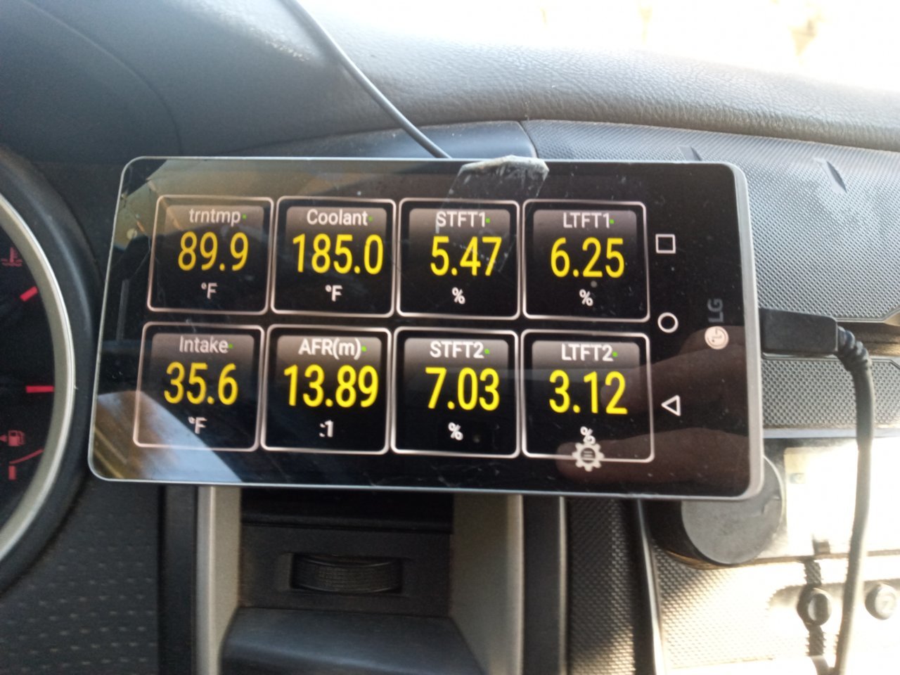

    For like 2 minutes this morning it seemed that someone slipped some non e85 in my lines... But it settled out kinda

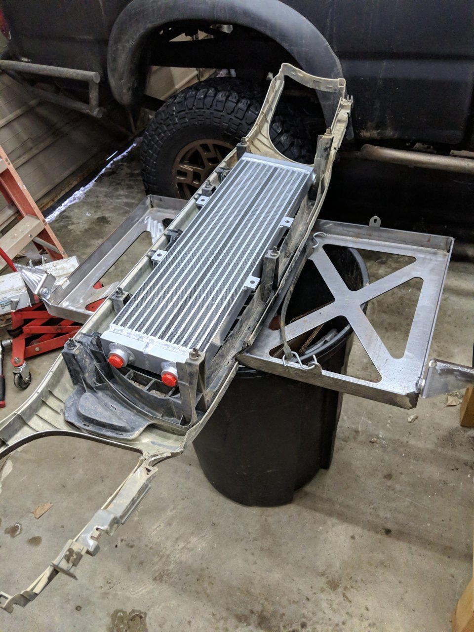

    It's own reservoir and pump. So far the radiator is looking like it'll fit nicely in the grill. The only problem is the extra weight on my core support is probably going to kill it. Already has multiple cracks in it.

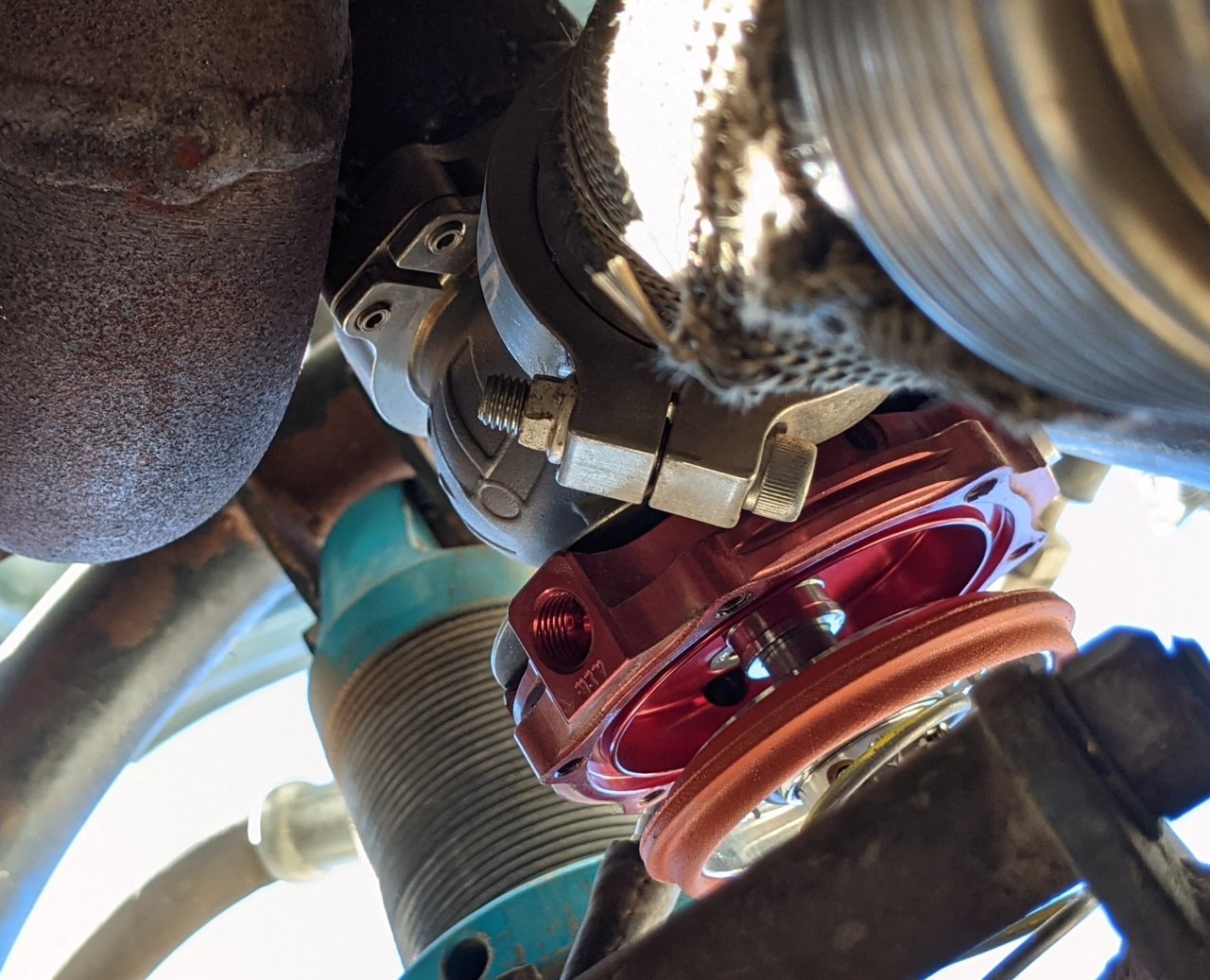

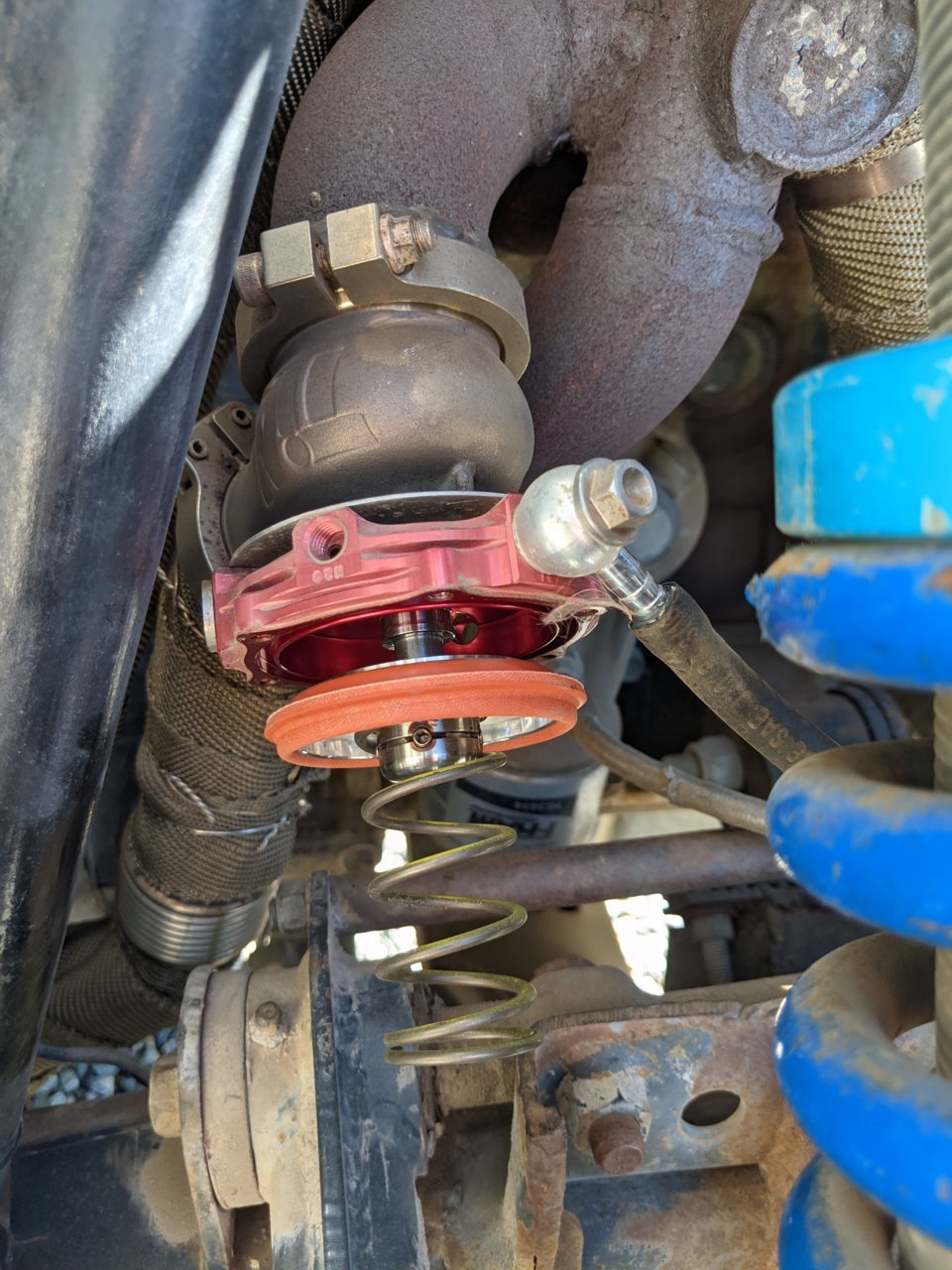

    Valve is just fine. I lost a port cap. The base has 3 areas you can hook up to. I lost the one you can't see. New plug and high temp loctite in my future. Ignore the open coolant portPXL_20220206_192612146.MP.jpgPXL_20220206_193122418.MP.jpg

    That'll do it. Easy enough fix though. :thumbsup:

    That's quite the perfect fit.
    I know you've the skills to gusset up that core support. Then it'll be perfect.

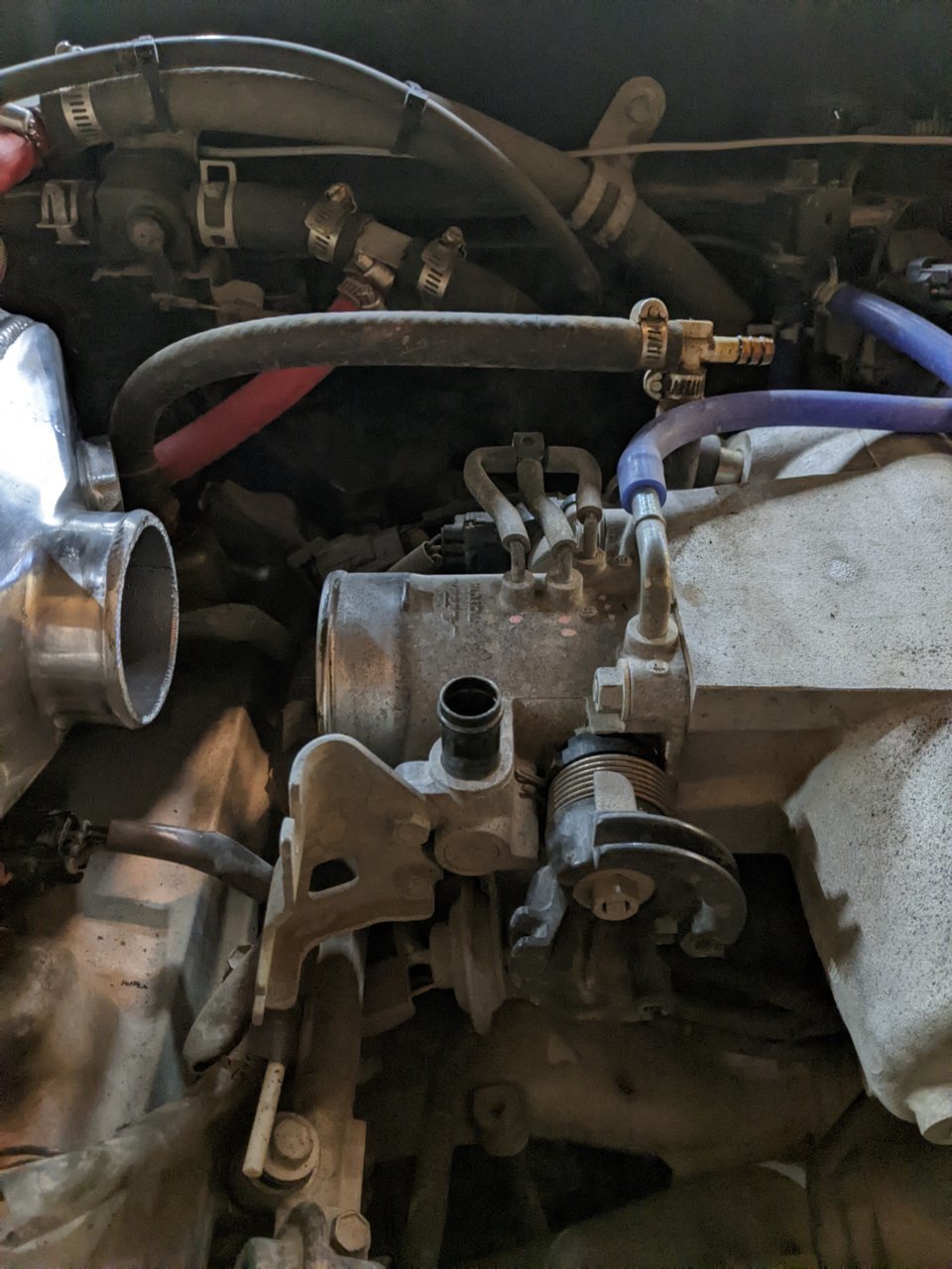

    Is there a general rule of thumb for blow off valve size? I'm sure larger is better. I'm considering using this port which I can't remember what it was originally for, pvc return maybe? It's about a half inch hole.

    You cannot use that port for the BOV actuation. It needs to be post throttle body. To have vacuum and boost.

    That hole is a bit small. Just cap it off. Put your BOV by your turbo kinda like how an EFR turbo is.
    edit: plus you don't want to add any more turbulence around your throttle body.

    Not for the signal line, was thinking of venting it out of there.

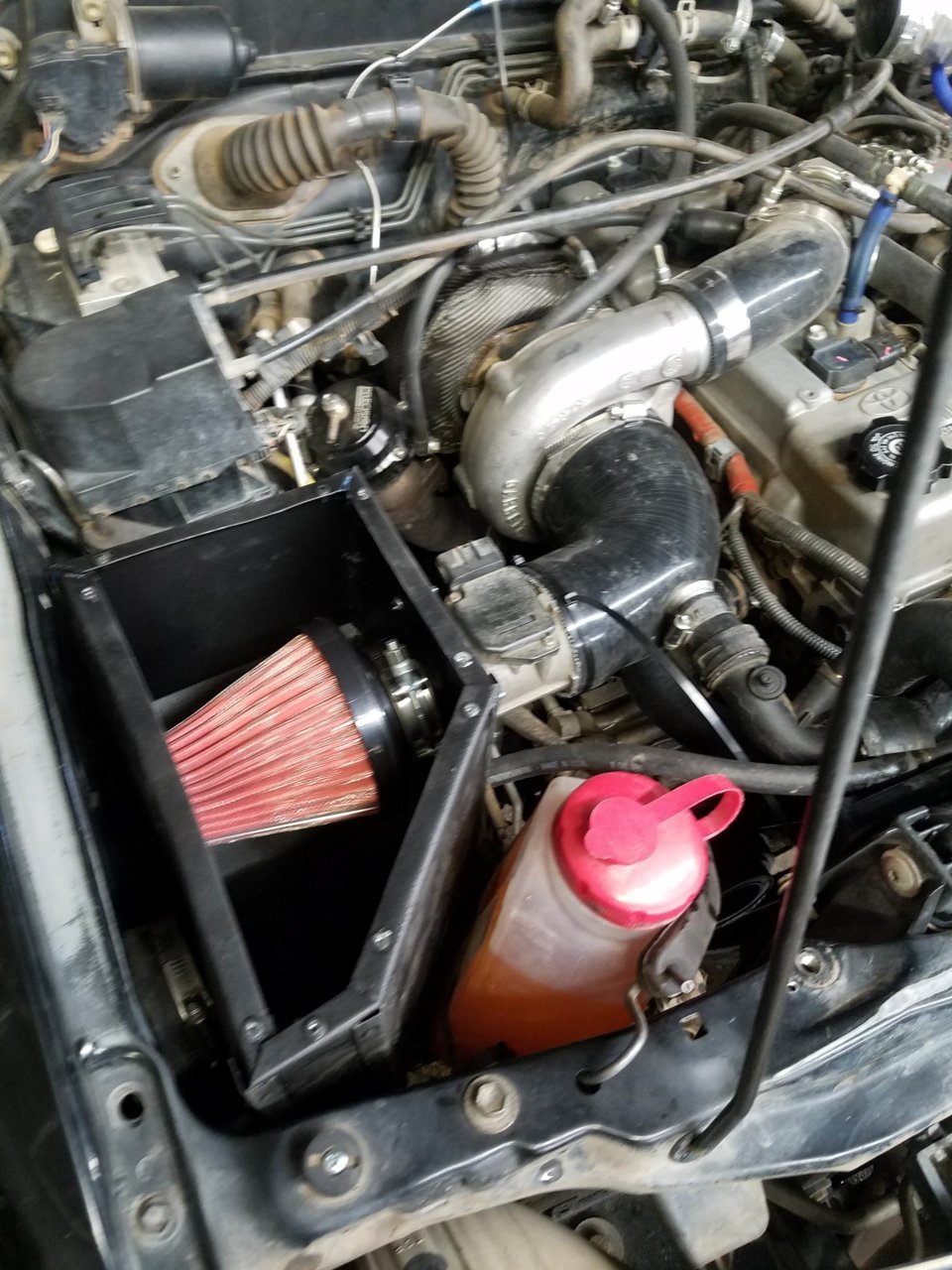

    Yes, still running with a MAF. It's staying in the same place it's been, right before the turbo. The BOV is a 25 air 75 recirc type to keep from stalling.
    Old photo but it's pretty much still the same other than a better filter. The port on the 90 coupler is the return for the BOV. At 100% it would screw with the MAF and stall, the 25/75 seems to make it all happy. 20190502_194412.jpg

    Maybe tap a hole on the intercooler like the subarus

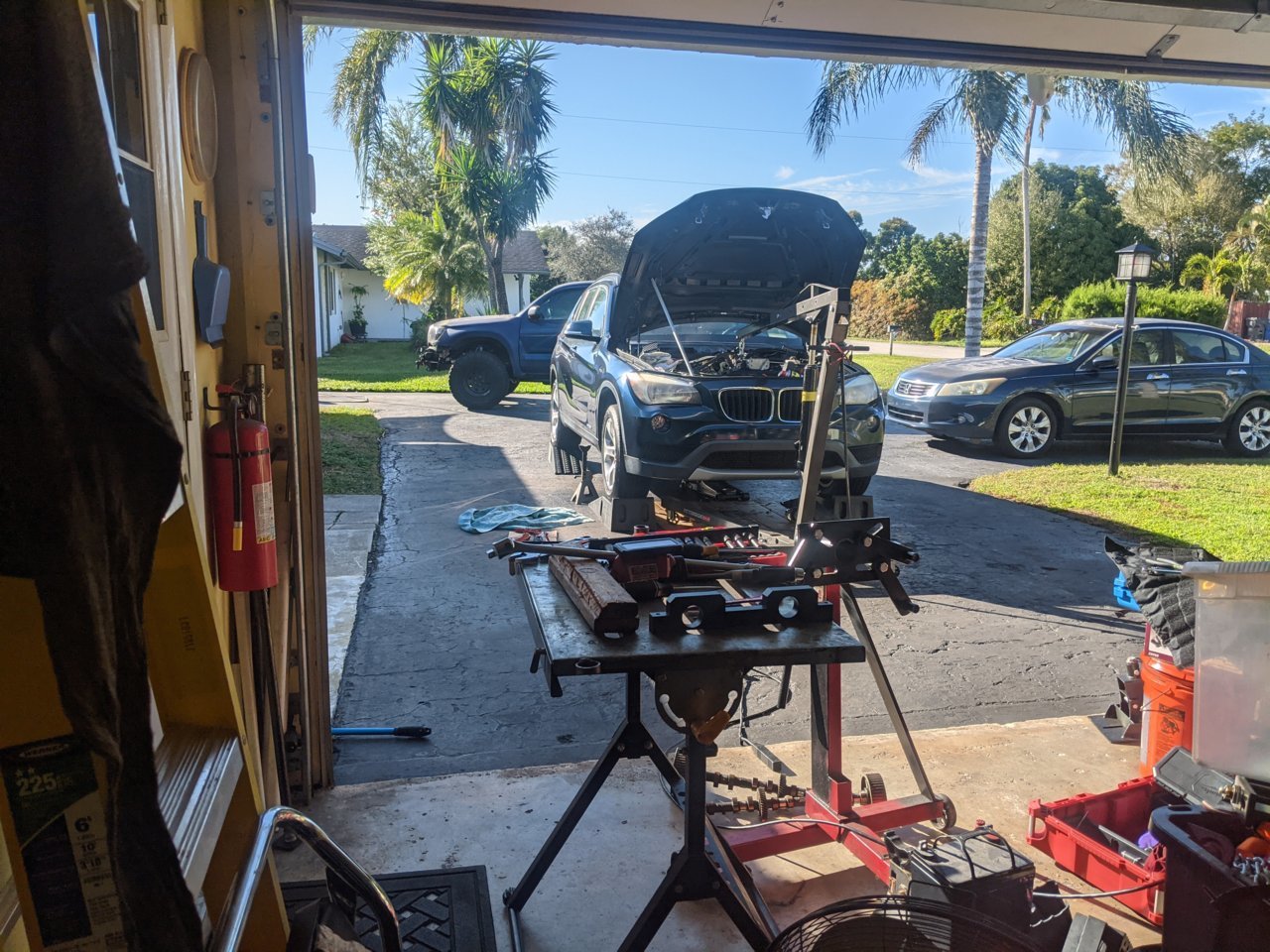

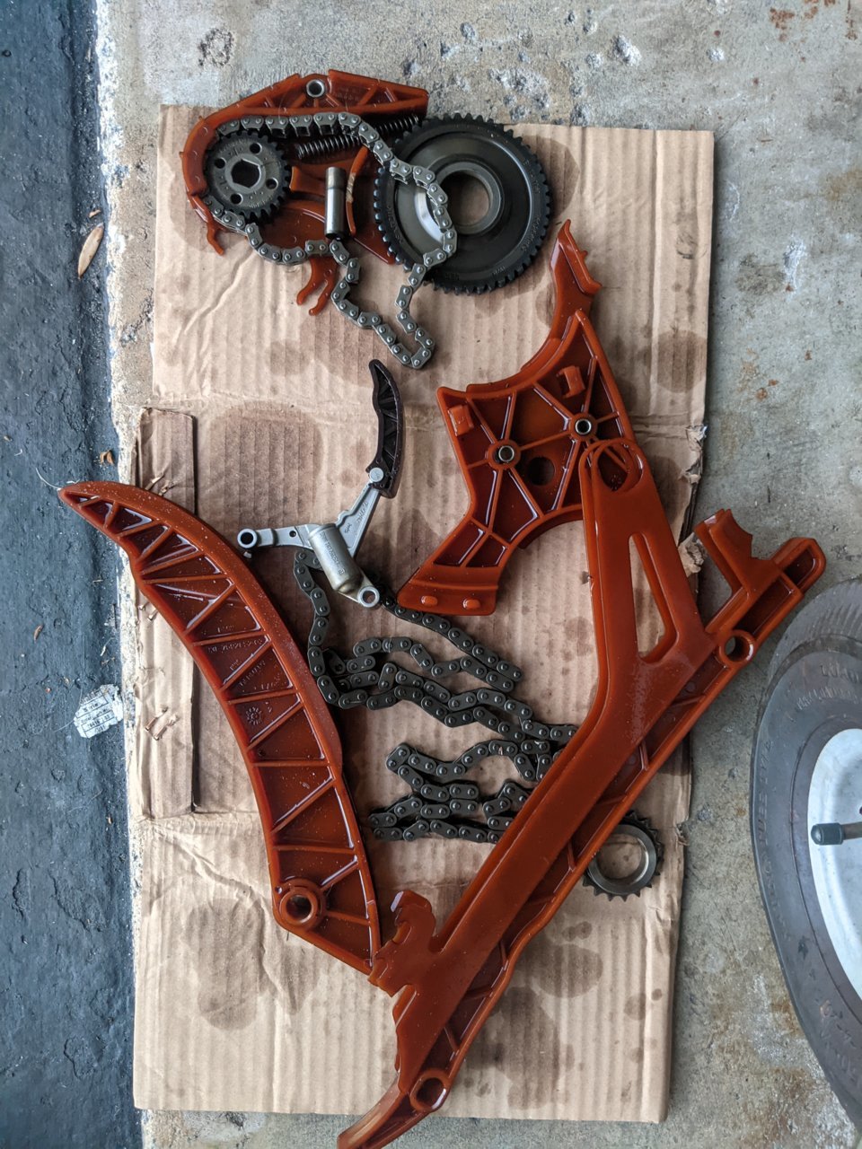

    So I got another 5 lug but this one has a turbo (n20). It needed a timing chain job so that took a bit to do.
