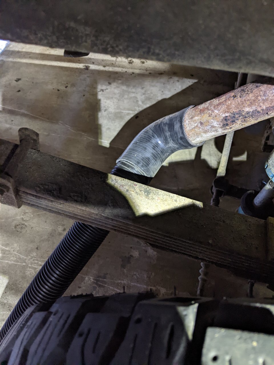

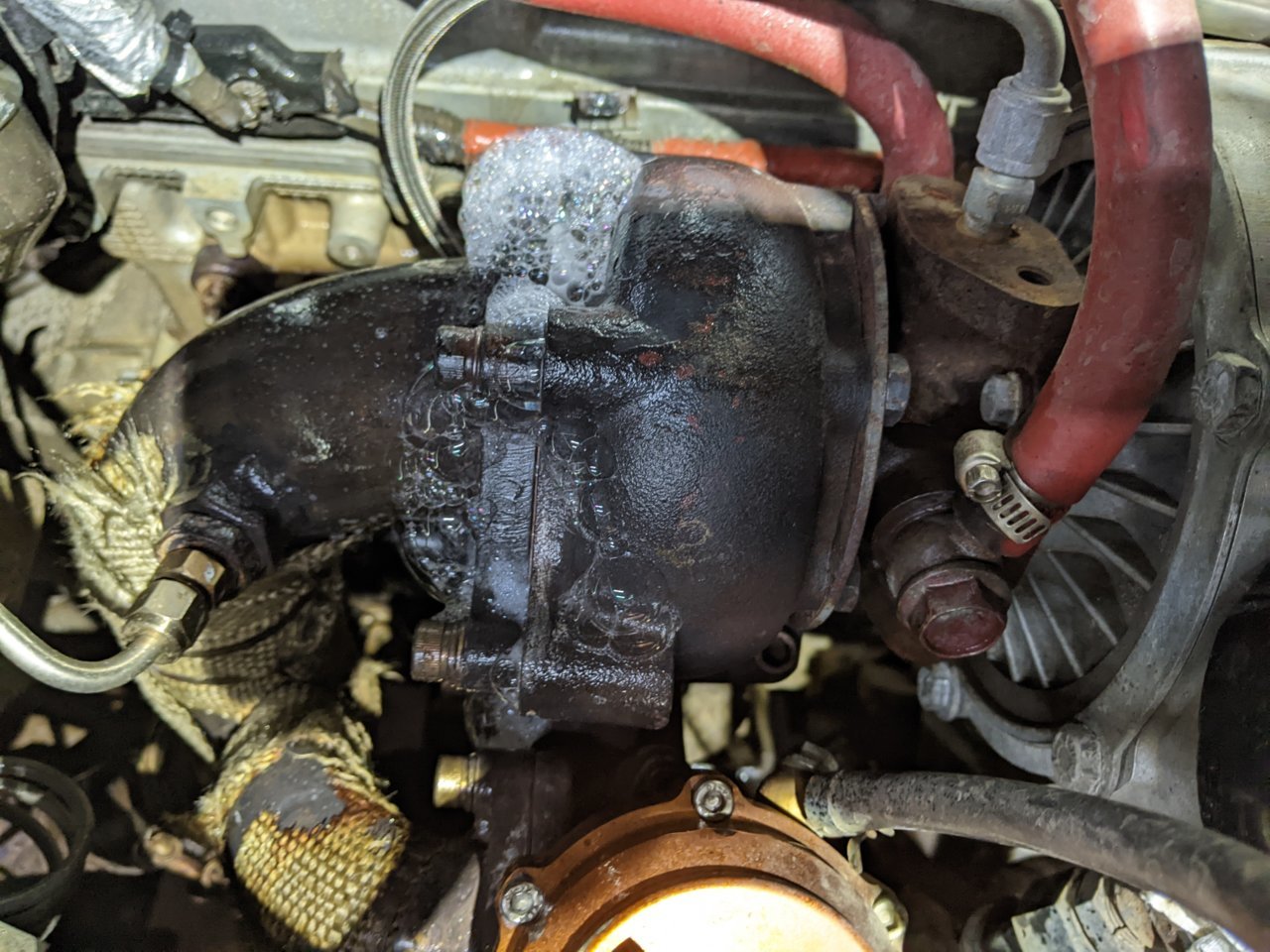

    Idk if any of you guys have heard of using a shop vac to test for leaks but it works great! Attach the hose to the blow side and plug it in your tailpipe. Get some soapy water and start squirting!

    Quite creative!

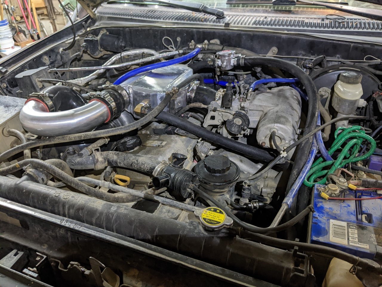

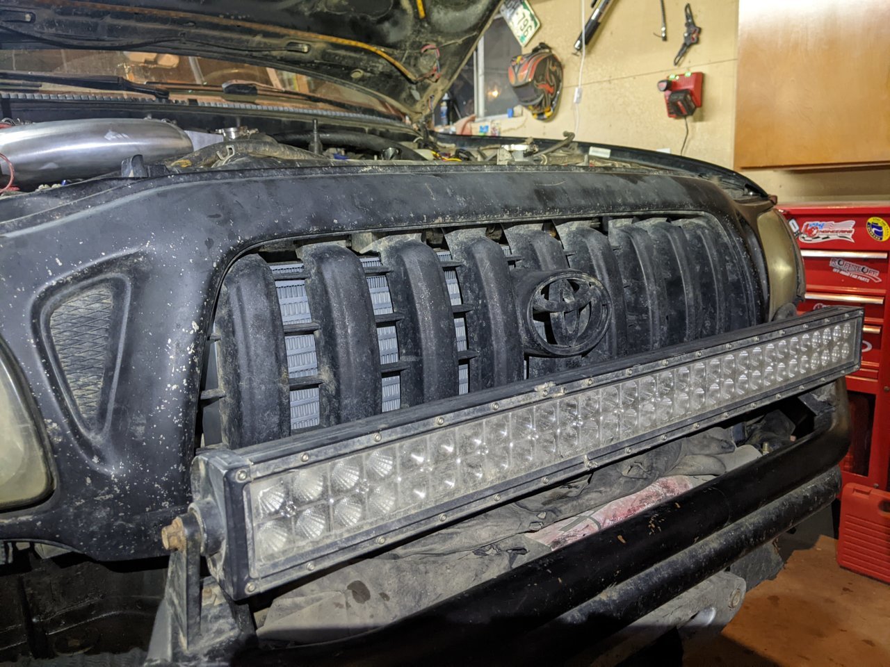

    Still have a few things to do but this is how it's looking. Thinking about just doing away with the BOV all together, unless it screws with MAF too much. Would be convenient not having to plumb it in somewhere. For now it's a plug lol.
    I'm very happy with the how well the radiator fit.PXL_20220220_035231456.jpg

    That looks fantastic. I highly recommend keeping the BOV, if at all possible. The turbo's life span will thank you.
