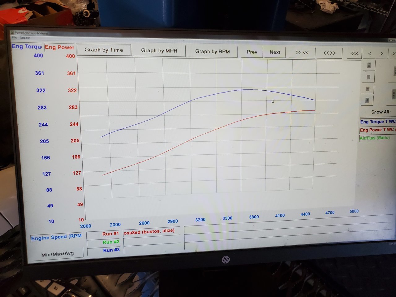

    3.4 on 8 psi.
    35r w/1.03 housing

    Dang that can make a lot of power. What size tires?

    35" w/4.56 gearing.

    Damn that is smooth!
    Good clean power, without needing to get crazy with the supporting mods. Well done!

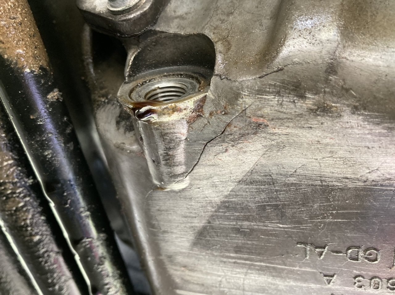

    I smoked a speed bump in the Audi and it cracked my oil pan at the drain plug. Lost a quart of oil in a week before I realized it. Ordered a new pan but on this you have to raise the motor 4” or more to remove and install. I have a spare motor with forged internals so it’s getting yanked and put on the stand for fresh bearing and inspection and block painting. Oil pan going on then the FBook used rs4 240mm SMF mated to a 400/400 rates clutch assembly. Big turbo will follow as soon as funds allow an ECU remap to support it. 3 months should be enough time to get it done.
    I forgot the gratuitous pics. Here the pan. I spackeled that dude up with some red gasket material for now and holding well.

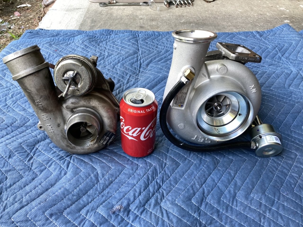

    Then this snail. Any good coating I can apply at home for the hot side to hold in heat. I have a powder coat gun and oven. 8C207A09-C1F8-4678-A662-49A9085B6D1C.jpg

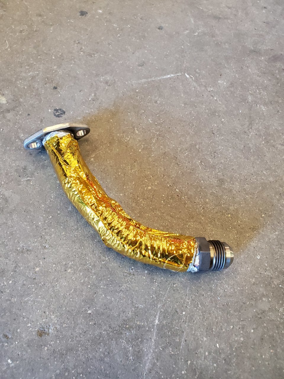

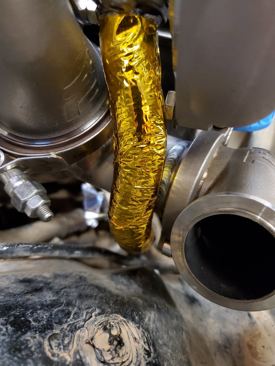

    Looks like a Holset drain line.

    Nah, it's some stainless tube off a Subaru I cut up and made work.

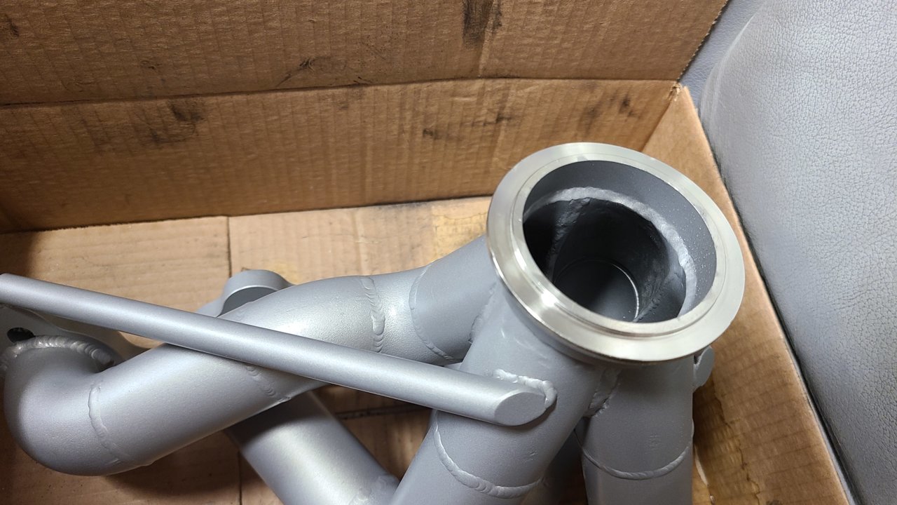

    Any suggestions for a hot side coating for aesthetics as well as keep in some heat?
