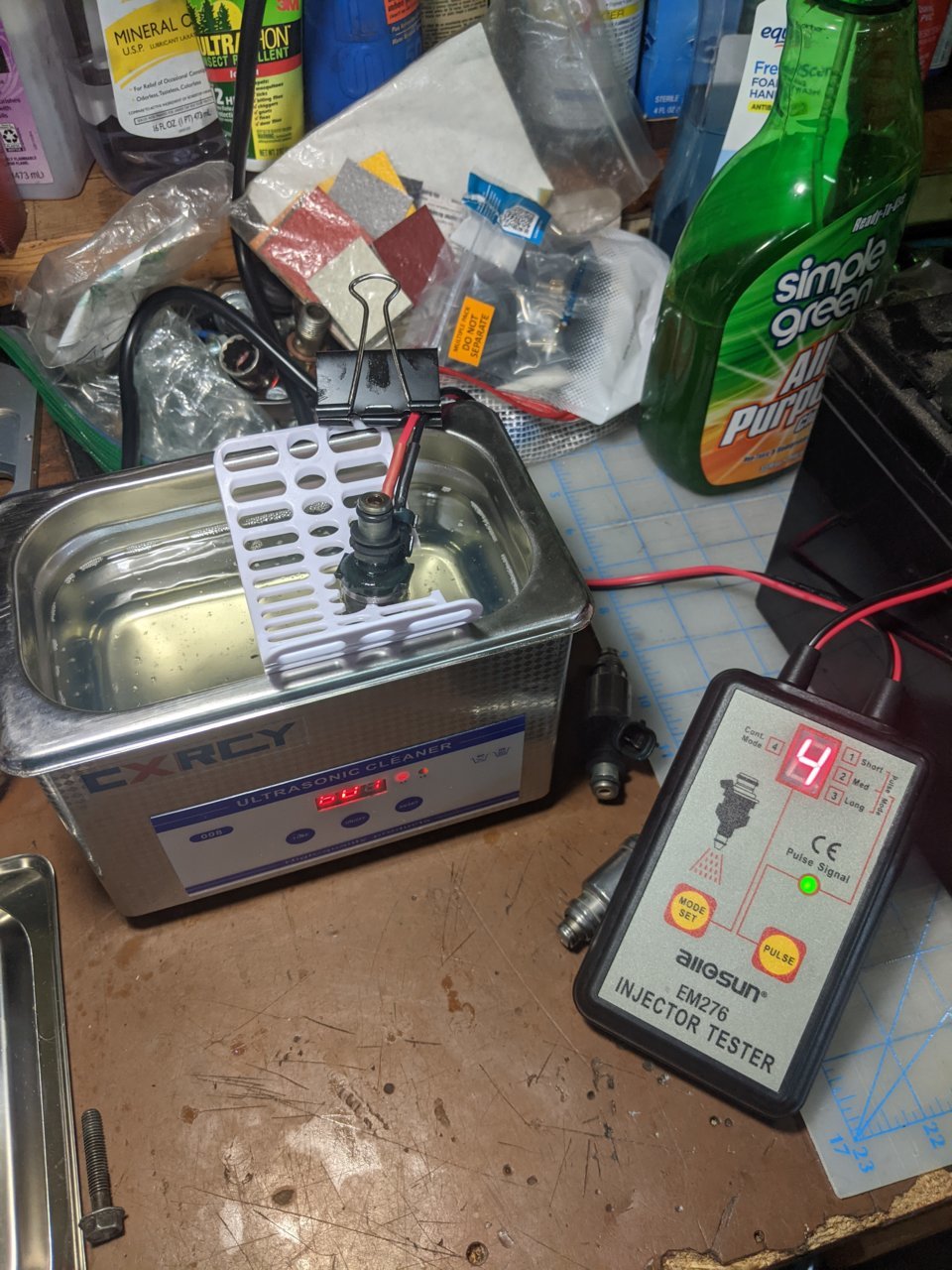

    Quick injector question. So I'm currently chasing an issue with my v8; It starts and then stops. I can keep it running with alittle gas but it's running super rich and with my scanner I can see the fuel trims are pulling all fuel out at like -20.
    If an injector was bad would it still sound like the rest? I pulled all of the injectors and cleaned them but nothing seemed to change. I should note my fuel pressure sits perfectly at 40psi as well.
    Picture of me cleaning for attention lol

    Any codes?
    What did you recently change?
    Try cleaning the maf.
    Faulty O2 sensor? Bad coolant temp?
    Is it a genuine Denso maf? I had a ebay one and it did change the tune. Had to cough up the coin at yota dealer.

    I parked it late Feb so it just sat for a while but I did change the alternator recently.
    I'm getting an occasional maf code p0100 so I'm looking into that but what's funny is the obd2 scanner shows me the intake temp and maf readings properly so im not sure why its throwing a code when at the same time I can read the sensor lol. I have 3 oem denso mafs and swapping them made no change. I also swapped to my spare ecu and there was no change, So my next mission will be to check the wire traces. O2 seem to be reading what they should as well.
    I'm probably going to start saving for a Holley terminator x max lol
