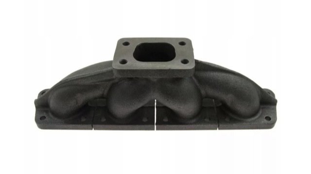

    VW/Audi t3 manifold I ordered. Getting excited as the parts pile gets bigger. $150 out of Poland is worth the gamble of fitment.
    Head gasket, head bolts, oil pan, rod bearings, turbo manifold, 19# SMF(5# lighter), RS4 clutch kit known to hold 400/400 easily. To be robbed off of Jetta: front mount IC, oil pressure regulator, oil feed and return lines, water/meth setup, EGR gauge. To be ordered tonight are motor mounts, tranny mount, and stainless exhaust valves.

    You really have a resourceful knack for making great progress on a budget.
