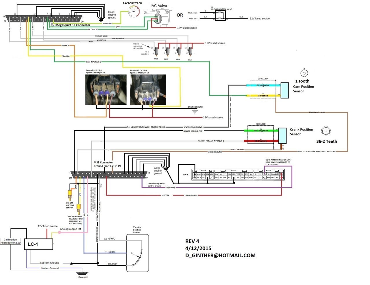

    Ive seen Chris at Paddock Motorsports say 12psi and you dont need to open the motor up. It may have actually been 14 but im erroring on the safe side. Hes probably the guy to call and talk to about Megasquirt as well. They sell a kit and can tune if you need.
    I think I commented on your post on facebook and was refering to urd's pigtail not the mass air flow timing manipulator.
    This is what they told me I would need, may be different for yours. https://urdusa.com/type-d-plug-n-play-harness/
