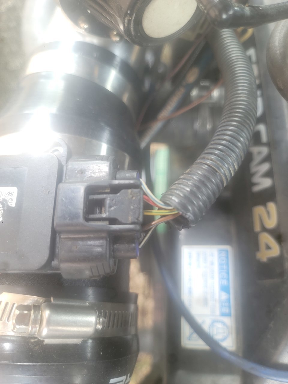

    Happy 4th everyone. So ive ppsted here before. Same truck different motor new problems. Turbo build with ftc1 and r4 software, BOV delete. Truck starts and runs great for about 10 seconds, begins to chug as if its misfiring. Then eventually stalls. Plums of black smoke. Lambda reads 1.001
    With a 4° timing advance. Recent MAF sensor wiring harness swap and new sensor. New crank and cam sensor. It runs better when i retard the injector flow. But it still cuts out at 2800 rpm when idling. Im about to throw in the towel here.

    If your lambda reading is in volts then it’s crazy rich and explains the black smoke. Is the MAF sensor sized correctly? IE: too big and it can run crazy rich during open loop. Could have an injector stuck open as well. Maybe try some new, or good and clean(ed), plugs. Let it run until it chokes itself down then pull them to see if one is extra sooty.

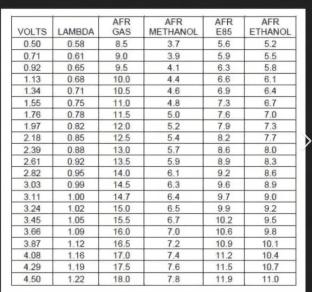

    Here is a lambda to AFR chart. As @Brake Weight mentioned above, for us to all be on the same page, we need to know exactly what it is. Just ruling potential incongruencies out.

    Motor swap with a junkyard donor. I have yet to get it running perfect. Its been stalling out on me since install. The harness has been cut and spliced more times than id like to admit. The Maf sensor had ro be rewired because the one oreilleys sold me wasnt the correct one and i was throwing the maf and intake air code. Im wondering if its still not wired right or a combo of that and a bad o2 sensor. What should my obd2 reader show me for bank1 and bank2 sensors along with the MAF values? Did i mention it wont accelerate past 2800 rpm in neutral

    Any pics of the MAF setup? I have the wiring diagrams for your truck.

    I have the OEM part number for the MAF from a 99 that I can go look at tomorrow. As far as the O2 sensor goes, I do not have the OEM part but I do have Bosch sensors off Amazon. My truck is narrowband. Also I believe the supra MAF is only an upgrade for pre 98 trucks iirc because they had the restrictive MAF. 99 and on used a fairly open MAF like what you should already have.
