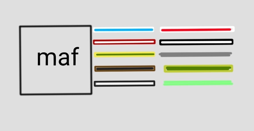

    The truck doesnt even want to start now. This shit is going to give me stroke

    And if the pinout changes every year doesnt that mean the sensors are different between vehicles as well.

    The pin out may be different but if it has the same number of wires I would think it would still function as supposed to. 0-5v, IIRC, is nearly an industry standard.
    Will it run with the MAF unplugged? Essentially MAFless. Most German programming will use a default fuel map when the MAF sensor fails.

    So i came up with this diagram, im not seeing how you obtained yours. Nevertheless its not starting with either configuration

    I may have the 1st pin on the MAF wrong. I may need to do some real world testing instead of just armchair guessing...Sorry friend.
