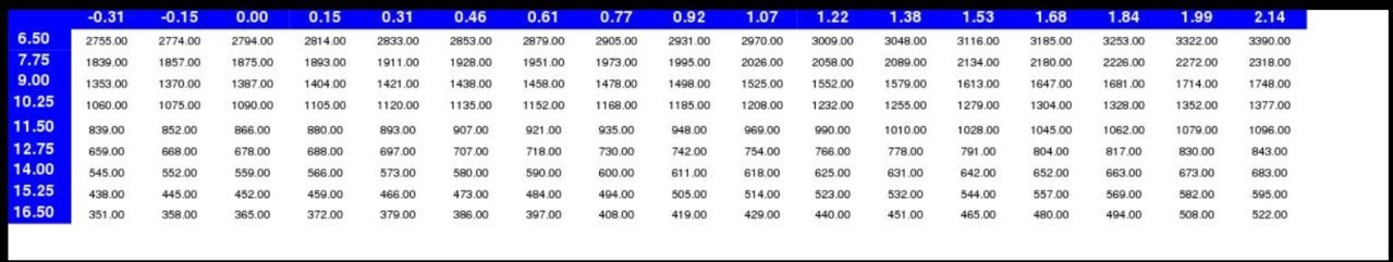

    Found this on an RX8 forum. Maybe I might be lucky.

    It's actually Denso 23250-74200.
    Last year I tried getting a table from Denso. Denso doesn't make injectors anymore. So yeah that table above might not work for me since I have a toyota injector.

    As long as you know the flow rate you're going to have most control of your table even without the proper dead times put in. Dead times will mostly affect the lower end of your table and how stable it is at maintaining AFR. But you really shouldn't notice any issues at idle and you shouldn't notice any issues at all at wide open throttle. You just really need the proper dead times for getting stable control in the mid and low range of pulse width. So you could probably find some other Toyota injectors and start with those dead times as a baseline. Might I suggest looking at the dead times of the built-in maps that come with the haltech units. There might be something in the Mazda or Toyota sections that can help you

    Cool thanks. Sounds like I'm just over analyzing my injectors. I do like having a smooth idle and bottom end. Maybe eventually I'll do some 1000cc injectors because I'll max these 550cc out pretty soon.

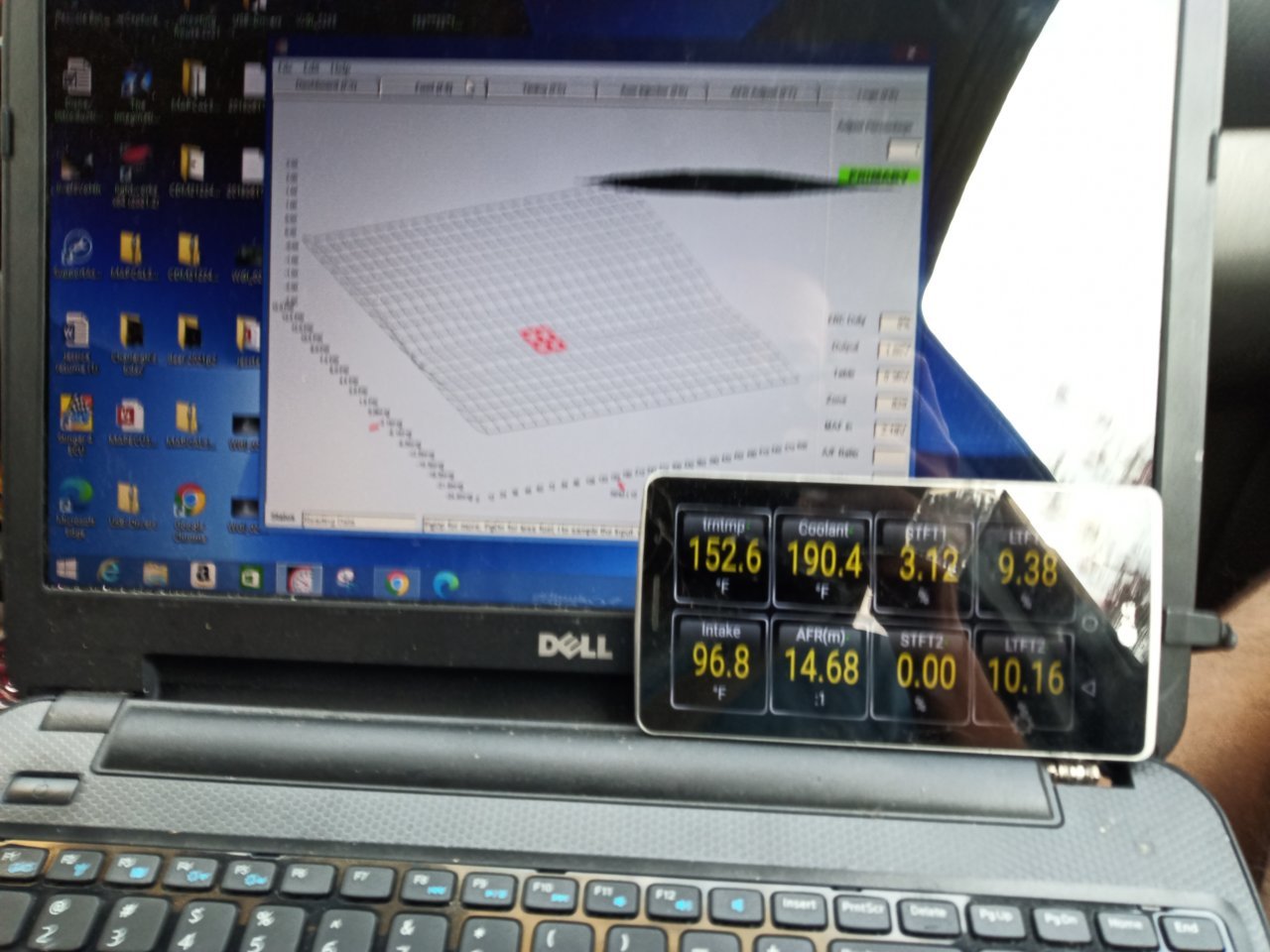

    Substantially easier to tune when someone else drives... Boobs don't hurt either, been driving for years on a "kinda ok" tune and now I haven't seen anywhere that my left get above +-8 in just one quick drive to town.
