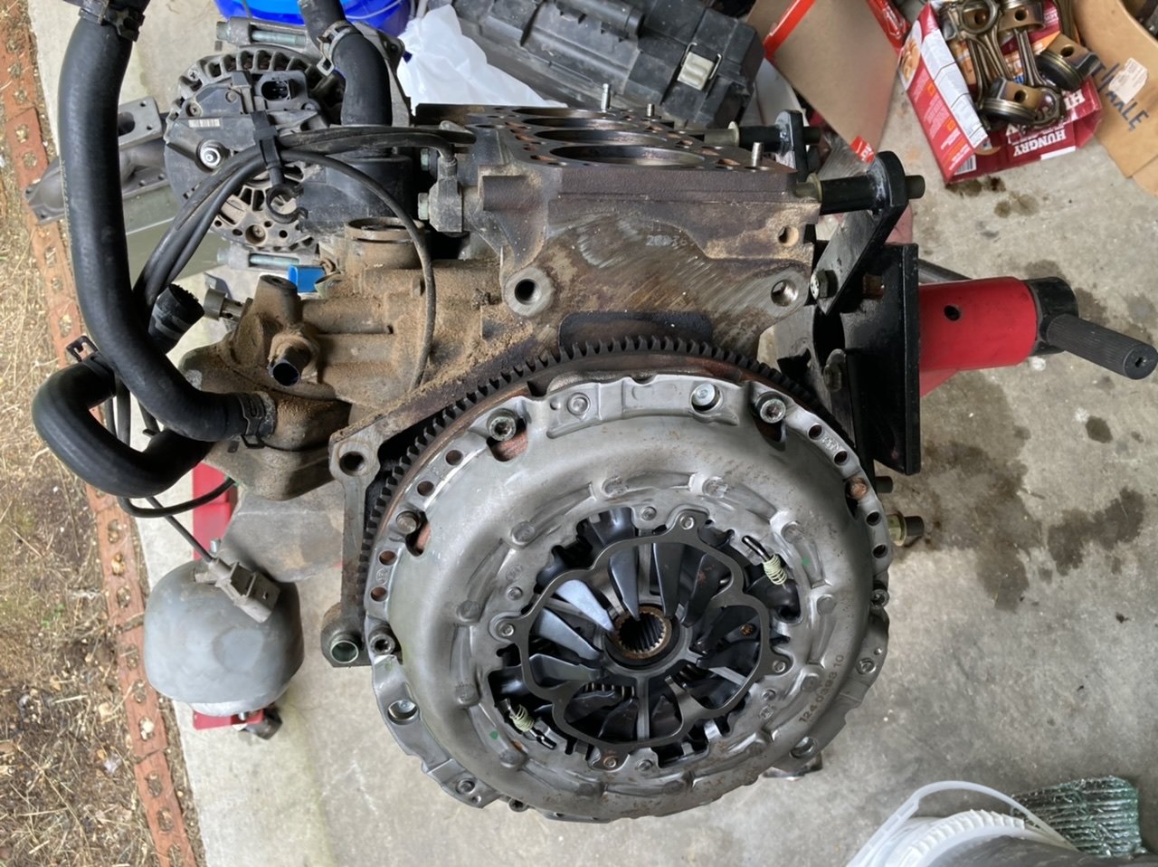

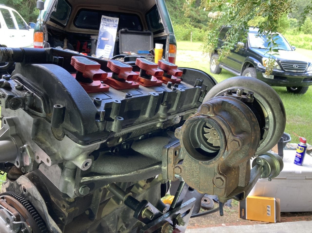

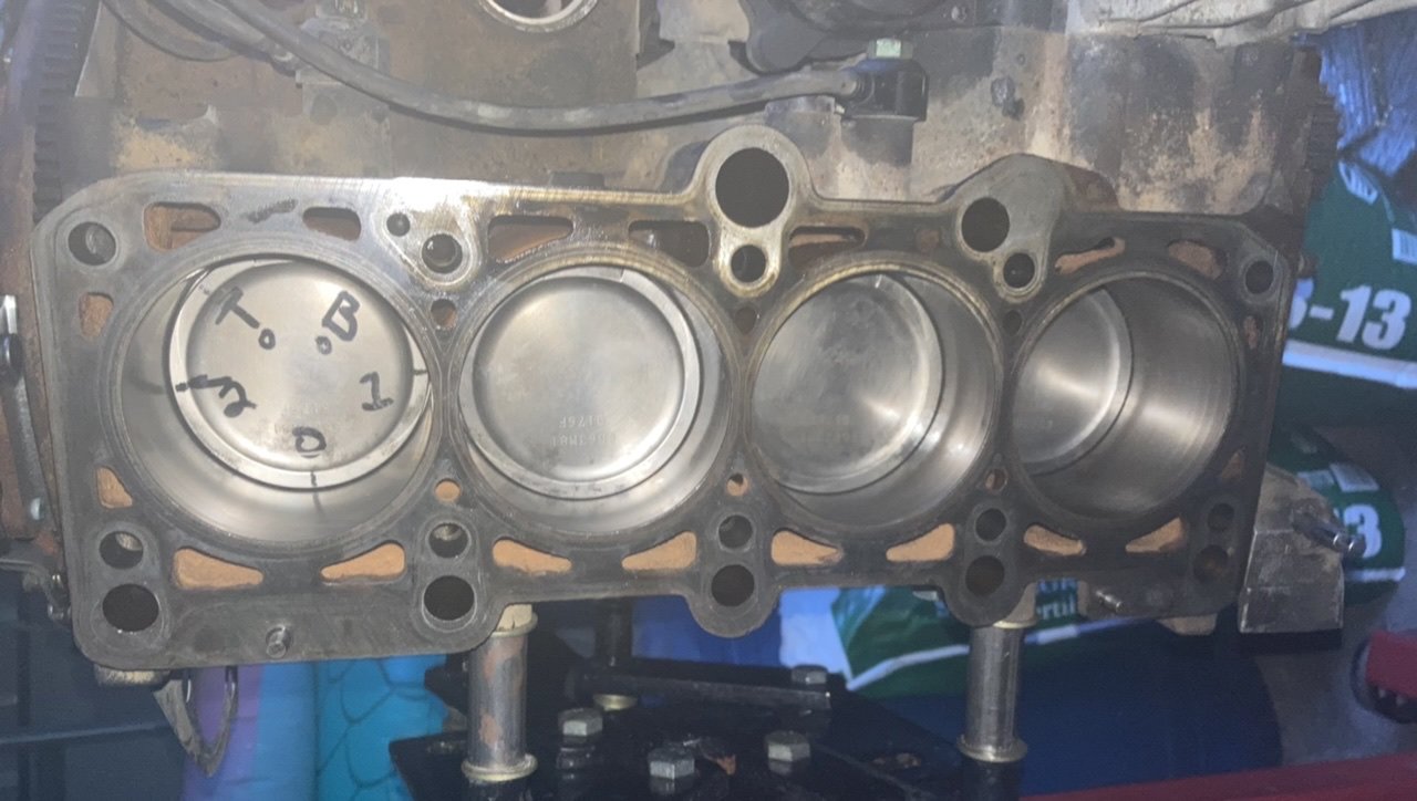

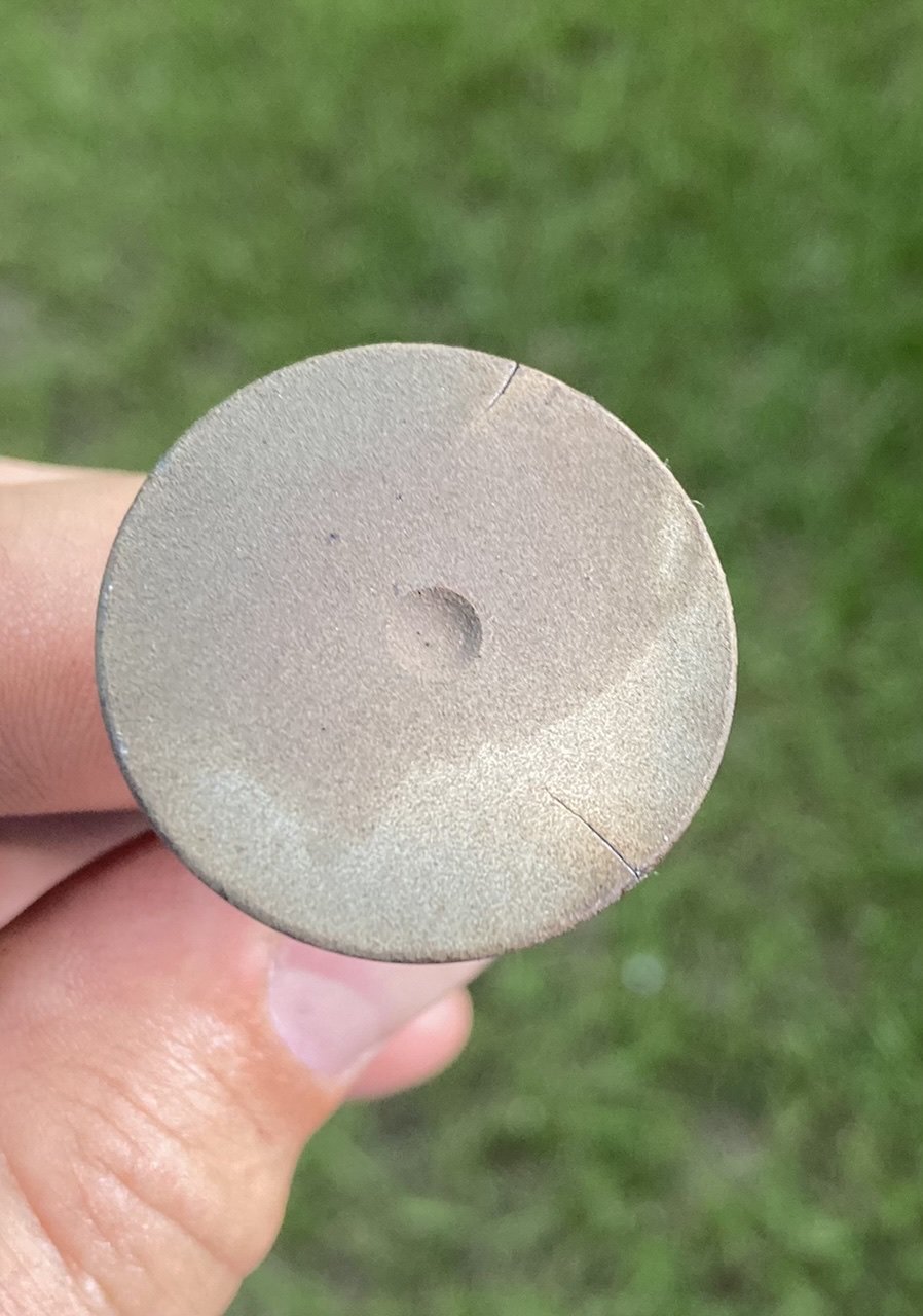

    Did exhaust valves and seals today. Only eight of them but was a major PITA for me. I finally got the hang of putting the keepers back in after the first 3 and 2 hours of cursing. Found one valve on its way out. Went back with Supertech stainless. Used a pistol grip wood clamp, 3/4” PVC, and a random bits of bent zip ties and a magnet.
    Put my slightly used Wiseco pistons and forged rods in. New rings and new bearings. Made 4 passes with the dingleberry for a quick cross hatch double helix.
    Drove out the old pilot bearing and put in a new one. SMFW and B7RS4 clutch set.
    That was all today. Yesterday I prepped the block for delivery of rings today. Also awaited delivery of a SST to hold tension on the VVT tensioner. Also yesterday I Frankensteined the lower valance back together.
    Tomorrow I hope to have the engine together and tranny reattached. Hopefully sitting in the engine bay on motor mounts. Will be awaiting delivery of a Chinese cast aluminum coolant flange to replace the 20yo German plastic piece I ripped in half with a tractor.

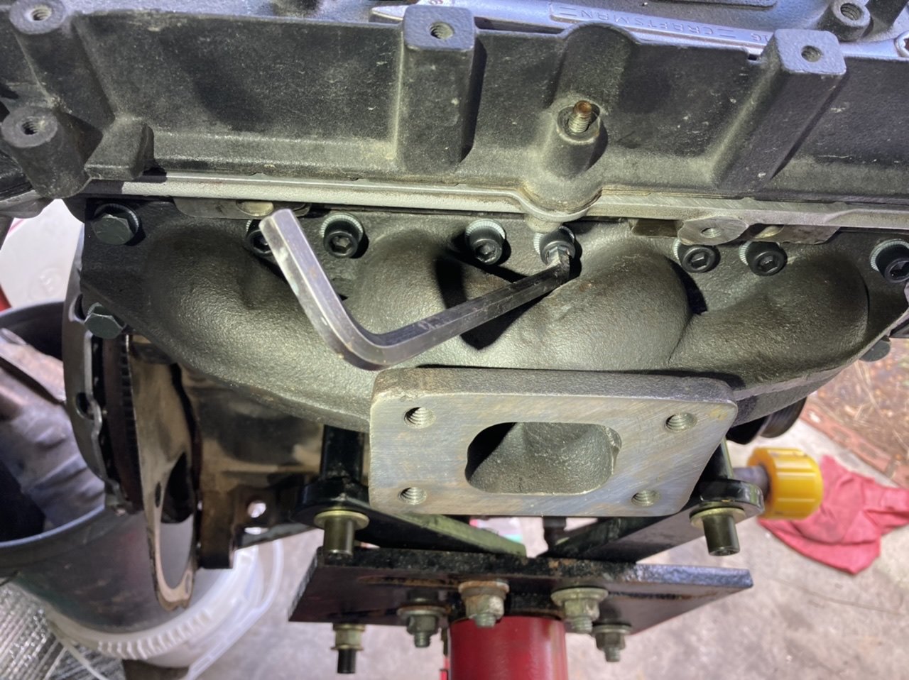

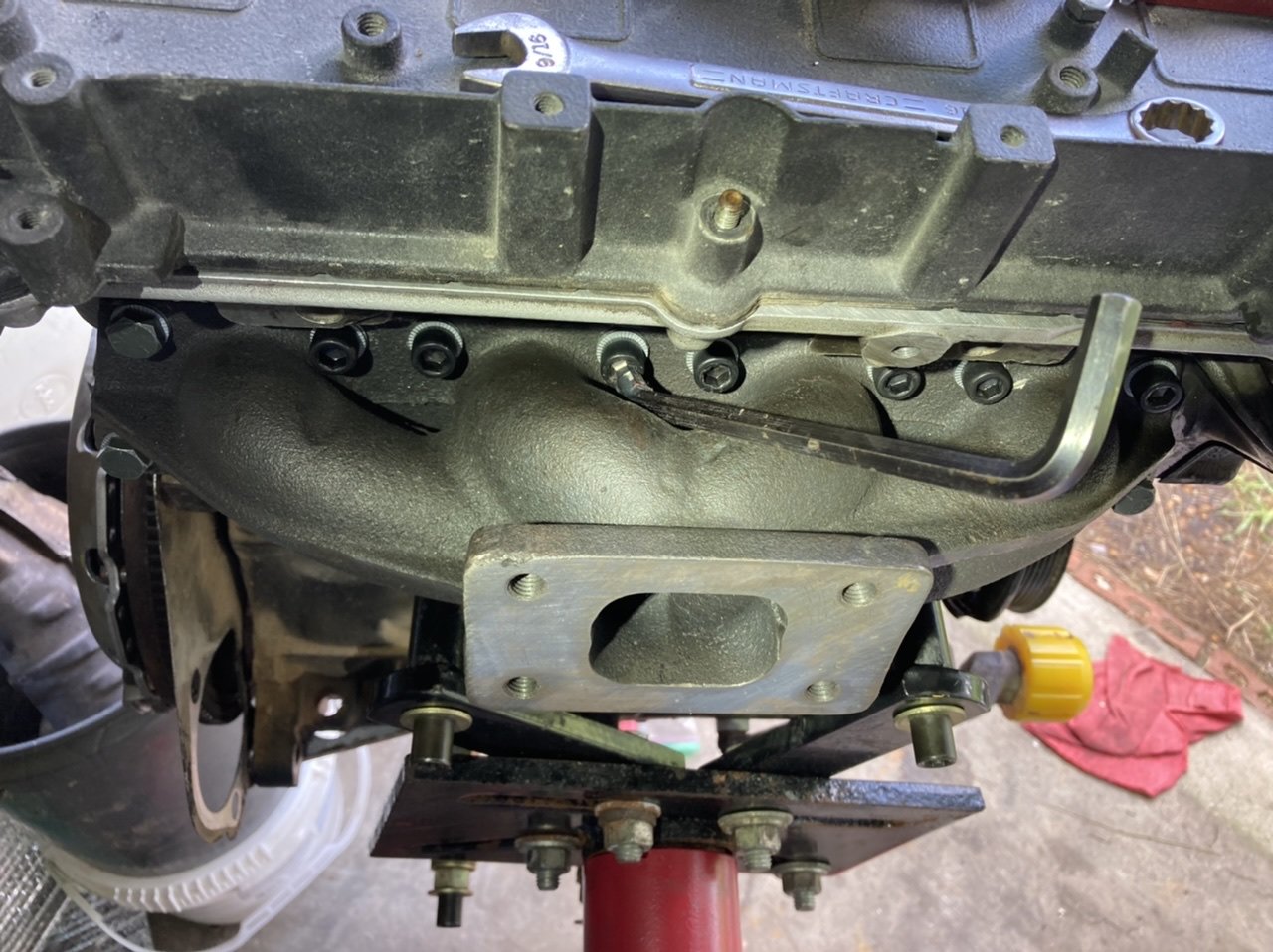

    Oh, yeah. Also yesterday, I drilled and tapped the head for 3/8-16 exhaust bolts. Custom made the proper length bolts and 2 studs from a sack of tractor supply bolts. Drilled the turbo manifold to 7/16”. Made sure I had at least 20mm of hole depth and 18mm of thread engagement. Made sure to cut bolts off for 15-16mm of engagement when using the slim nord lock washers and through the manifold. Drilling and tapping head holes made me a bit nervous. Especially since I was freehanding them. I was able to drill press the 7/16” mani holes.

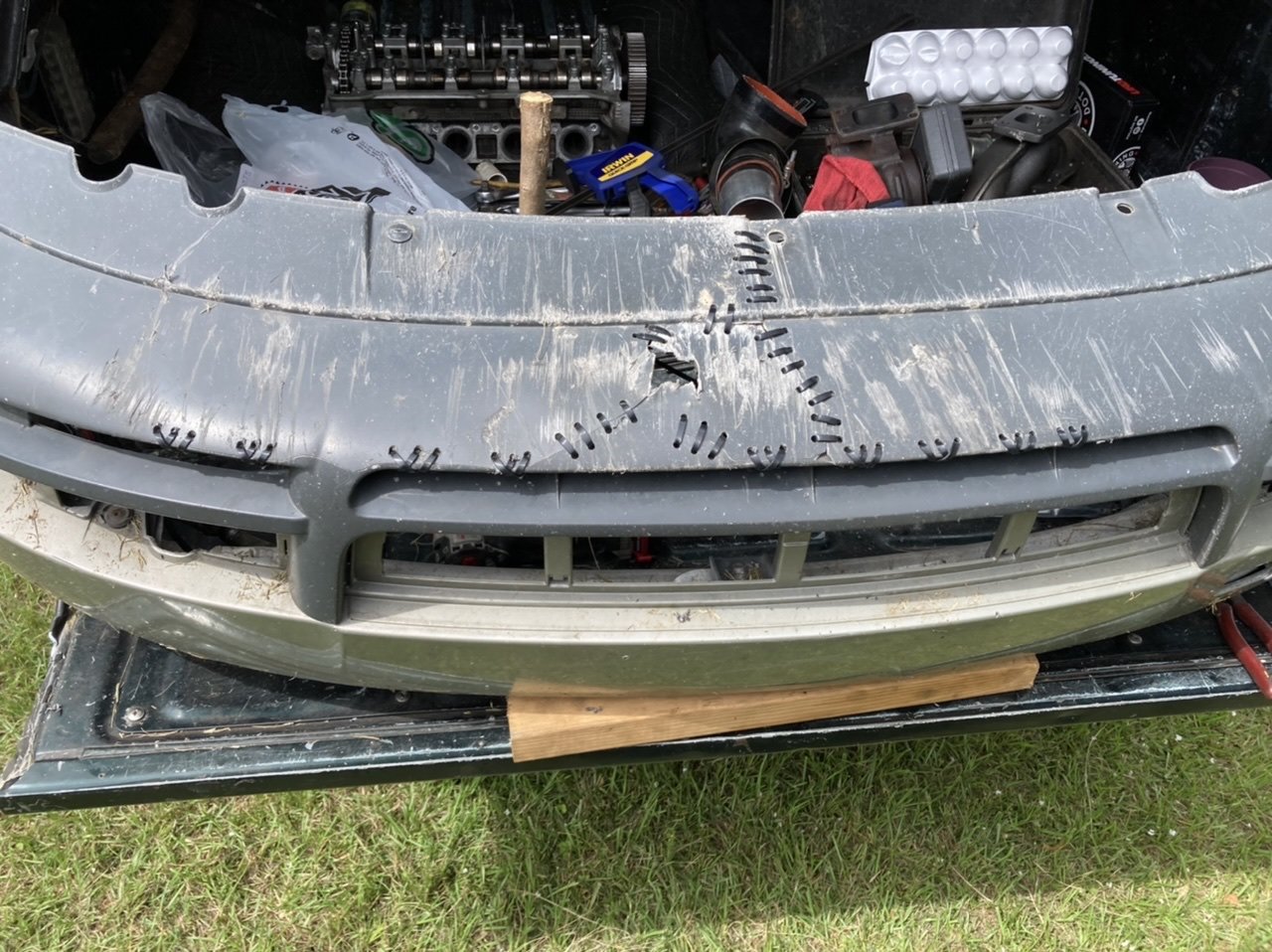

    ^^^ This! My God man. You have been busy! Frankenstein would be proud of said stitching!

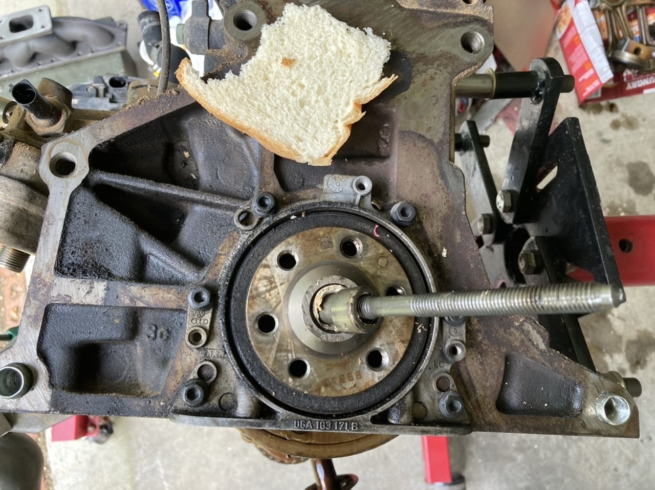

    Did you really use wet bread in the pilot hole for a Non Neutonian fluid replacement, or am I just assuming things at this point?

    It was dry actually. Make marble sized balls and drop them in. Find something that nearly matches ID of bearings and beat in with a shop hammer. Compress air out, add some more balls, and beat again. Will work every time as long as the ‘found’ tool is almost the same size and the bread level doesn’t exceed about 1/4 internal height of bearing. Grease is messy and actual pullers get used how often unless you run a shop?

    Well I must say that was creative thinking. I normally used toilet paper and water to do them back when I didn't have the right puller for those tiny pilot bearings.
    Good job.

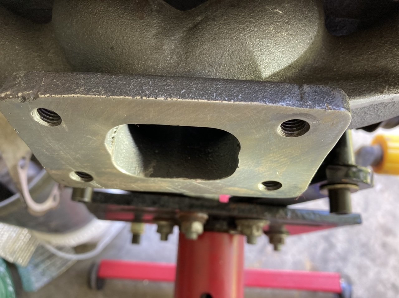

    Question. I bought a small sheet of glass at Lowes and then stuck some sandpaper to it. Then I polished the t3 flange in hopes of getting a perfect seal. I’m going to try it without a gasket and see if it holds. Anyone done similar?

    You'd probably want to use a wedge lock washers if you forgo the T3 gasket. You'd want your flange to be slightly like this )(
    When you torque down the flange you get a spring like action to account for heat expansion and contractions.

    I’ll be running nord lock. Have had great luck with these not backing out through heat cycling.
    I’ll be knocking at 1400-1600* and likely 50psi manifold pressure. Couldn’t hurt though to seal the micro grooves.

    If you have both sides true and flat then put some grease on it (I know it sounds weird) but when that stuff gets super hot it will turn into a DIY carbon gasket.
