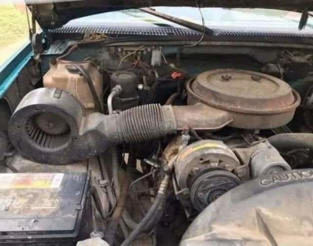

    That go in the "what the hellcat?'

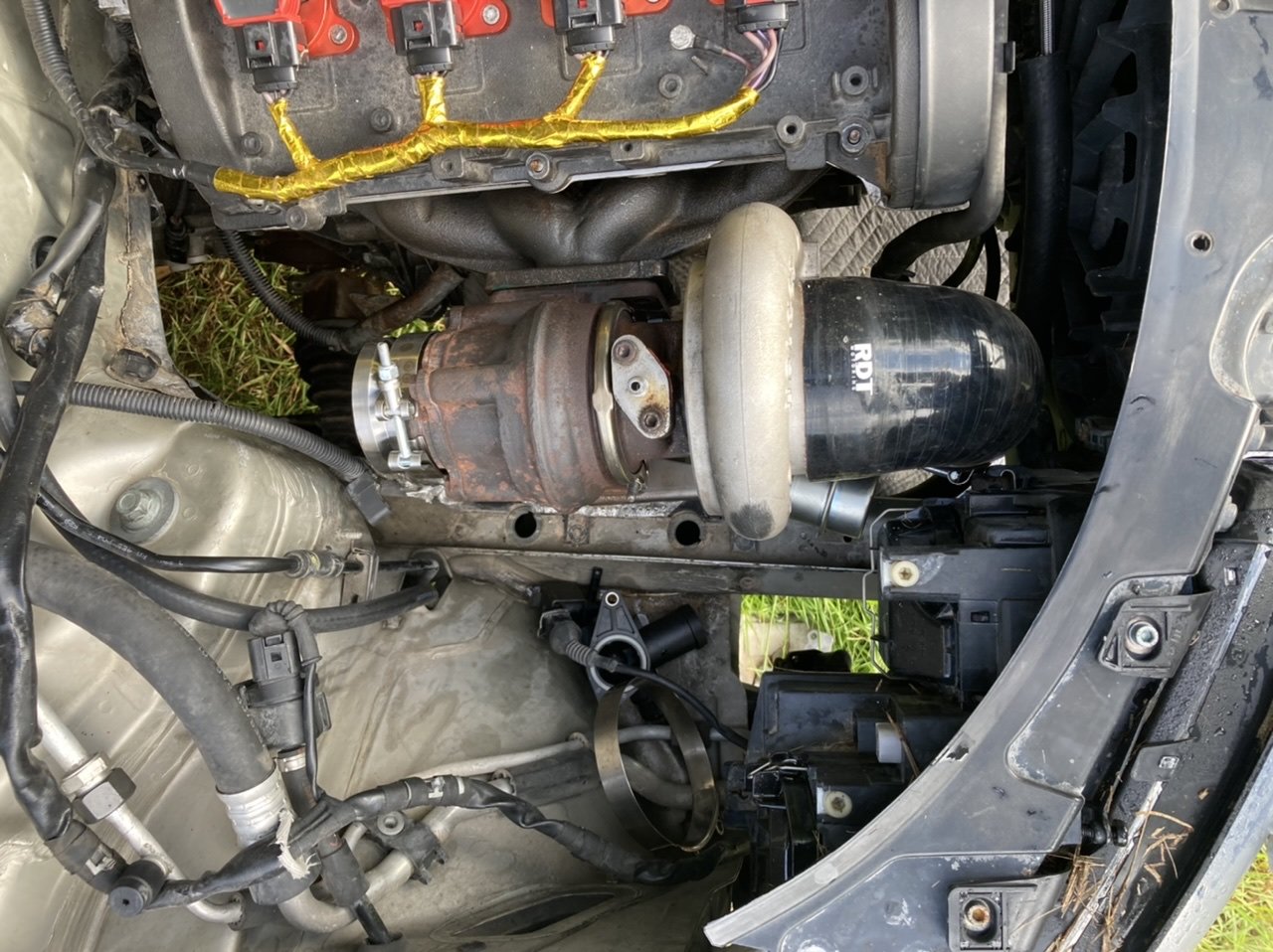

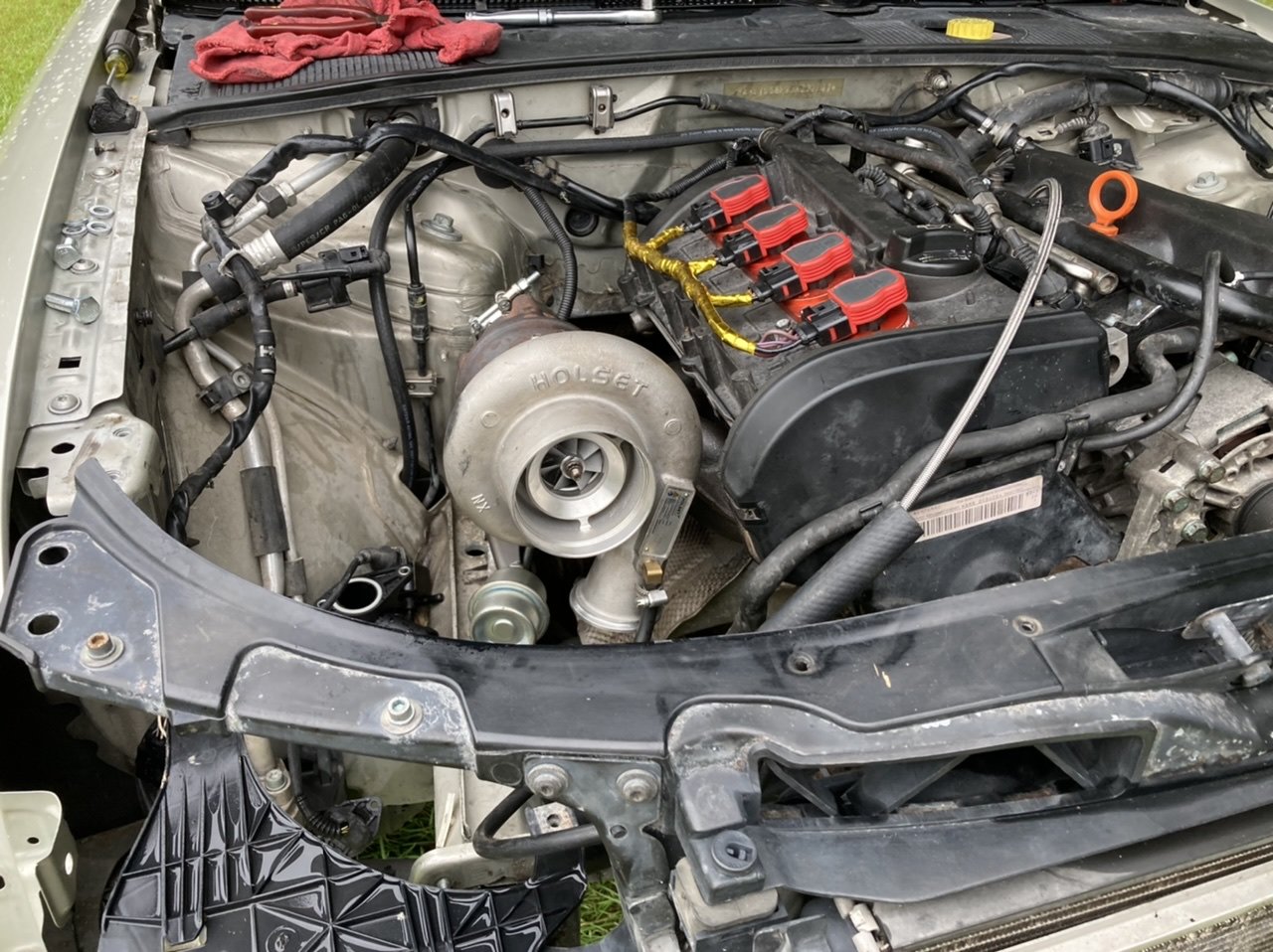

    That’s where it sits for another week. Ordered stuff to fab a downpipe and to do the intake. OEM airbox won’t fit so I’ll get some aluminum plate and see if I can’t rig my press up into a brake to isolate the heat using a cone filter. Also looking for some bigger injectors as per tuner. 800+cc but I don’t want to spend $400 or more from them plus the $6-700 for tuning it. According to them my 500cc will lean out but I logged 80% IDC and a 0.8 lambda on my Jetta with same physical setup but 20psi tune. But it wasn’t tuned for the extra 10psi of boost and pulled hella timing…yet logged good fueling numbers. I get 3 revisions through them with the initial cost so may just send it and see. Also looking for a bigger core front mount intercooler that doesn’t require a lot of inner bumper trimming.

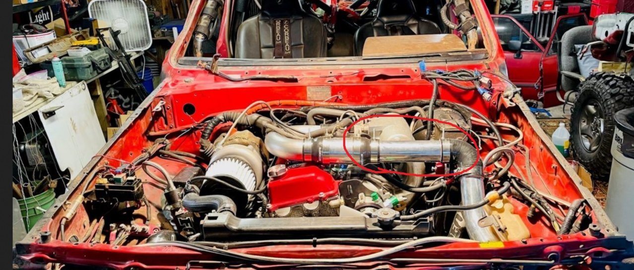

    what would cause a MAF sensor code on a on a new OEM sensor besides a bad sensor or wiring issue?
    2rz with a 54mm turbo, pinks, and right about 7psi..

    What is the code, and got a picture of that engine bay sweetness?

    Just a general MAF code. Ill have to recheck the number this evening. its cleaned up a bit more than this. shits everywhere. lol

    Any tuning?
    Stft and Ltft may be at the limit.

    Is that MAF adapter tube the right diameter, they need to be in the diameter tube they're designed for.

    No tuning yet I just barely got it running. Yes that is a 3" MAF adapter in the middle with the reducer to bring the ID down to 2.5" or so. I know there have been issues with those with other builds.
    The only thing I have done is added the Pink tops and limited the boost to 7 with the wastegate spring in the Turbosmart 45. Turbosmart Adj. Fuel pressure regulator set to 45psi. The MAF code is the only one I am getting currently.

    Sometimes the inlet pipe I have circled going to the maf can cause issues. Make sure the small pipe isn't too far in the coupler. I have mine end right at the t clamp. You want the air to diffuse by following the coupler. It is like having a water nozzle pointing at the maf. I made a honeycone air straightener before the MAF on mine. I now can peg out the maf sensor to max voltage. A 3 inch pipe leading up to the maf is best.

    awesome. I will re-check that tonight. I may need to find a better solution for the 3" MAF adapter.

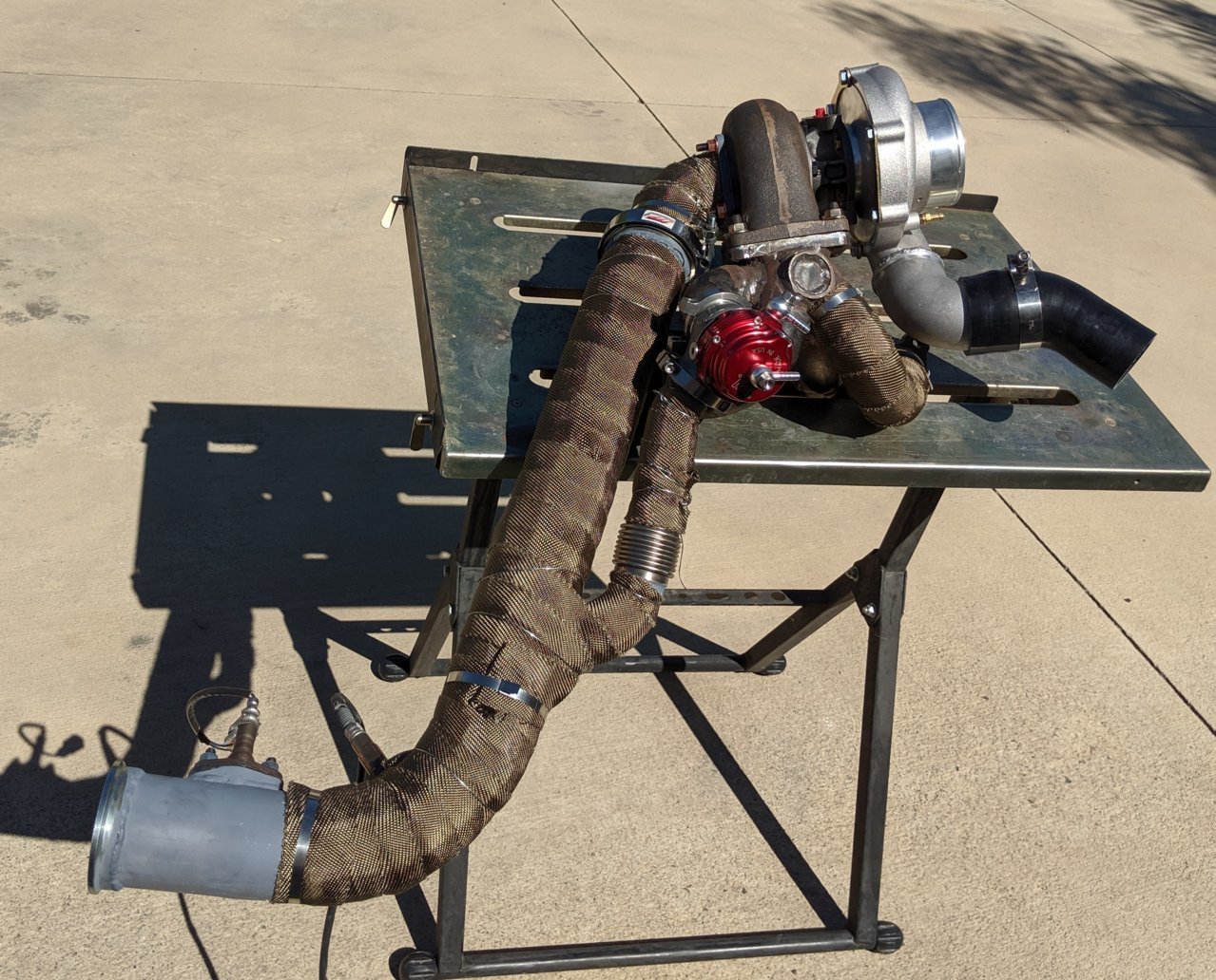

    While we are at it, how far down the down pipe does the O2 and Wideband 02 bungs need to be placed? and in a staggered orientation correct? I'm still in the wiring process currently.

    18" is the typical minimum, try not to have them inline with eachother, don't put them upside down, water kills em if it can stay in them

    I did mine like this. Can't tell but they are clocked differently.
