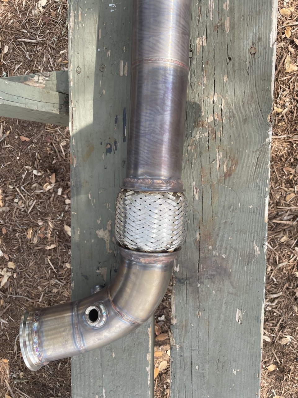

    Here’s a pic of my downpipe. Section below the flex was not wrapped. Area above was wrapped. Pretty good visual imo

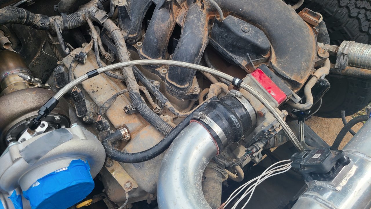

    So I checked the upstream IC piping. It was too long as previously thought. I trimmed it to the correct length. P0100 code is still there.
    This is the orientation of the sensor in the MAF adapter. Seems correct from what I have looked at online.
    A032ED3C-8E6D-4470-9736-DB213314BD85.jpg F6B89B40-0021-4516-B4C8-9C9BE402BFD9.jpg
    is this correct? Only 3 things could be wrong: orientation of the MAF, bad sensor, or wiring correct?

    No, could be more. Those are good places to look though. It's probably something simple, just have to think about how the ecu wants to see things.
    Bmc leak was mentioned, among other vac/pressure leaks.
    How is Pcv/crank vent ran?

    Not sure if the sensor is the same as the 2nd Gens, but mine is the opposite orientation. Harness plug facing the engine.

    Negative, Every vacuum hose was connected.

    Rz motors are this direction. His is correct.
    It's either maf sensor, wrong insert in housing, or wiring with that code
