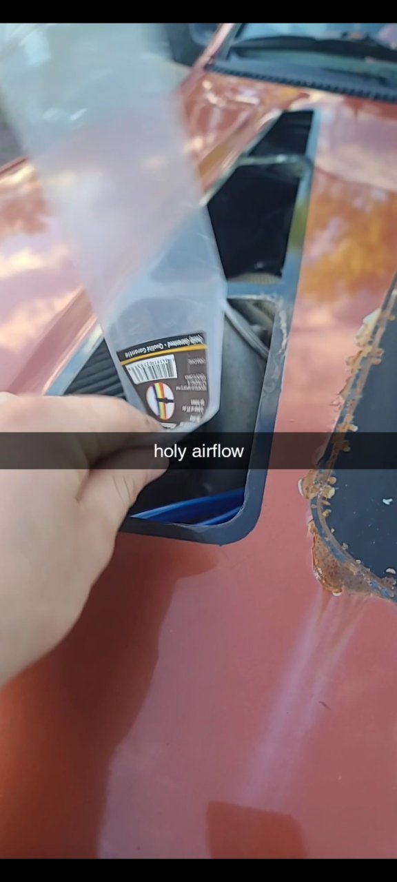

    cant post video but those holes allow an insane amount of airflow when the fan kicks in!!! actually took me by suprise. considering my truck has fender liners removed so its less restrictive under the hood then the fan must have a decent amount of pressure to push against to get air out of the engine bay. with skid plates and wheel well liners in place the only real place for air to go is around the trans tunnel which really isnt alot of space

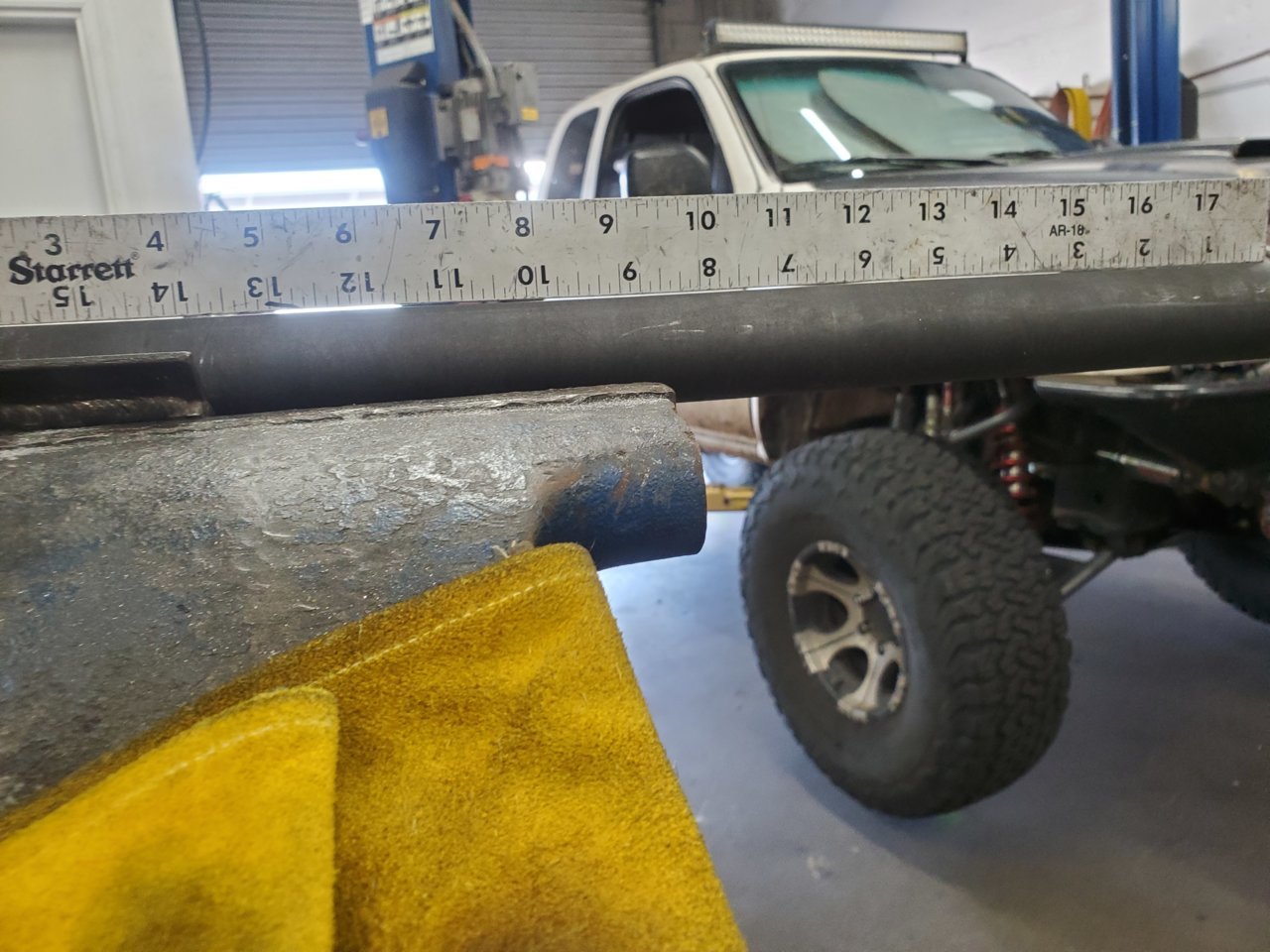

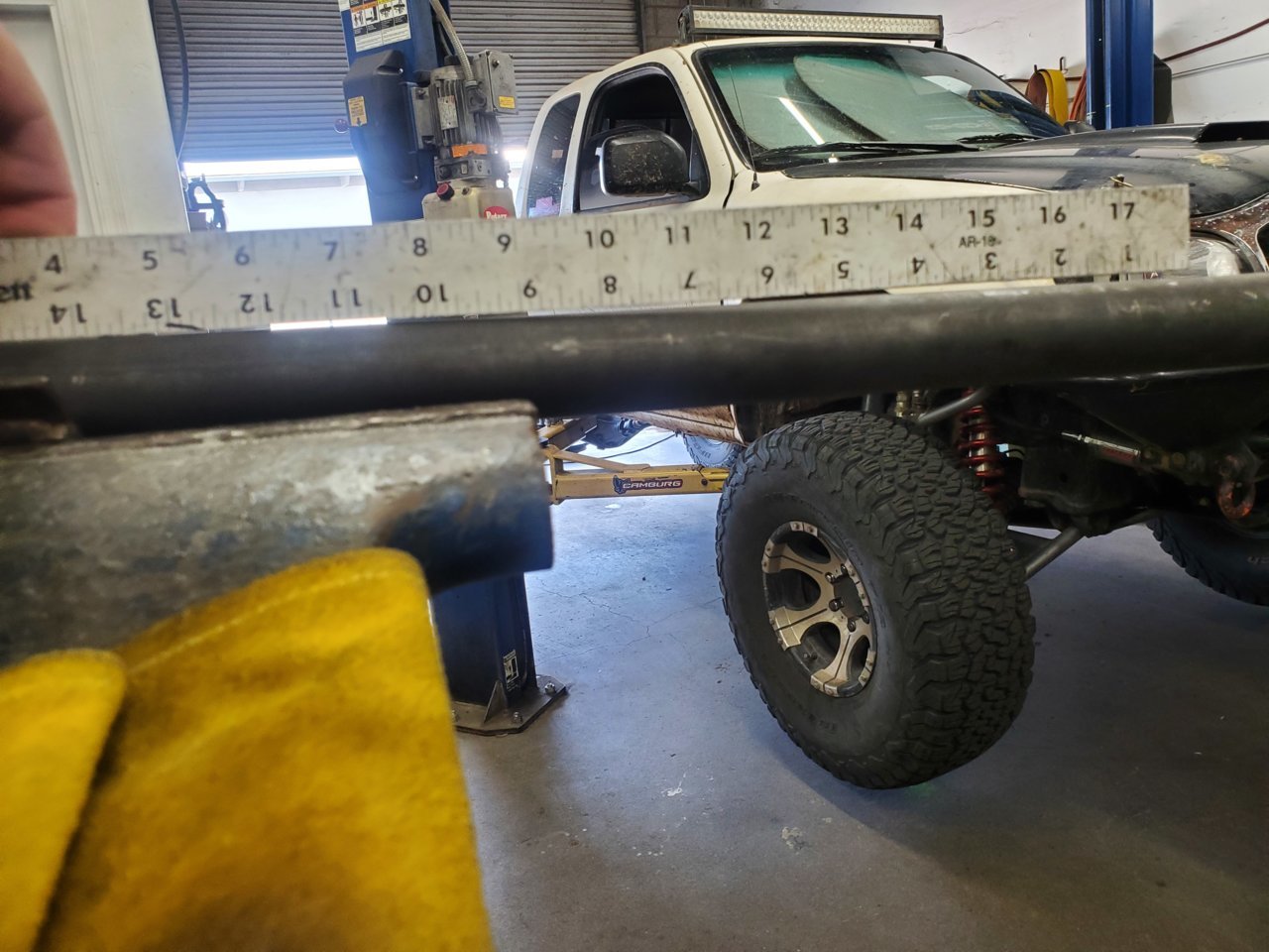

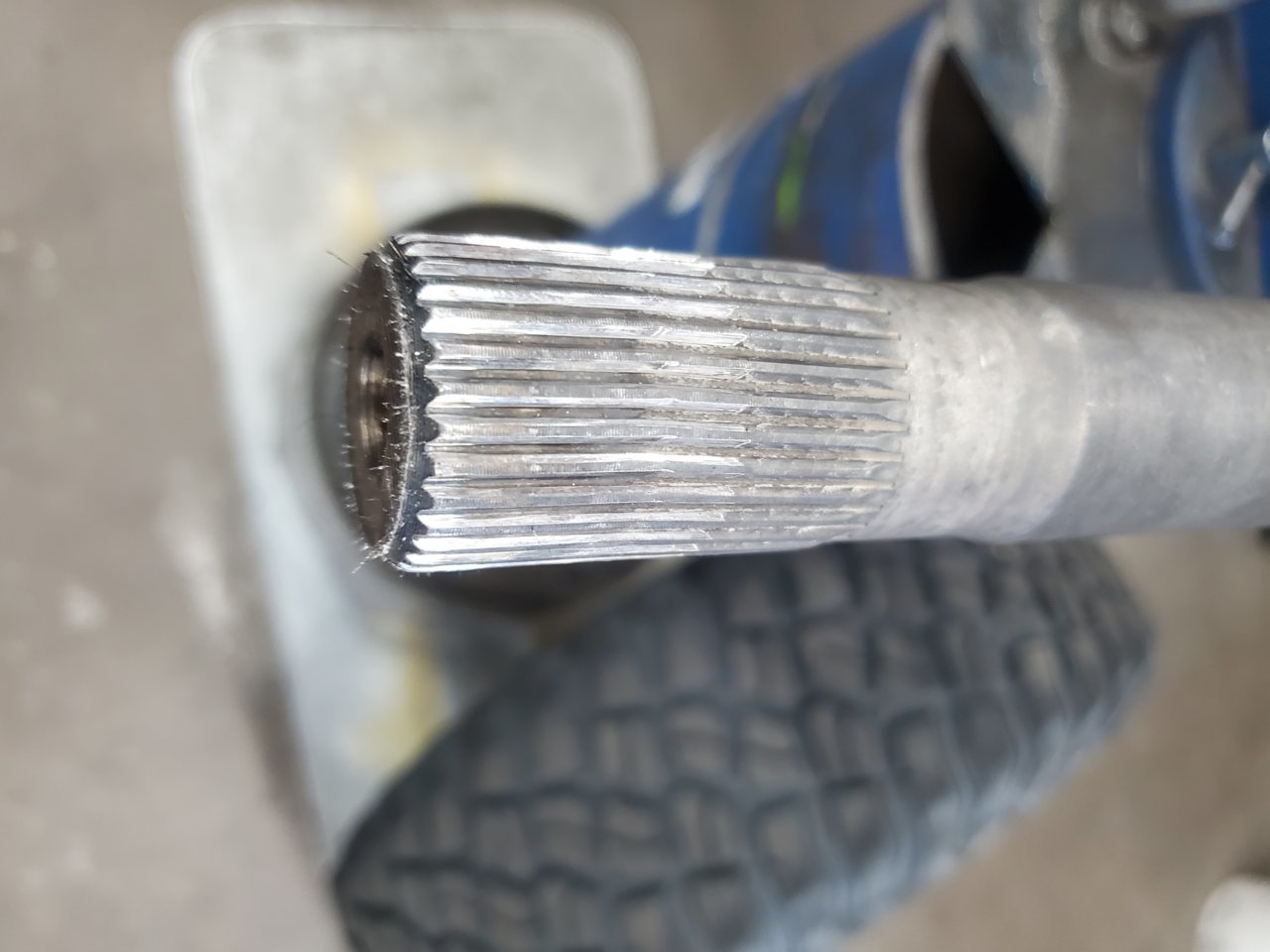

    Slid into a hair pin with too much sauce and hit a outside dirt wall with the wheel. Thought I bent the rim but the drum still spun funny. Junk yard axle swapped in. Ps. Abs and non abs axles are different on 1st gen. I flipped the new axle seal over so the lip should sit on the collar. Forgot to check diameter between them. T100 trussed axle build will now be given green light incase this fails.

    Front CVs and knuckles are the same between ABS and Non. Non ABS knuckle has a little spacer that takes the place of the speed ring in an ABS knuckle. A squirt of silicone in the sensor wire hole and it’s good to go. But a Non ABS knuckle won’t have appropriations for the sensor wire and the speed ring can be used as the spacer if it gets lost…ask me how I know and why local NAPA won’t be pressing any more bearings for me.

    This was the rear axle.

    Time to save up for a big boy axle. Good chunk of torque was applied there.

    Need a straighter ruler :thumbsup:
