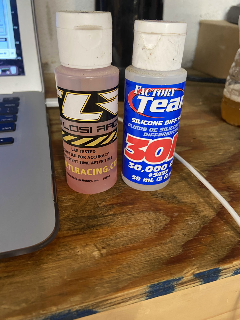

    If anyone wants to see the bottle @Brake Weight was referring to.

    Its not hard to change the fluid. I think its some 10mm bolts to take the clutch apart. You have to make sure the quantity added is equal to the quantity removed. You can go thicker or thinner, depending on what you're wanting. I moved to electric fan because you can just turn dials to make things behave how you want vs messing with fluids, taking the fan clutch on and off etc.
    This is the stuff I used:
    https://www.associatedelectrics.com/factoryteam/parts/fluids/diff_fluid/
