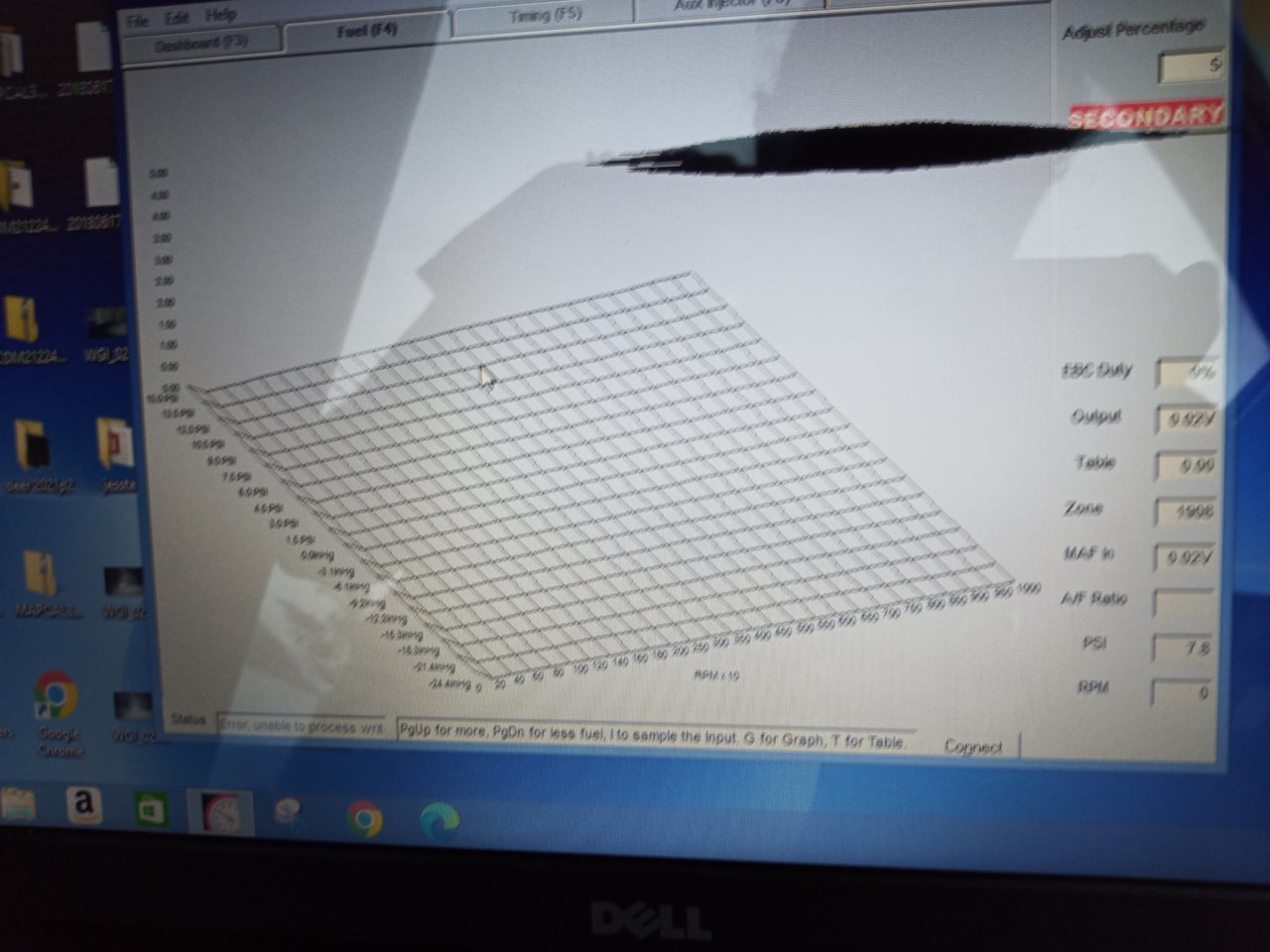

    I bet none of y'all can make 7.5 psi at 0 rpms... Anybody with a mapecu3 know what the heck is going on? It just slowly keeps creeping up, I noticed it at 1.5 last year, then 3 psi a couple months back, and the last week or so it has been running pretty bad so I thought "maybe it has fixed itself and I can tune the zones where they are supposed to be, but it makes 0 psi at idle... That's quite unfortunate IMG_20220905_183932_911.jpg

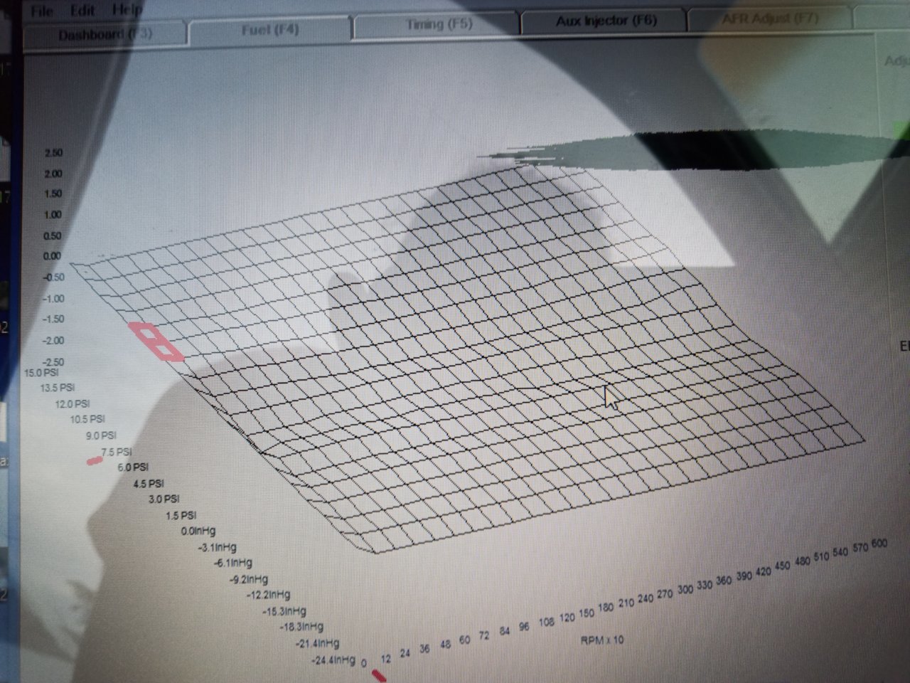

    My secondary table was all at +2.35 so I zeroed that out and noticed the graphs physical position was very different from primary to secondary... There is a noticable gap along the edges in primary that isn't there in secondary

    Make the scaling of each map match each other.

    Like -24inhg to 15 psi? I just deactivated the secondary table, but that may not have been the thing today because about a mile from my house this morning she died lol. It was running bad lean. I hitched a ride to work and I'll see if it can get it going this afternoon

    As well as RPM.

    Oh dang good call lol never noticed that haha

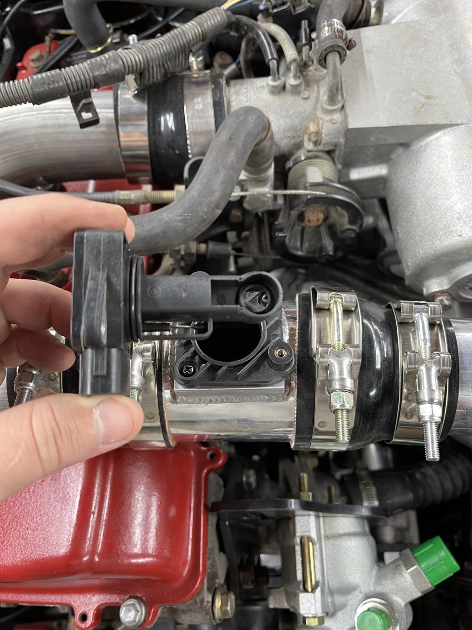

    I cleared the codes and the first thing that popped up this morning was a mass air volume something or another, so I had a space MAF sensor and thought I might could just swap them out (I was running a no namer from ebay and figured it had crapped the bed) I didn't have a screw driver on my truck but I improvised... Just too bad that didn't fix it
    I'm bout to catch a ride home and see if I can get it running again

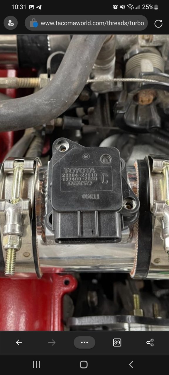

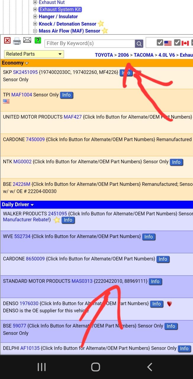

    What year is your 2rz engine and ecu from? I looked briefly at RockAuto to compare the part number of your photographed MAF sensor to those available for year models around your engine.
    Here is your P/N.
    Here is what model I found that for.
    You very well have the wrong MAF sensor. Even the 2006+ 2TR has a different part number.

    Well thanks for that. My 2RZ is an 03. Its crazy those part numbers are 1 digit off from each other. I’m an idiot.. let’s see if that clears up my race cam idle
