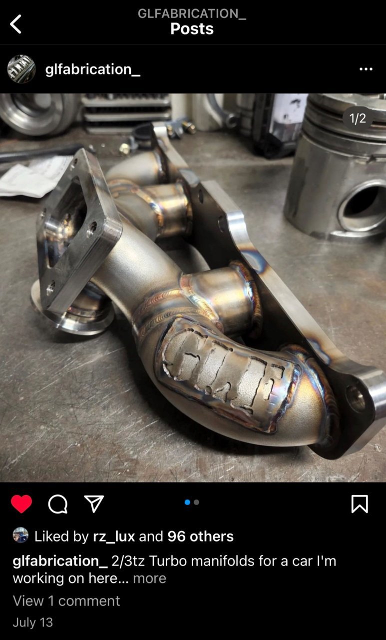

    I went with GLFabrication..
    He has a couple different variants. This is similar to the one I have.
    MadTaco461 likes this.

    How much did that run?

    $550 is what is on their FBook post.

    I think it was around $550

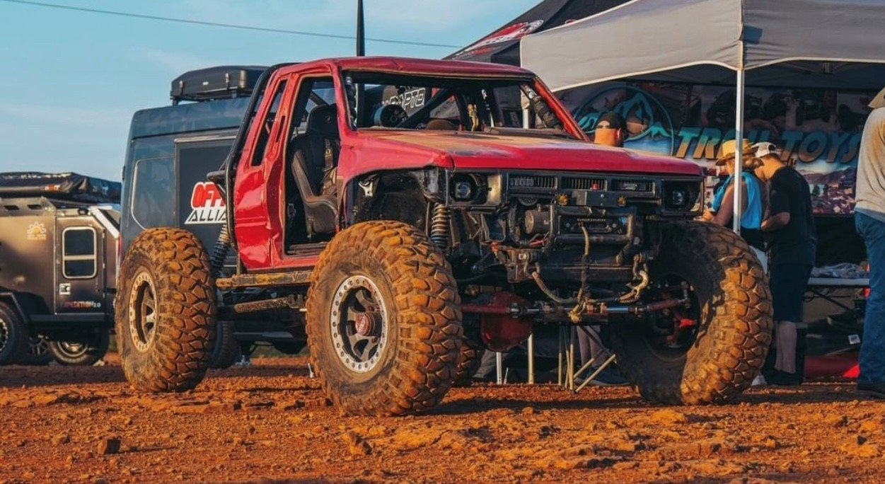

    That will hopefully be the next step. I really only undertook this swap to basically double the HP of my old 22re.
    If if gets any more serious Im cutting off the front end and tubing it out completely lol.. It was very cherry when I bought it in 2010..Now not so much.Jambo 2022.jpg
