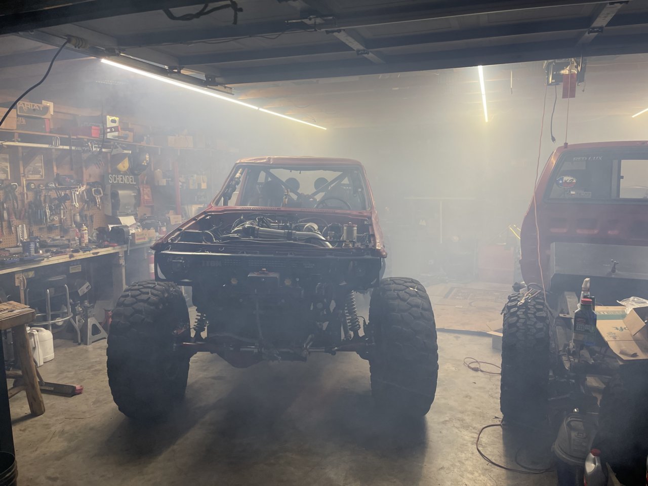

    What are the symptoms of not running a restrictor fitting on a journal bearing turbo?

    Blue smoke? Possibly oil in intake mani.

    Looks like it was a few issues. I thought the -4 oil adapter had a restrictor in it, it does not. Second issue, I needed to rotate the oil feed and drain closer to 12 and 6 o’clock. I don’t think it was draining correctly and oil was seeping past the seals into the exhaust. I corrected that and ordered a .065 restrictor for the feed line. Fingers crossed that fixes the smoke show I had earlier ha ha. FFBBB63E-4E4C-49A8-AA72-474786DD99B1.jpg

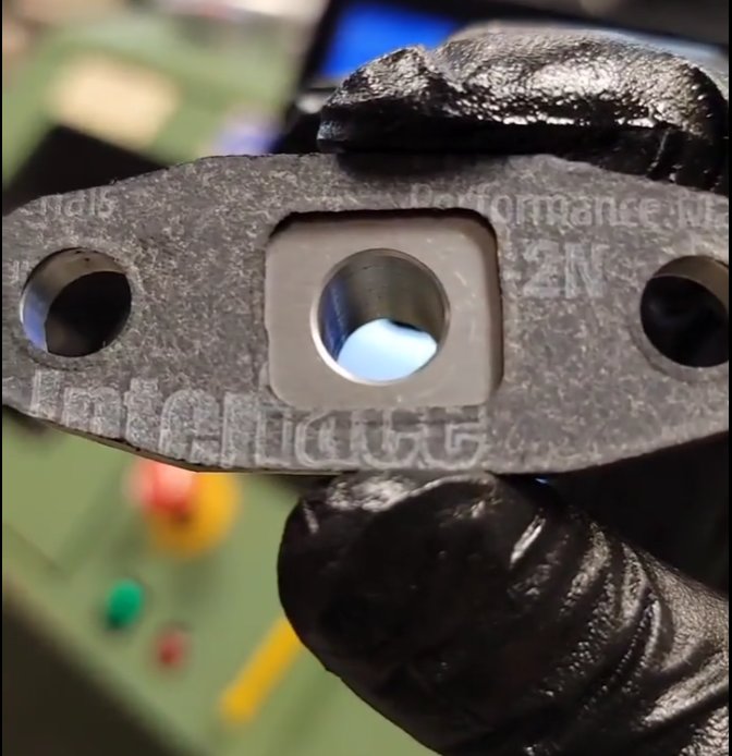

    Just because it's 10AN, doesn't mean it's actually 10AN all the way through.

    I was watching a Boosted Lifestyle YouTube video. The guy was having a smoking problem from his turbo. He was using some cheap no-name Amazon AN fittings. Come to find out, his "-12 AN" was more like a -10 AN by internal measurements. He compared the cheap fittings to the nice fittings. Lesson learned for him.
