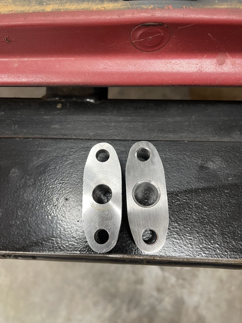

    Tried it again this evening. Looks like I need to redo the drain completely. The restrictor may help but might as well do it right the second time.

    Redo the drain first. Journal bearing turbos need lots of oil.

    There is some room to open up the cheap fittings. .475” to .575”
    I’ll use this for a contingency if I can’t get the fittings I need in time for next weekend.

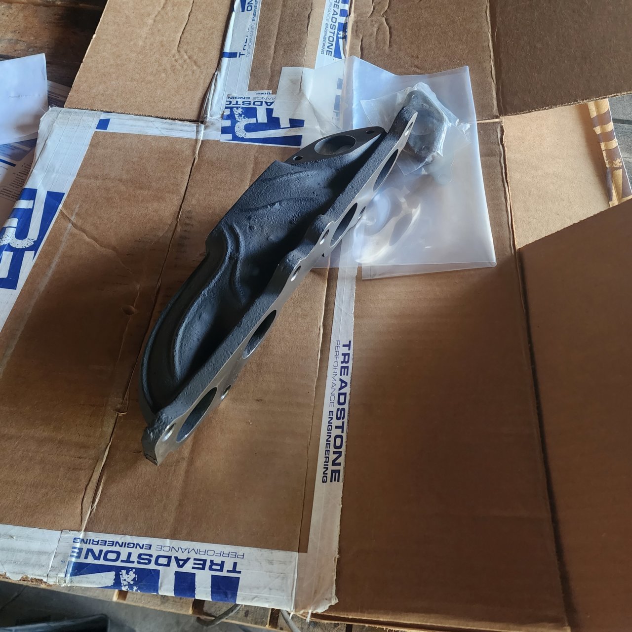

    Treadstone manifold finally arrived after 6 months... Was about to cancel my order. Hoping to get the rest of the pieces to make a new down pipe and have it installed this weekend. 20220928_175256.jpg

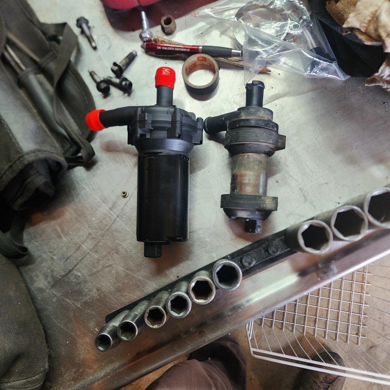

    Upgraded my intercooler pump also. The old one failed. There wasn't any info on the gpm the old one put out but judging by the size the new pump should flow quite a bit more. 20220917_120444.jpg

    Wow. I guess they made it to order?
    Either way, I am curious how you feel it performs.

    Oh, wow. I was looking at those and saw they were out of stock. May place myself an order then after I see your fitment.
    Should be decent to good performance.

    Quite a few people ran those in the past. They are good and you can make really good power. Kurt over at CT forums made over 500whp on e85 with his.
    I was hoping to run one, but it shoved my turbo into my 10" coilover.

    Does this mani take up more space than other alternatives?
    I would think a custom tubular one like the one mentioned before would be better for power?

    Like @MadTaco461 said, it is more about where it places the turbo. Not so much the size, in this case.

    Not really a lost of space. The turbo is further away from the block with the treadstone. Just hard when custom suspension is used. A 4 into 1 might yield faster spool and more top end. That cast manifold won't crack ever.
