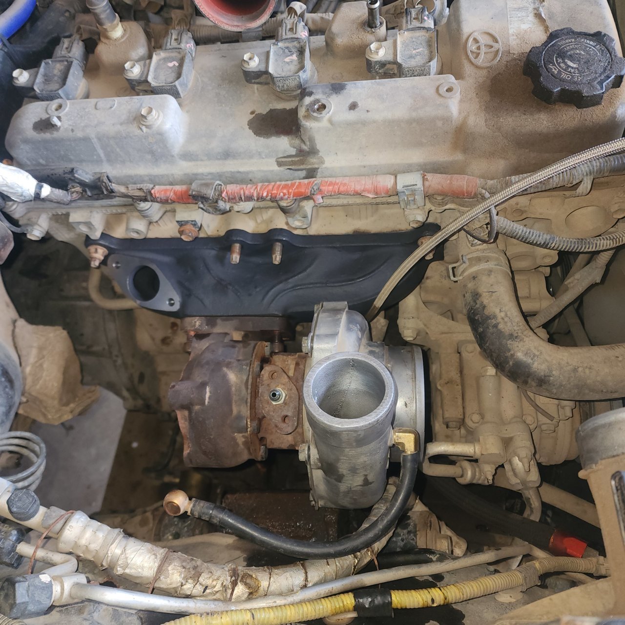

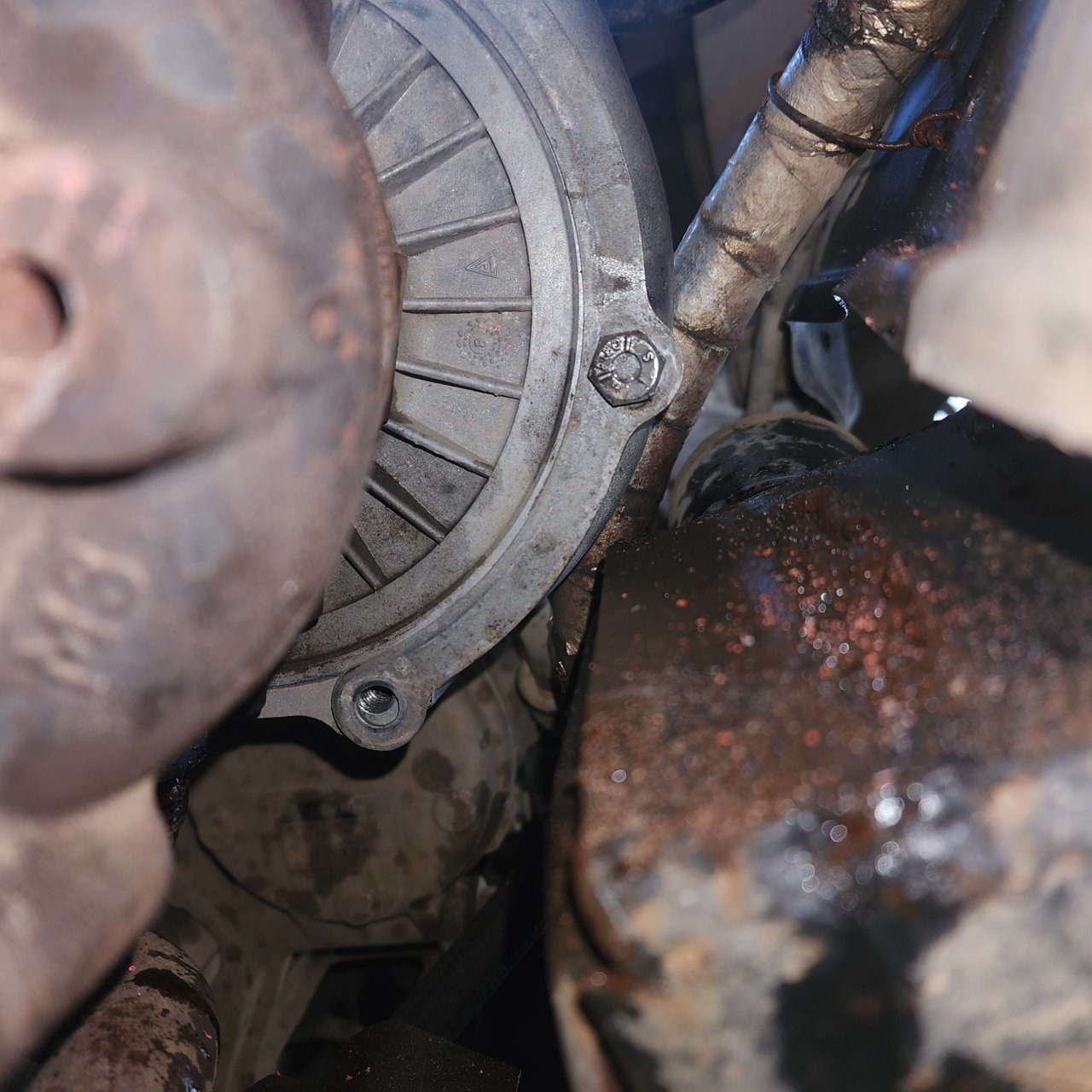

    This is indeed pretty tight to the coilbucket. I cut out a little bit of my gusset I installed to give a little more room. Might have to get rid of the T4 compressor housing. The compressor inlet also barely clears the ac compressor and the rad hose is going to be in the way. Hopefully I can cut that down. I might have to make a new airbox also to make this work.
    The lower two nuts on this thing are a bitch to get on. Ended up having to grind down the shoulders on a wrench to get them tight. No way to get a socket on them and had to remove the filter housing. I hope I got them tight enough and hopefully they never need to come back off.
    Got the downpipe tac'd up just need to connect the wastegate. Going to test my fab skills getting that to fit decent.

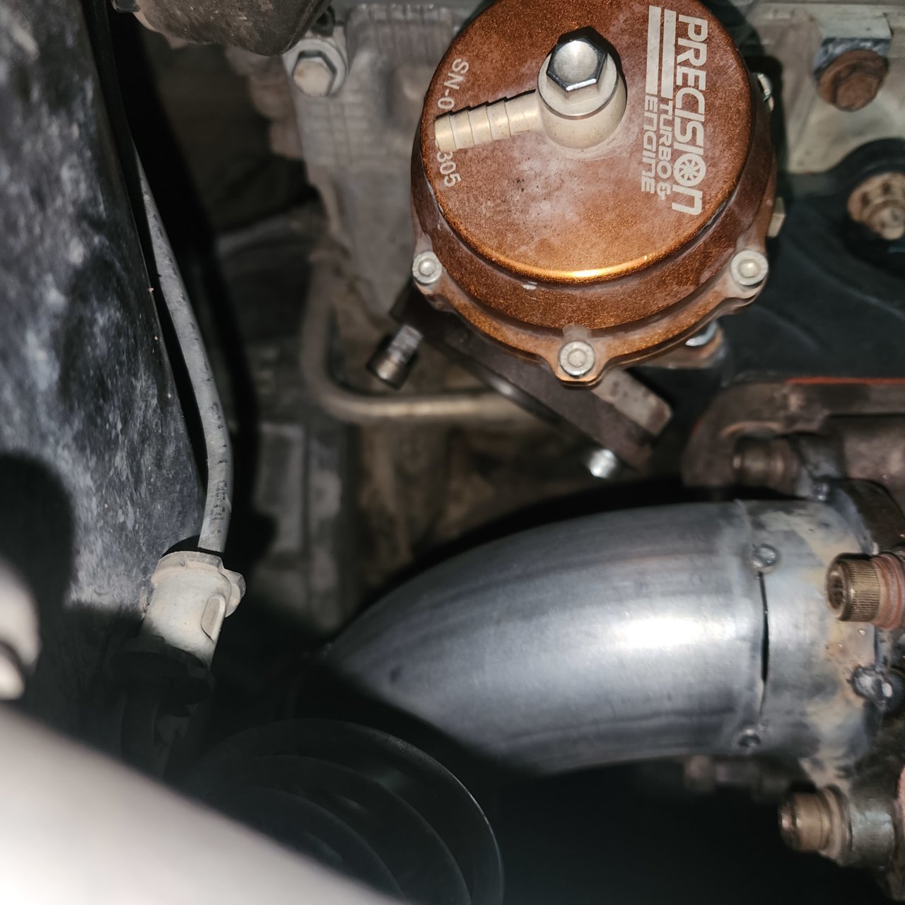

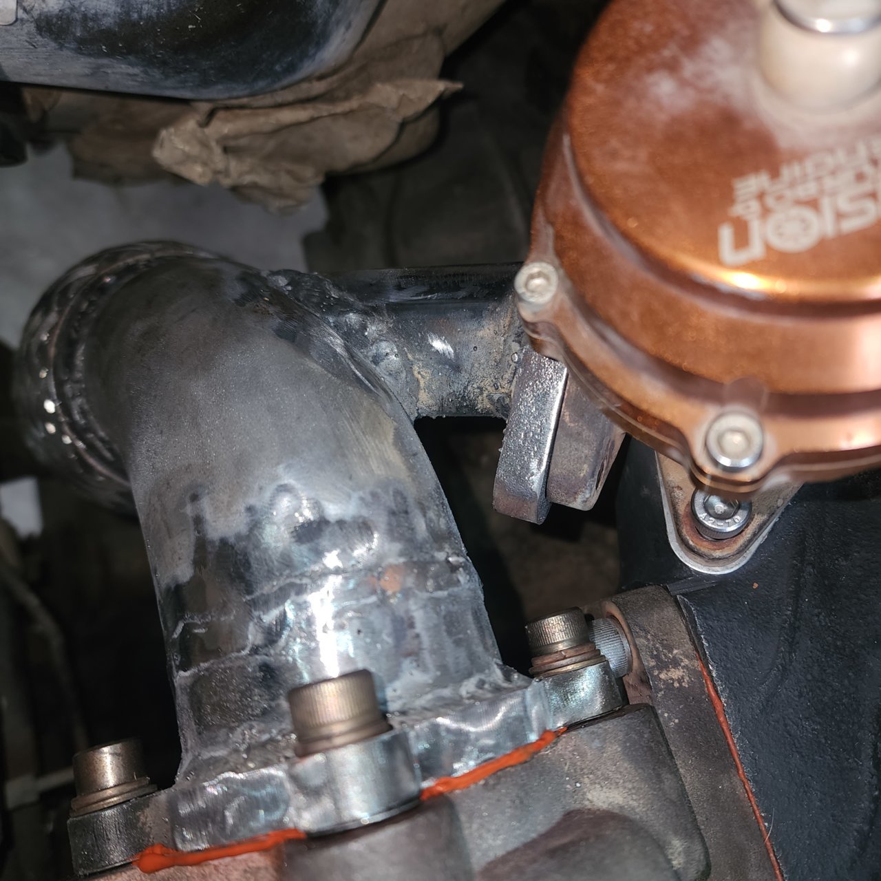

    Well that's enough to piss ya off. Wastegate flange doesn't line up after welding. Though I had enough tacs on it to keep from moving guess not. May try elongatimg the holes. 20221002_164626.jpg
    Brake Weight[QUOTED] and Jon64l like this.

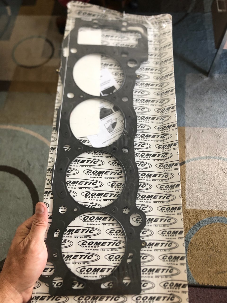

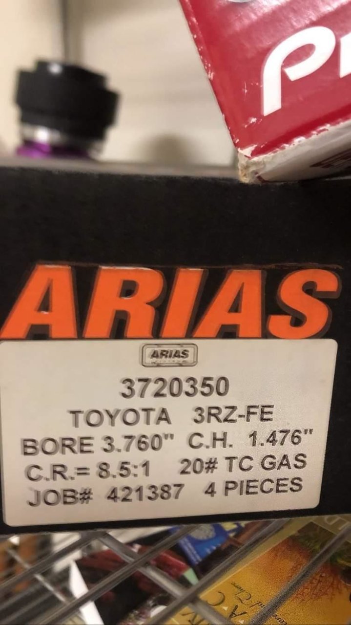

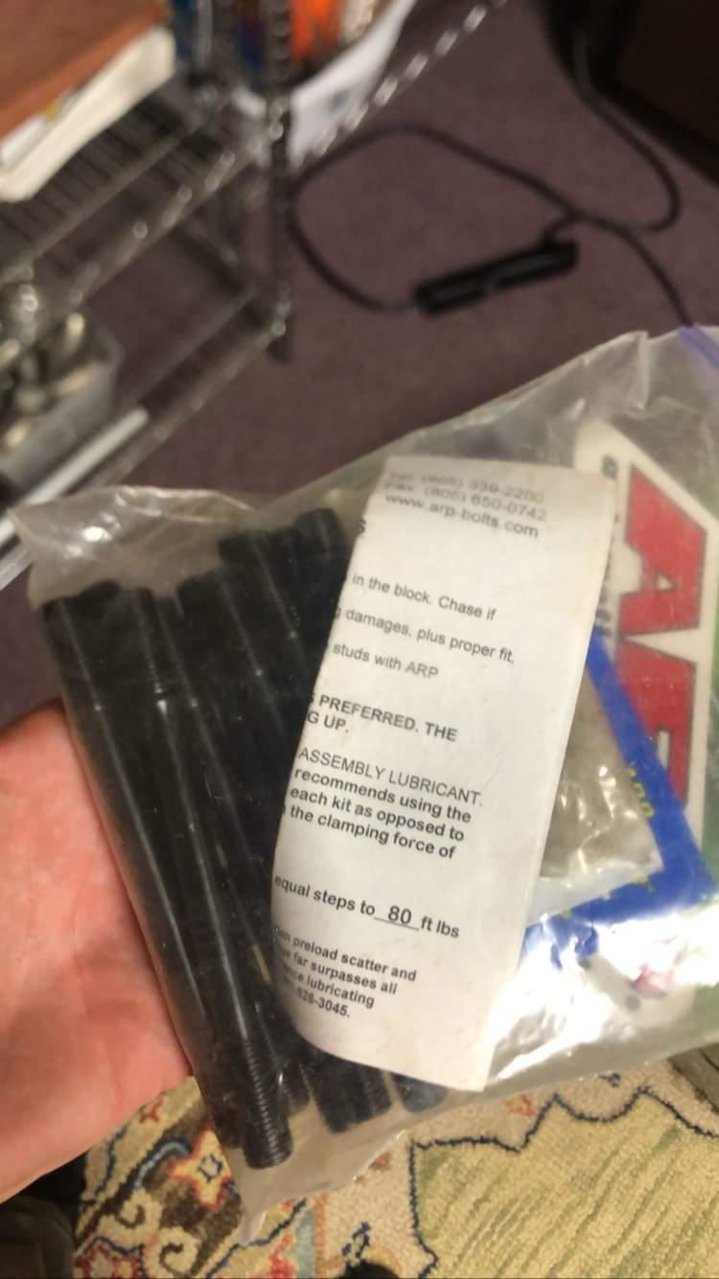

    My buddy has new 3rz build parts he would like to sell as a set.
    Arp head studs
    Cosmetic MLS head gasket
    Arias forged pistons
    $500 for everything Plus shipping

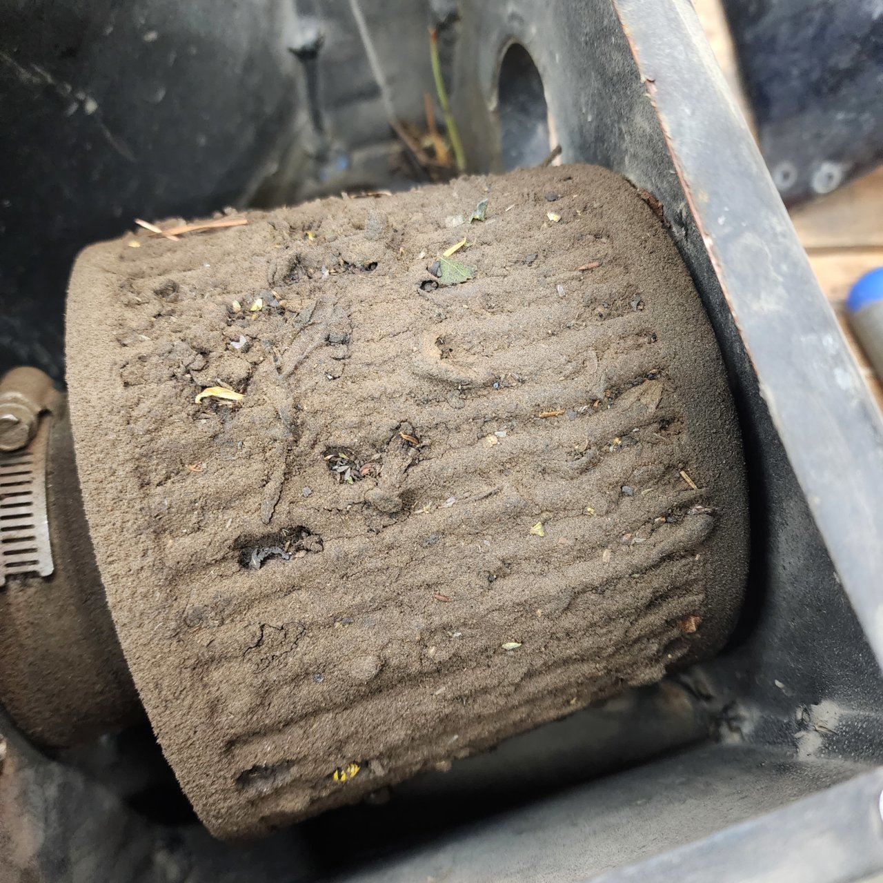

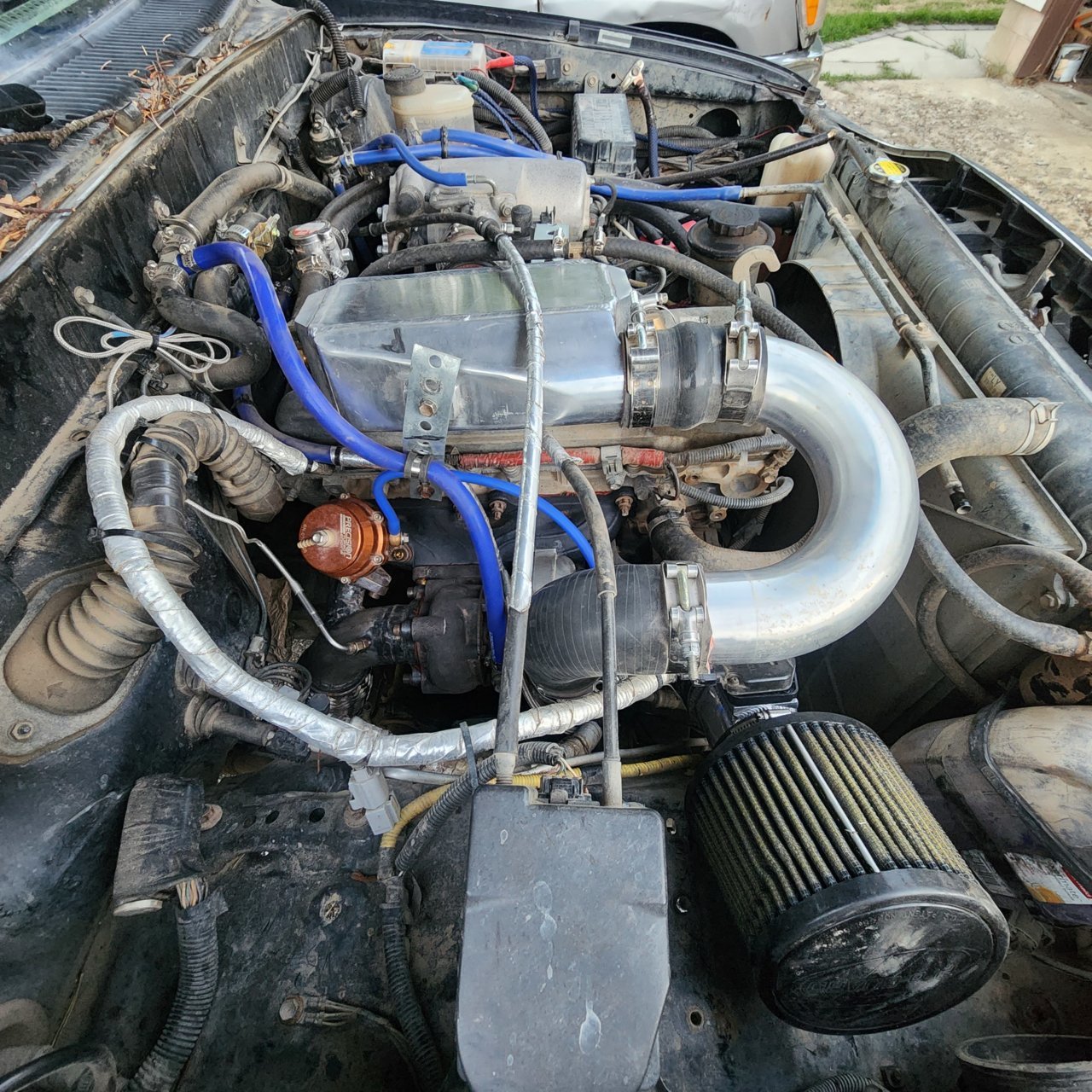

    Picked up a Spectre MAF tube to finish the Treadstone manifold install. I'll have to make a new airbox to make use of the snorkel again. I like how much lower this is compared to my previous manifold. I'll have more room to play with the intercooler if I decide to clean things up. On the initial drive there were no witness marks from the compressor housing hitting the coilbucket yet.
    Performance wise, I'm not sure I notice a difference between the log style mani and this. Pulling the hill close to my house my timing stayed closer to 20 when it used to drop to 15 in 5th. Could be attributed to having a clean air filter, can't believe it still ran with that much shit caked in there. Things are quiet without all the leaks and I can barely hear the turbo spool anymore :(. I can however hear the turbo flutter when letting off.

    Omg that filter!
