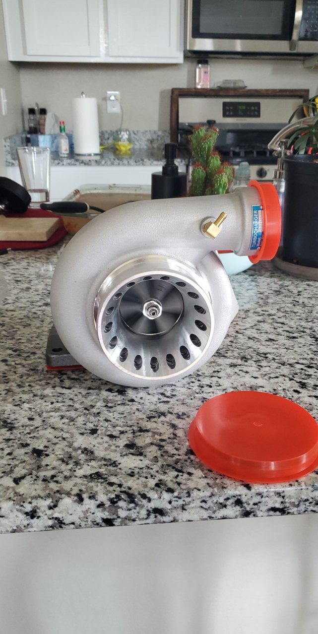

  14. Oct 10, 2022 at 8:15 PM
    ShiftyShank
    ShiftyShank Oof
    Sep 11, 2019
    #304986
    1,294
    Pat
    Northern Colorado
    02' BestGen 5VZFET
    I have more questions.
    key reason for the plug and play situation is to be able to return the truck to a prior state if need be for any reason.
    I do intend to continue to daily and wheel the taco.
    Follow up:
    I looked into the Boomslang and SNP.
    SNP looks mega convenient for a stupid dollar tag. missing details around the future. (MAP/MAF for closed loop adjustment with temp and altitude change.?)
    and boomslang looks like the more appealing route because of the happy medium of plug and play. and mandatory involvement for configuration. and obviously $1000+ difference.
    1)
    Though I haven't called either company yet to get the situation on air temp/and MAP/MAF stuff (I Will after this business trip).
    Both lack on websites for these details and I wanted to know who has used either and which ways you went about managing air temp/ closed loop balance with temp change/altitude change as this seems to be my last hang up at the moment.
    2)
    Has anyone worked a config that maintains the OBDII ports for Emission reasons?
    3)
    I'm Kind of set on Haltech because of the boomslang plug; with this said. For what reason would one want the 2000 or 2500 over the 750 since they can all control (min.) 6inj/ig modules. Seems like more available inputs is all I read but still so fresh I'm not sure why I'd need them later.
    4)
    Good standalone Alternatives would be best with Link; Megasquirt and AEM?
    5)
    As for injectors; moving up to 440cc should be ample if I do not intend to cross over the 400hp threshold; correct?
    Thanks in advanced. Enjoy a picture of my baby shitty Chinese turbo that came in yesterday, in the mean time.:luvya:
    Yota X, BananaMan and Jon64l like this.
  15. Oct 10, 2022 at 8:55 PM
    Reh5108
    Reh5108 Well-Known Member
    Feb 18, 2013
    #97832
    5,804
    Idaho
    2004 SR5 4X4 2.7L Extra Cab
    OME lift, 4x sliders, Demello rear bumper, custom front bumper, Engo 9000lb winch
    I've been eyeing Paddock Performance and there plug N play with megasquirt 2. Half the price of SNP.
    I do believe that you can retain obdII with the 2500 Haltech. Can't remember his handle at the moment but the blown first gen with a ton of miles went this route I believe.
    ShiftyShank[QUOTED] likes this.
