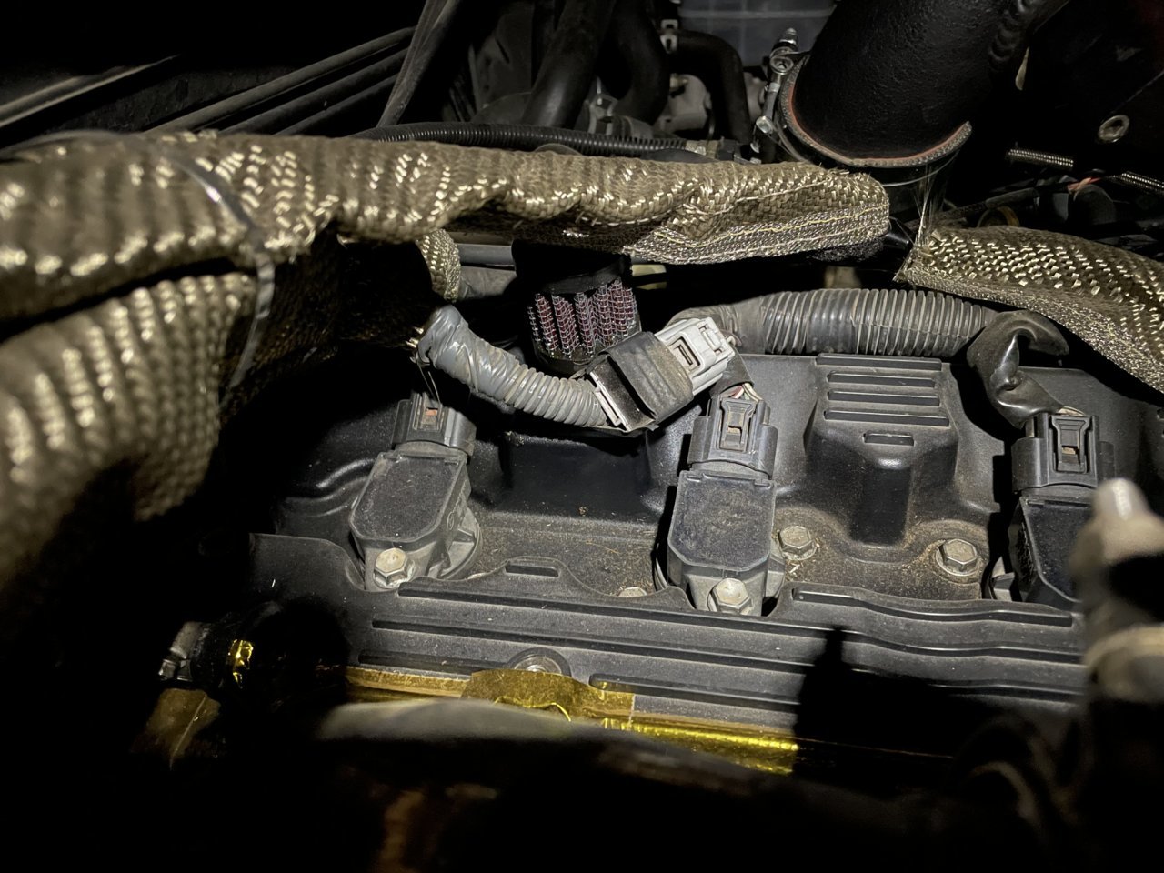

    Hey folks, need a little help. Noticed today that the filter on my valve cover is pushing oily vapor out and sounds like it’s hissing at idle. Would this indicate a bad PCV valve? I was under the impression this should be drawing in clean air and not pushing oily vapor out

    Your pcv is meant to release pressure from the crank case. No air will be drawn. Unless you've just removed the pcv and vented to atmosphere.
    If it's hissing it's probably under pressure. If it's under pressure it's probably time for a new one as it's no longer performing its function
    Edit:
    Did you remove the pcv and filter on the valve cover?
    Or did you put a filter on your pcv on the valve cover?

    The outlet of the pcv runs to a catch can and then filter on the valve cover and catch can outlet goes to the fresh air inlet pipe for the turbo
    thanks for the info, im gonna swap mine out, I had one hanging around for a rainy day, just need to make time to take the valve cover off

    You don't need to remove the valve cover to remove the PCV valve. It is tight, but can be done.
    We drilled Mike's valve out, if I remember correctly. That way it could never go "bad".

    This was my follow up question for turbo people. When moving to a catch can couldn't you just plumb the valve cover(s) to the catch can without a pcv?
    Only point in the pcv is to prevent crank case pressurization - That said putting an air filter to vent the catch can would be fine to adapt? (Without pcv inline)

    You could take it off. I left mine. I hooked a hose from each valve cover, Y them together, then that line goes to catch can. From can the line goes to intake pipe pre turbo. The can was vented at one point but I could smell vapor every so often, so I just put it back into intake track and let the engine cool it like normal.
    I actually just emptied it yesterday, very little came out. I do this about every 2 or 3 oil changes. It's definitely separating and condensing the vapor.
    I wouldn't run just filters off covers. 1 smell, 2 little leaks of oil.

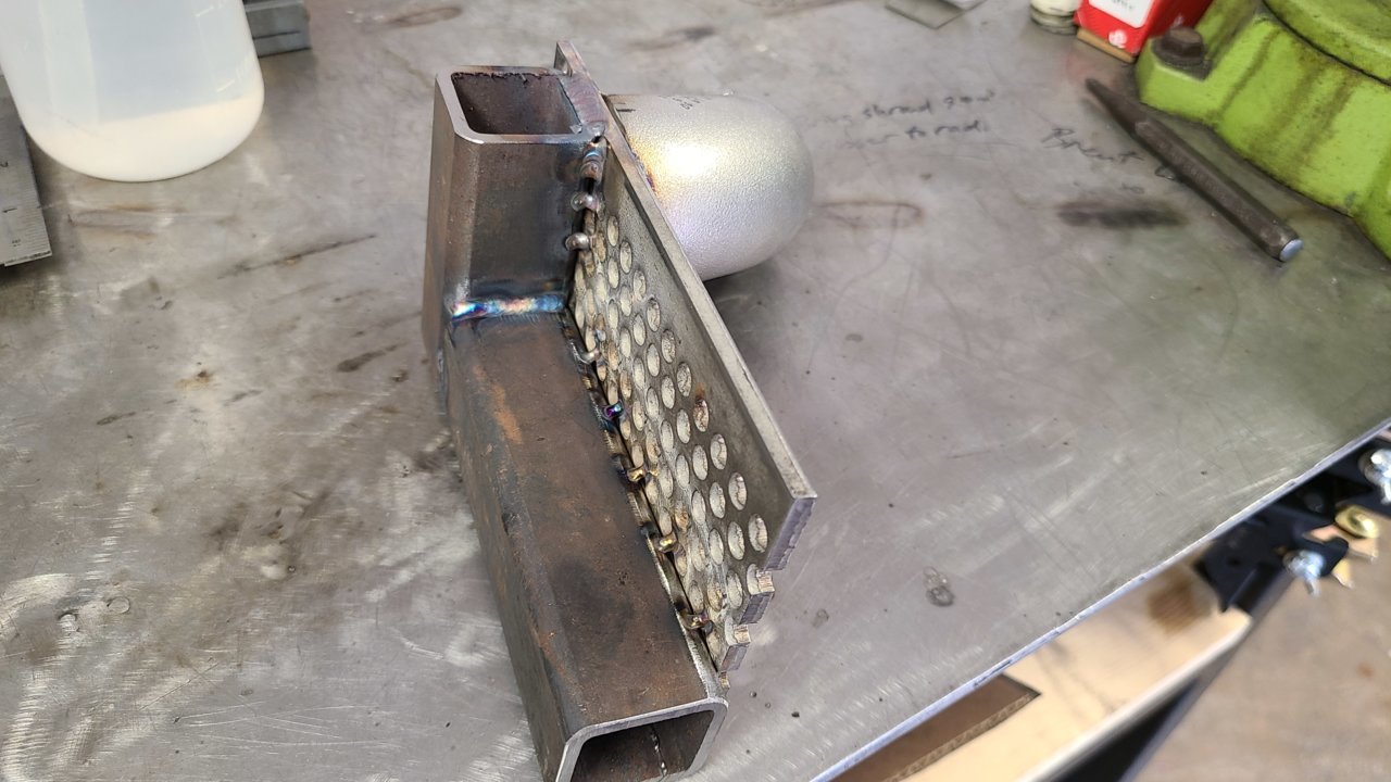

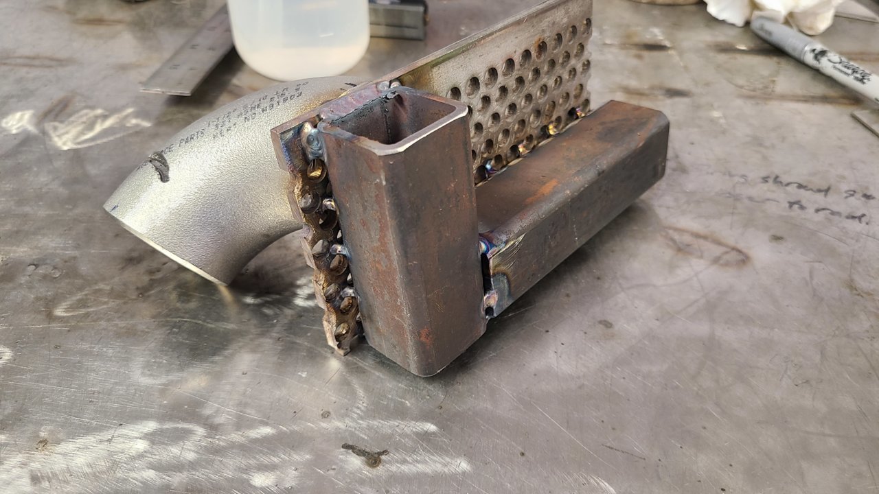

    Poor man's tube notcher, for a drill press....
    Clamps into a vice. Before I added the tubing, the thin sheet would vibrate too much. Bi-metal hole saw wasn't up to the task on the 321 stainless. Which I knew would be the case. Tried because that was what I had. Home Depot was all out of their 2" Carbide tipped hole saws. So grabbed the Diablo 2" Carbide tipped one. Little did I realize that you have to also purchase their specific quick release chuck. Ugggghhhhh

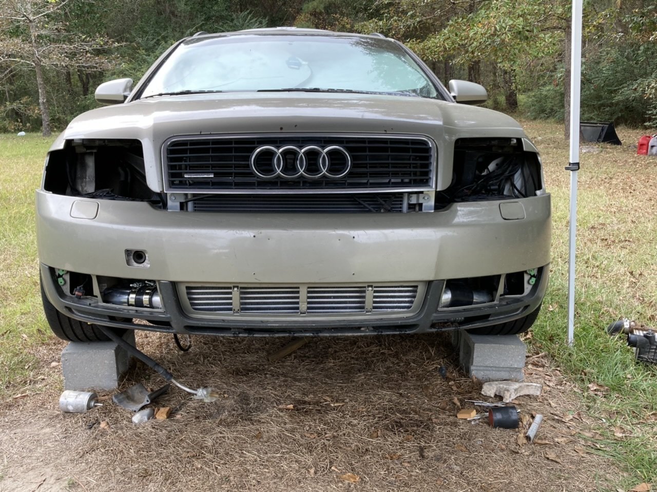

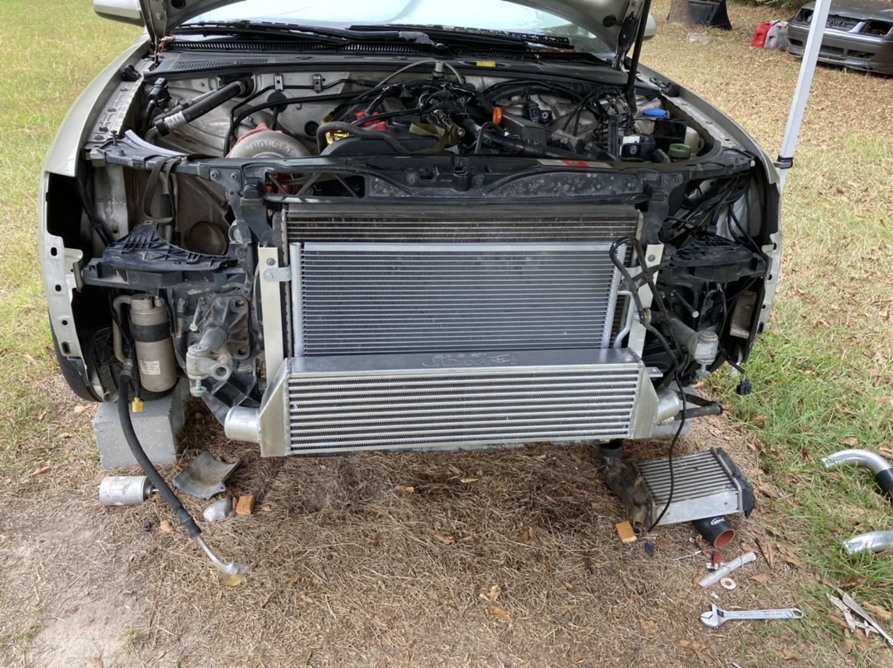

    Getting closer on this thing. Really hoping to have it on the road, tuned proper, and with an obnoxious exhaust by Friday. I fitted 2.5” intercooler piping along with that large FMIC this morning and will need to track down a welder that’ll do aluminum. It needs a MAP sensor bung and I may as well have the piping stitched up, too. I used less than half of an $80 fleaBay generic piping kit which looks like there should be enough to do the Tacoma when that time comes.
    Used 1.5” aluminum angle to lower the AC condenser as well as rigid mount the IC.
    Bumper shoved on and hood almost down it looks fairly good. I’ll need to do some trimming on the bumper to avoid rubbing.

    How do you hook that up to the drill press? Like to see a picture when it is chucked up.

    Small vice, with some huge clamps.
