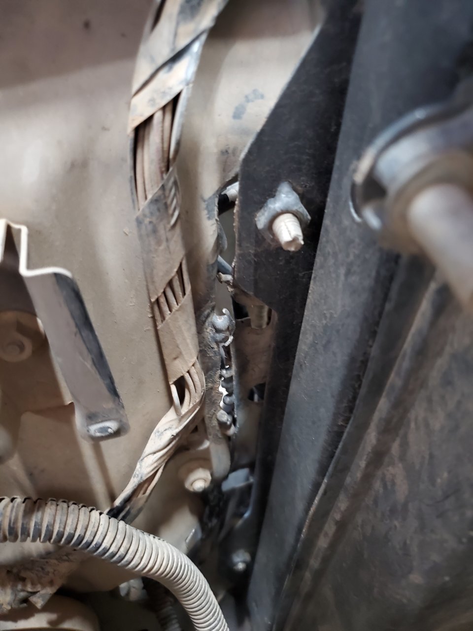

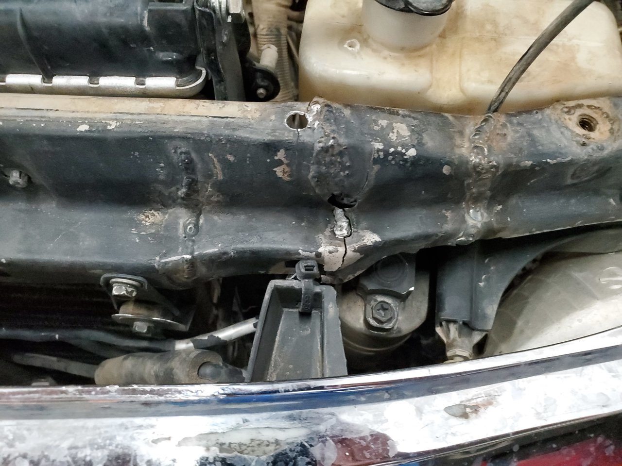

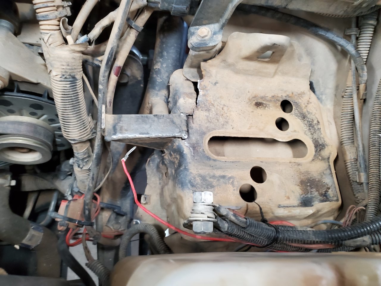

    Progress on driver side.
    20221018_144224.jpg 20221018_144235.jpg 20221018_144658.jpg 20221018_145417.jpg 20221018_160818.jpg 20221018_161639.jpg

    And I thought my core support was bad lol. Your progress is looking good. I've debated just building a whole engine cage and new shock towers when mine is past the point of no return.

    @Reh5108
    I'm trying to avoid that rabbit hole. Maybe if i had more time and money. New towers/cage means dual rate coil overs and longer bypass shocks. It would be stronger and faster, but I'm not racing. I just enjoy the weekend trips to the desert.

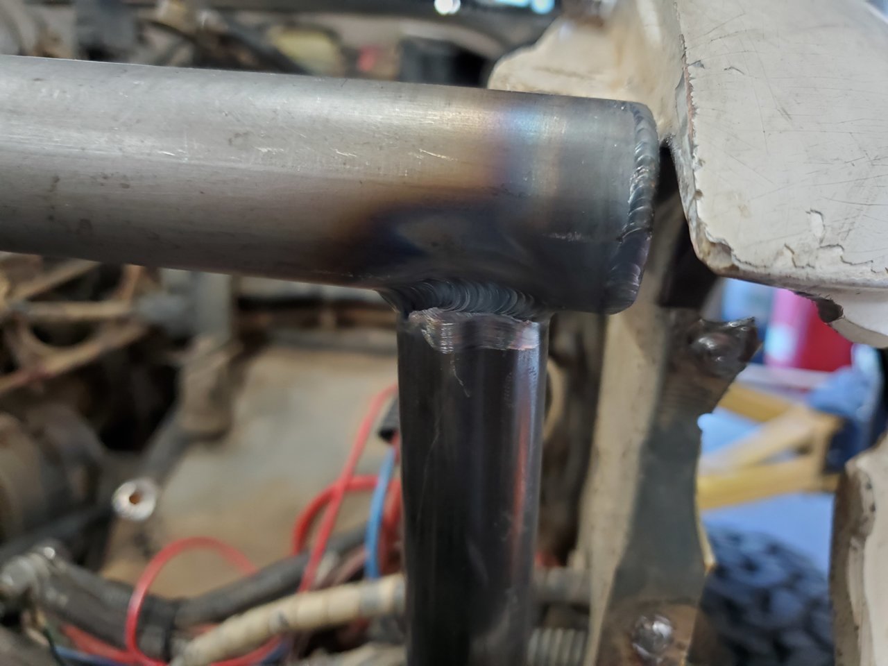

    Nice welds

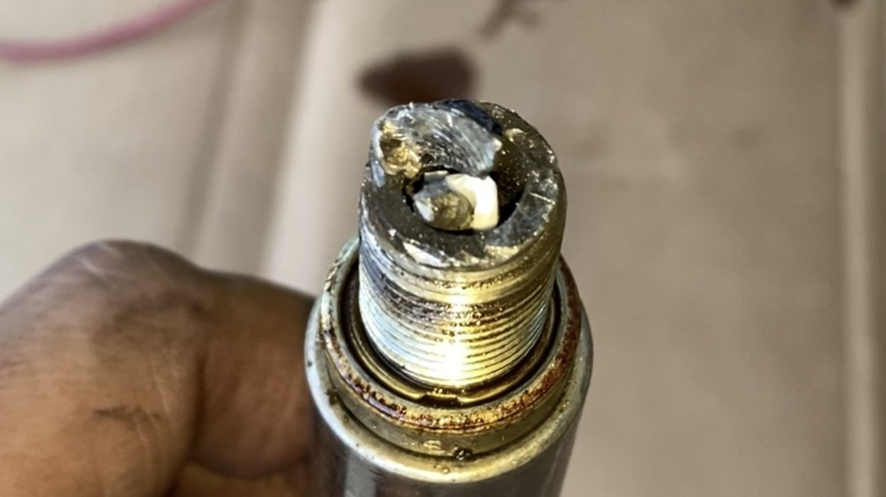

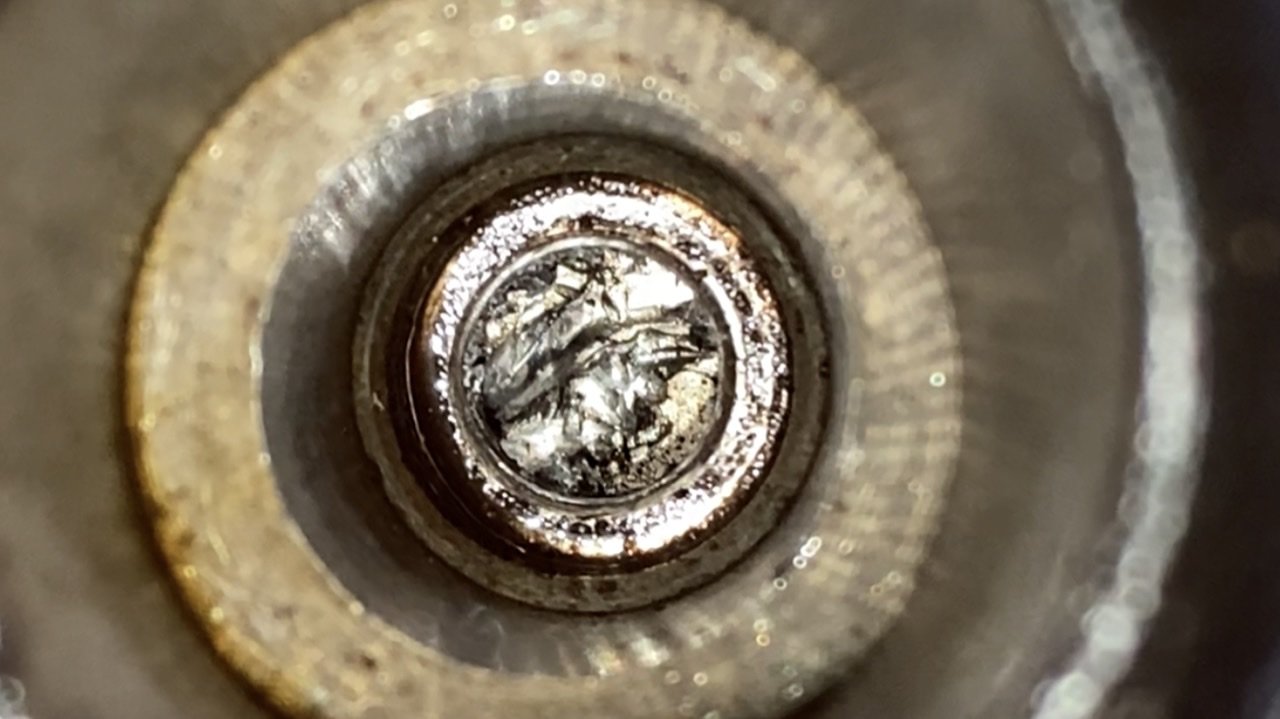

    So one cylinder has been clearanced for lower compression? That engine was a used engine yes?

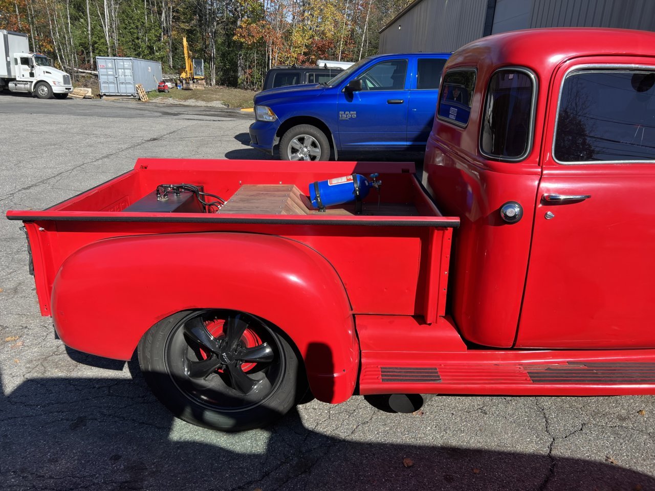

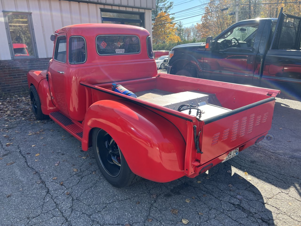

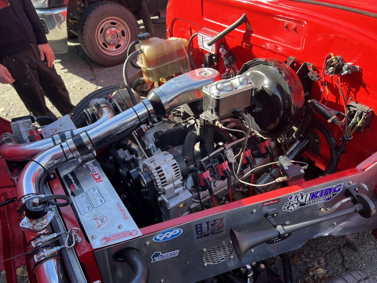

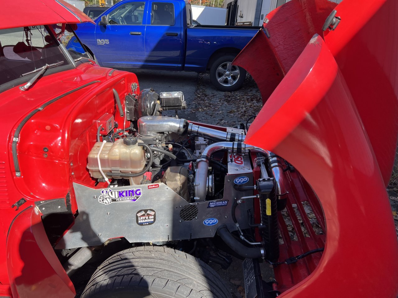

    On a parts run earlier and came across this truck. Real Frankenstein of chassis/body but she sure has it where it counts.
    F41A85B5-841C-4970-9C86-54942CD696B2.jpg 607CCE6A-F7AE-4F9B-BB61-D0284E16CA7A.jpg BB1D2B23-ACAE-43FA-A09D-803D50FA774A.jpg C0DC3644-7F38-4D9E-8995-B3E3E201A5EE.jpg

    Yes, but I also had just replaced all the exhaust valves. I plumbed the relief side of my TurboSmart OPR40 oil regulator to that corner of the valve cover that appears to have dropped a valve. I’m not sure if I botched the retainer install or if the excess oil pooling had some bearing on the carnage.

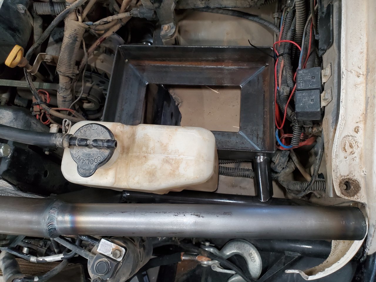

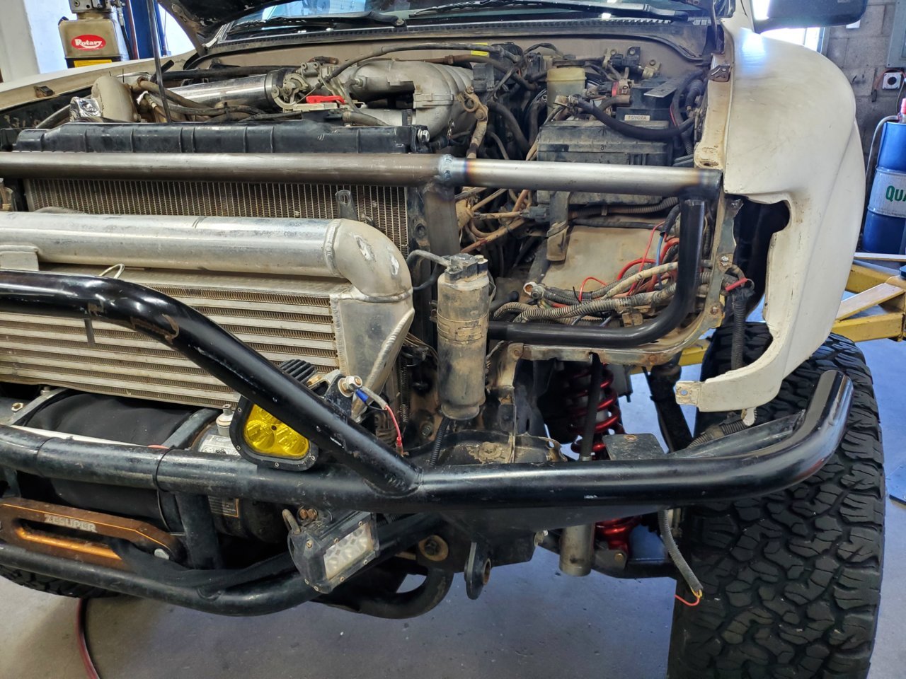

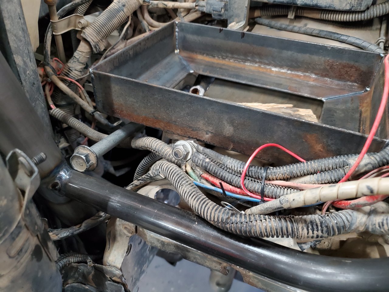

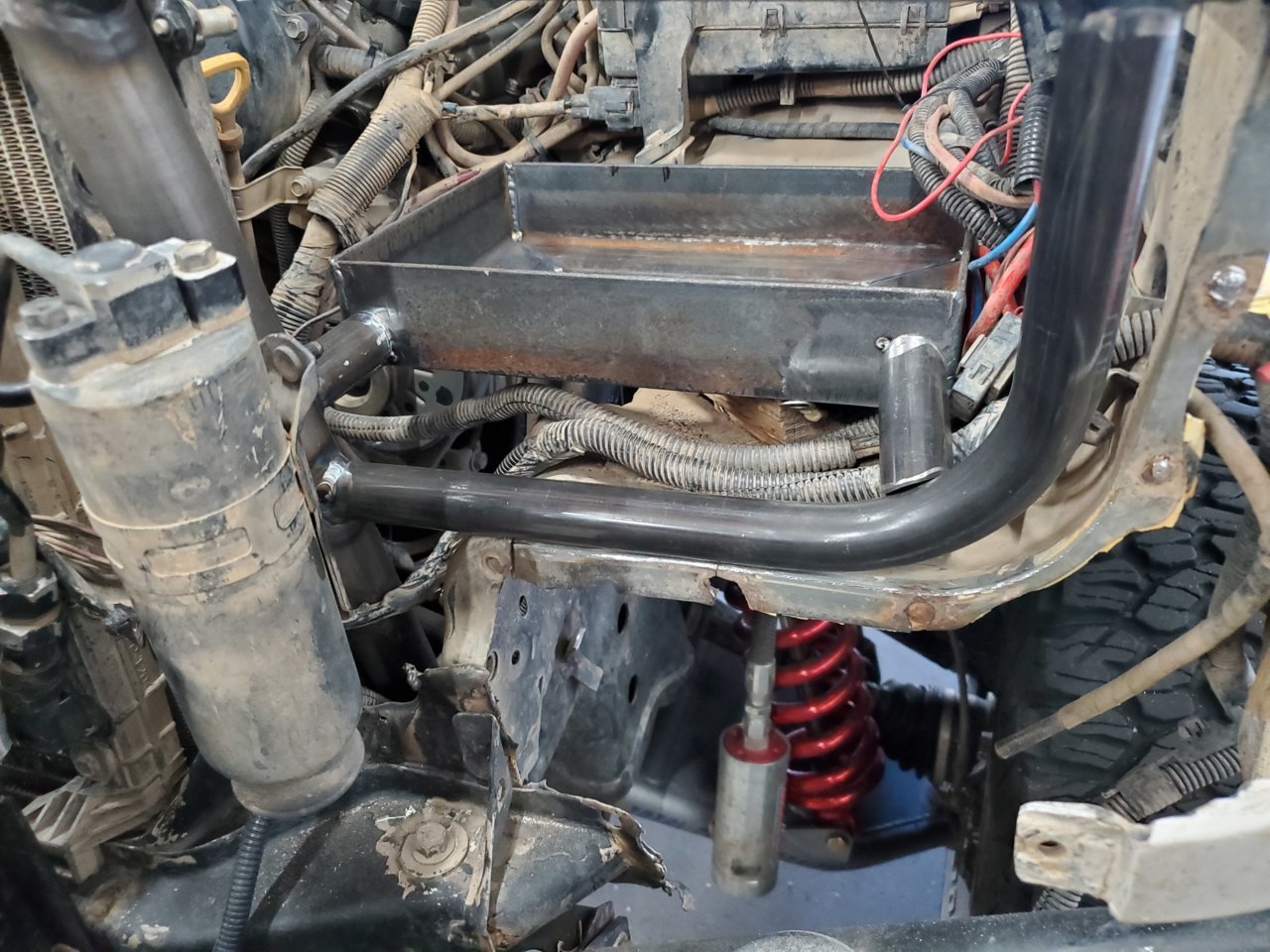

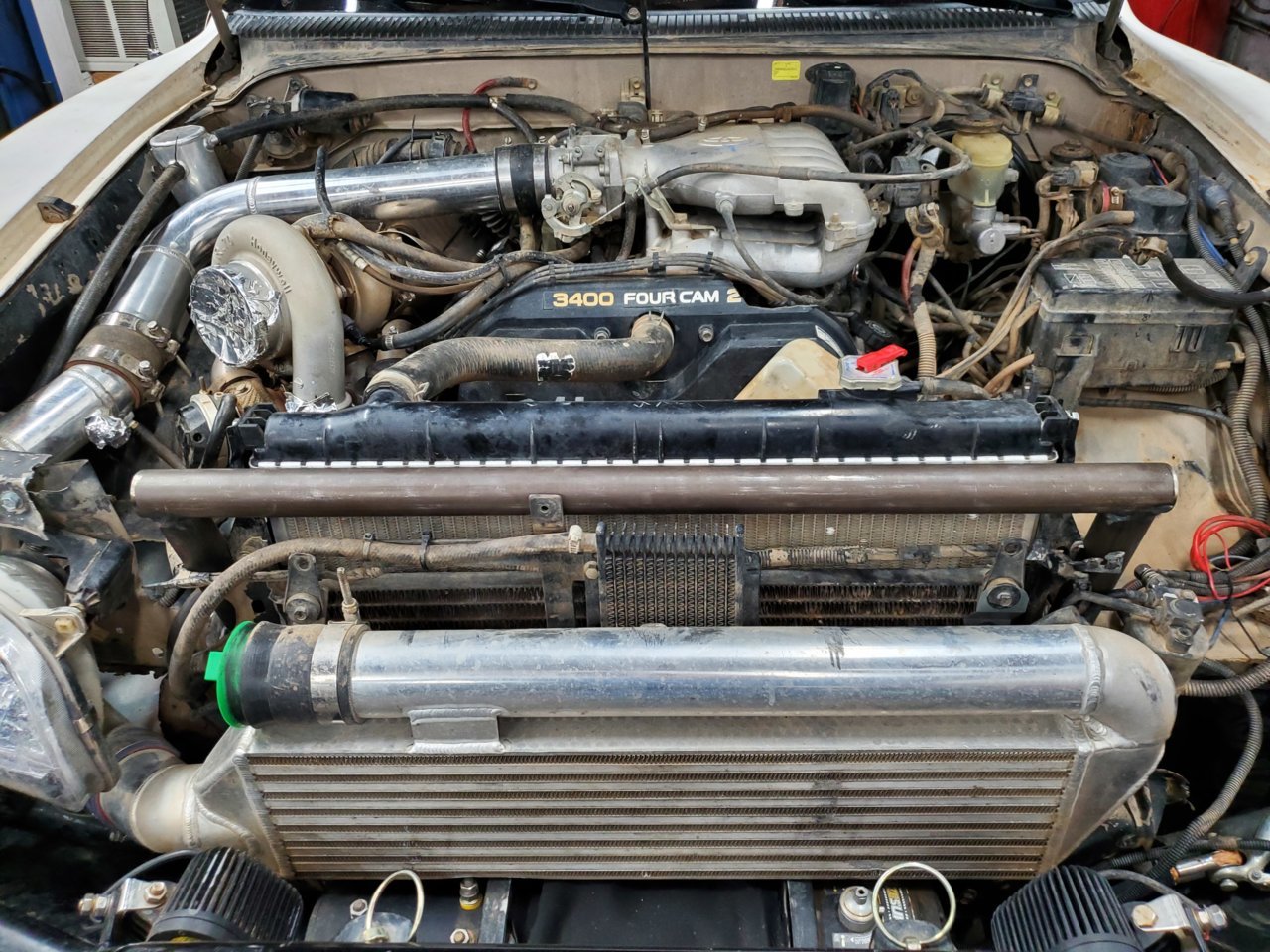

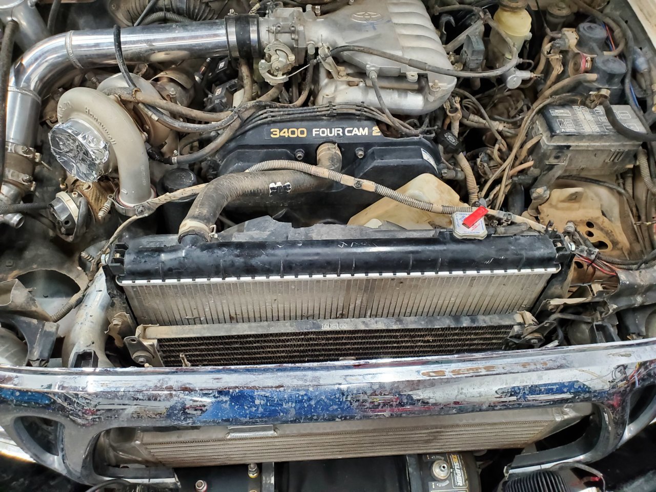

    Almost done.
    20221019_143844.jpg 20221019_152206.jpg 20221019_135126.jpg 20221020_124531.jpg 20221020_150117.jpg 20221020_160652.jpg
    The corners I cut off to make the battery box came in handy for the radiator mounts, head light upper mounts and forward battery mount. Had to trim a little plastic on the lights to clear the tube. Also had to adjust hot charge pipe. Need to mount Ic, Ps cooler and hood pins, maybe adjust intake, then get back out there!
