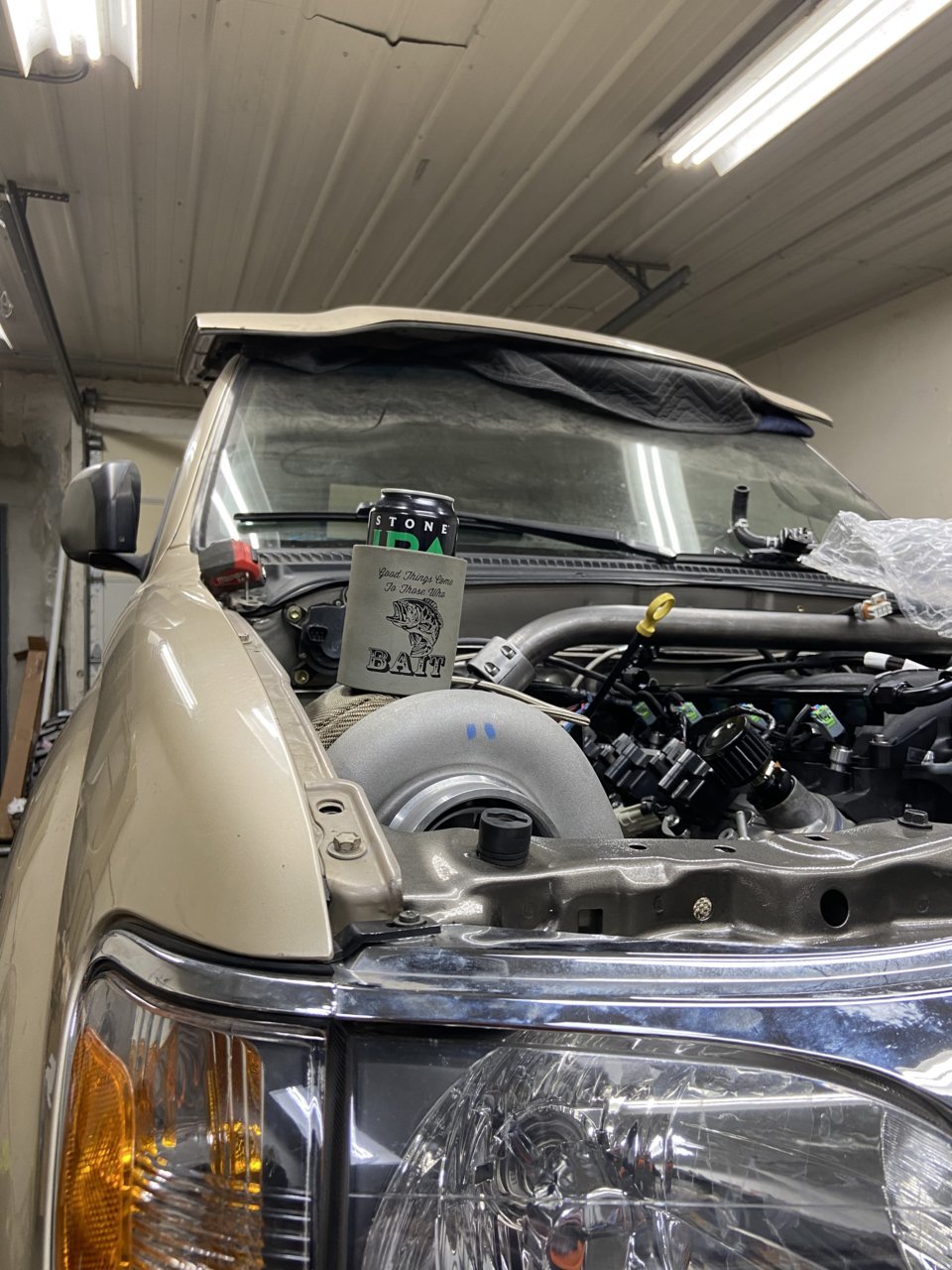

    I supported 100% of this photo until I saw the stone brewing logo.

    lol. That was the point of the pic. I assume you are a beer guy. We dont have a million MB’s here like there. I am forced to buy my beer from a liquor store if you can imagine that. :cool:

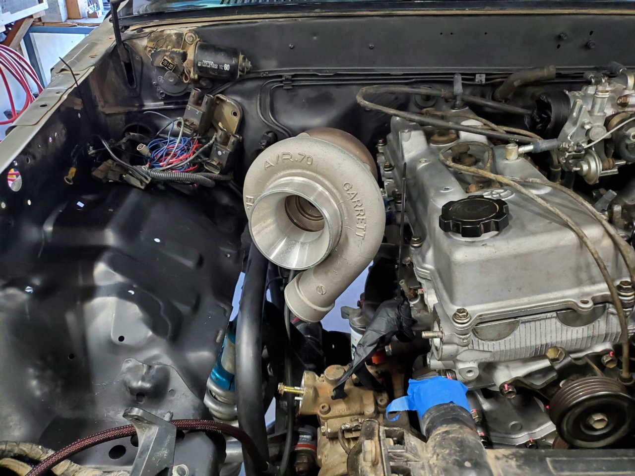

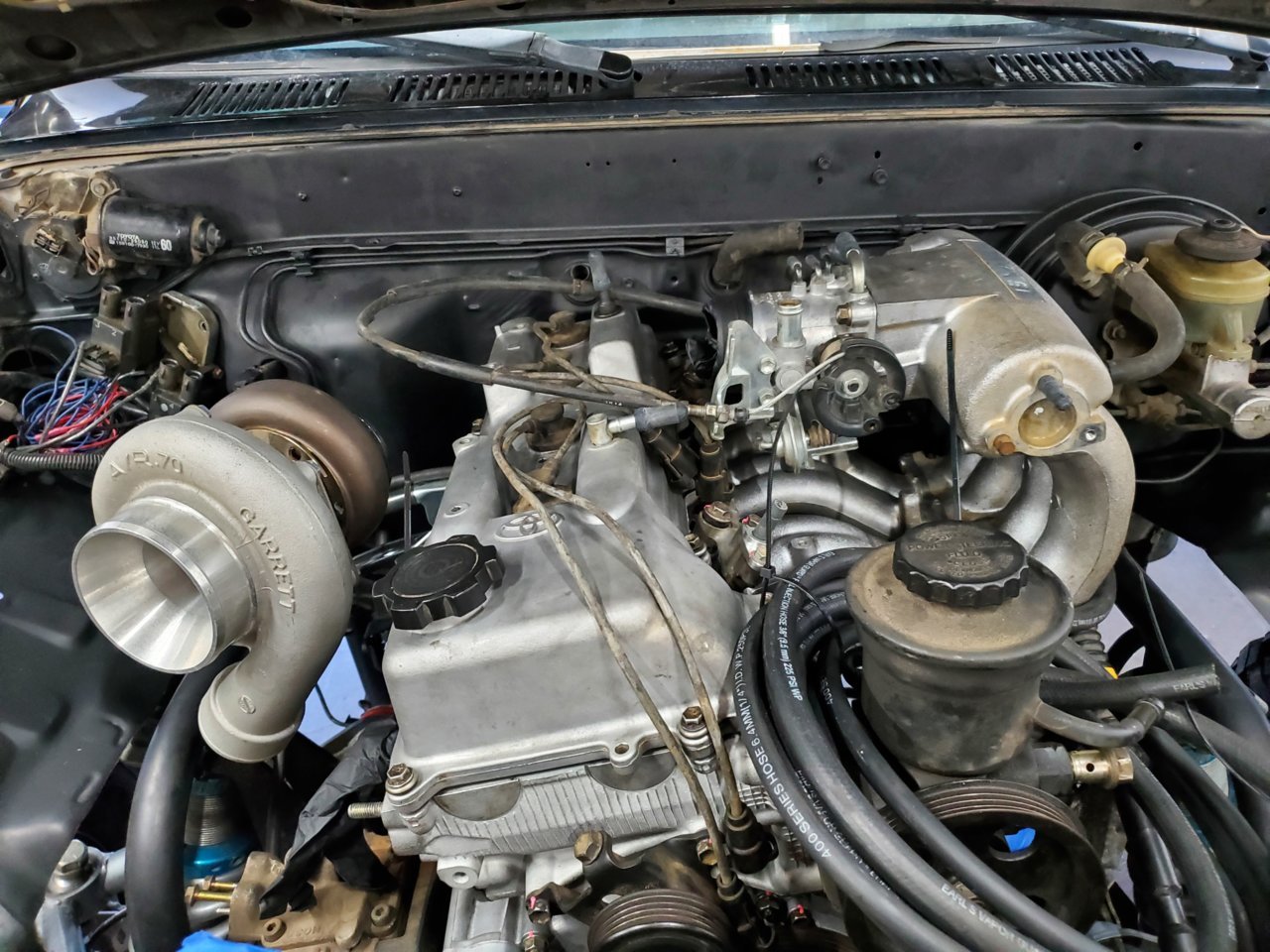

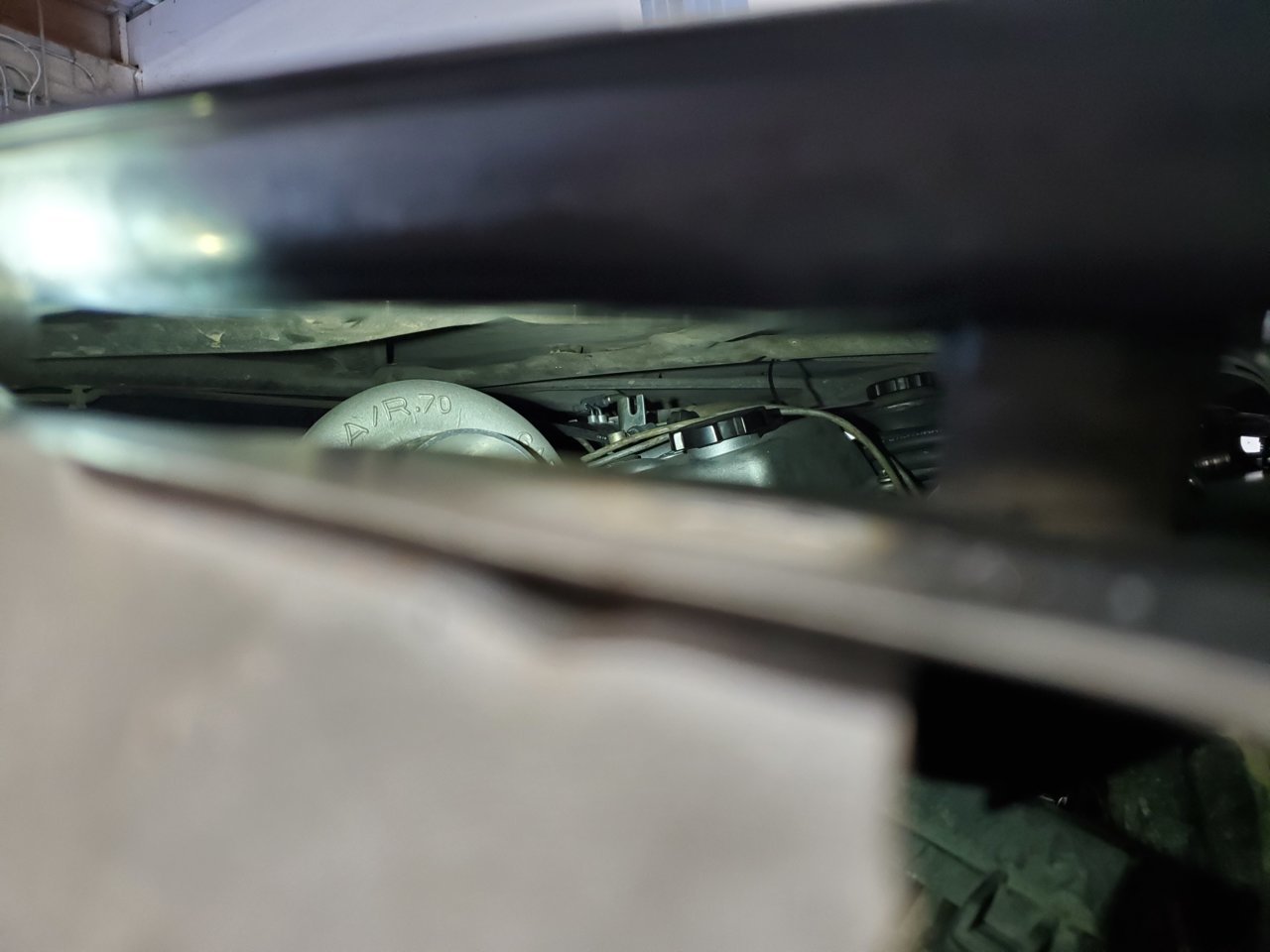

    Any 3rz guys see a problem with this location for a 1st gen Taco?

    Looks almost the same as what I did on the 2tr. Some thermal protection would not hurt.

    Hopefully he will spring for ceramic and a heat shield. For now just wanting it to clear other vehicles.
    Biggest issue I see right now is charge pipe from throttle body.
    More concerned about coil bucket in 1st gen Taco though for compressor outlet. Seems like there is more room in these older trucks.

    Looks pretty high and away from the coilbucket. With the compressor outlet in that orientation, it may interfere.

    I'm thinking the compressor would rotate clockwise around 90° to clear.

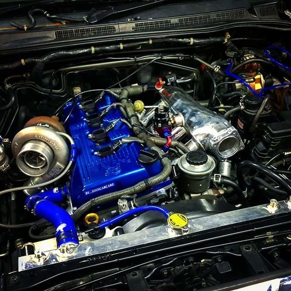

    Originally posted by @MrCrowntown. A friend of his from Thailand.

    It's usually just wire loom and ac lines to watch out for.

    Might be boned if it is a dizzy 3RZ too since you can't relocate that like the coilpack.
