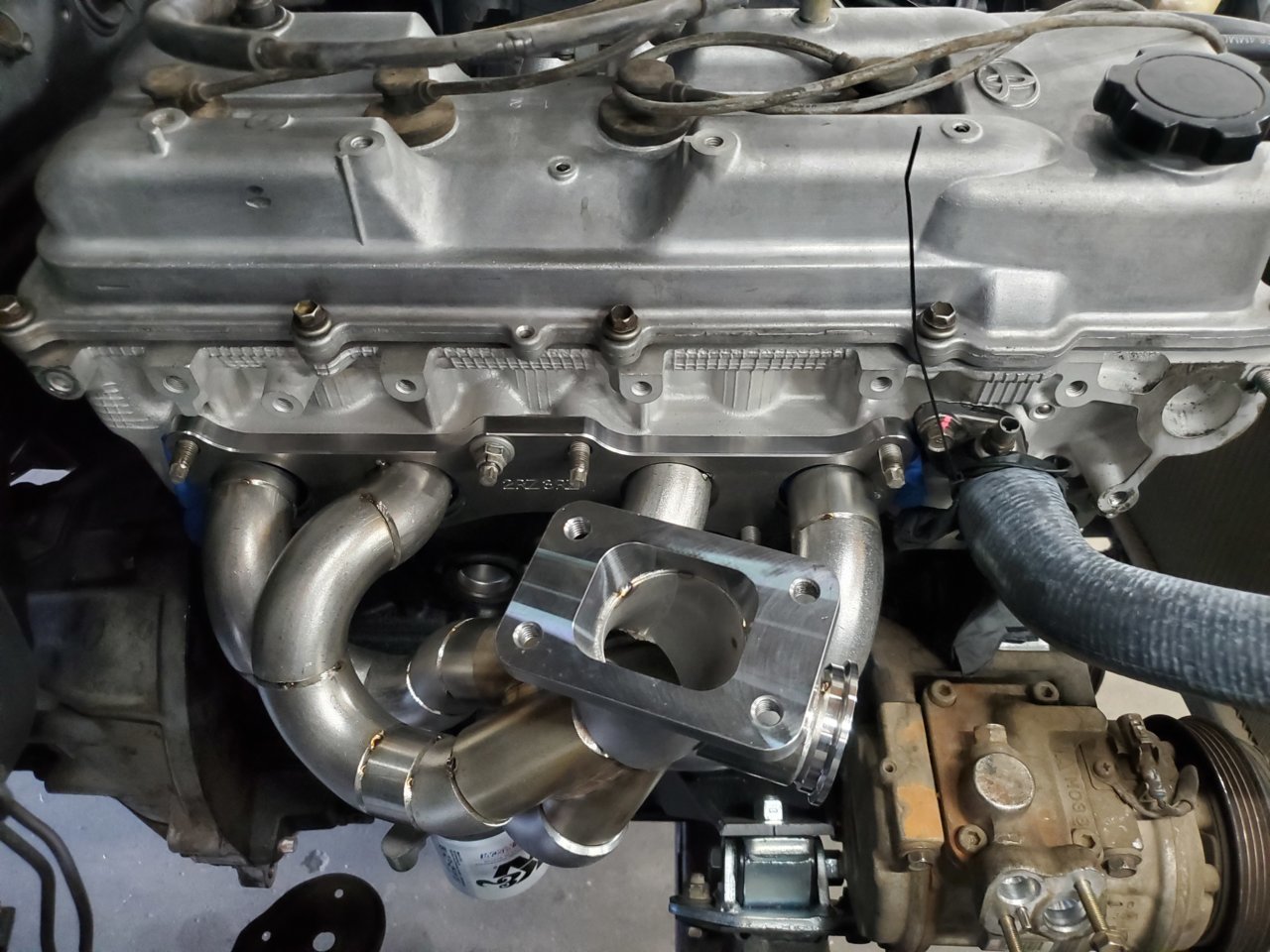

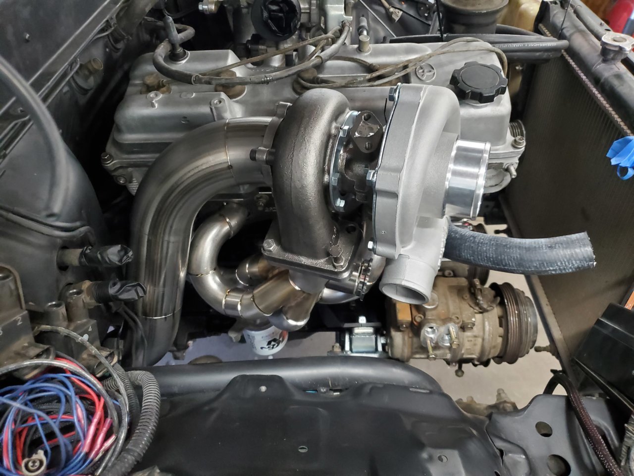

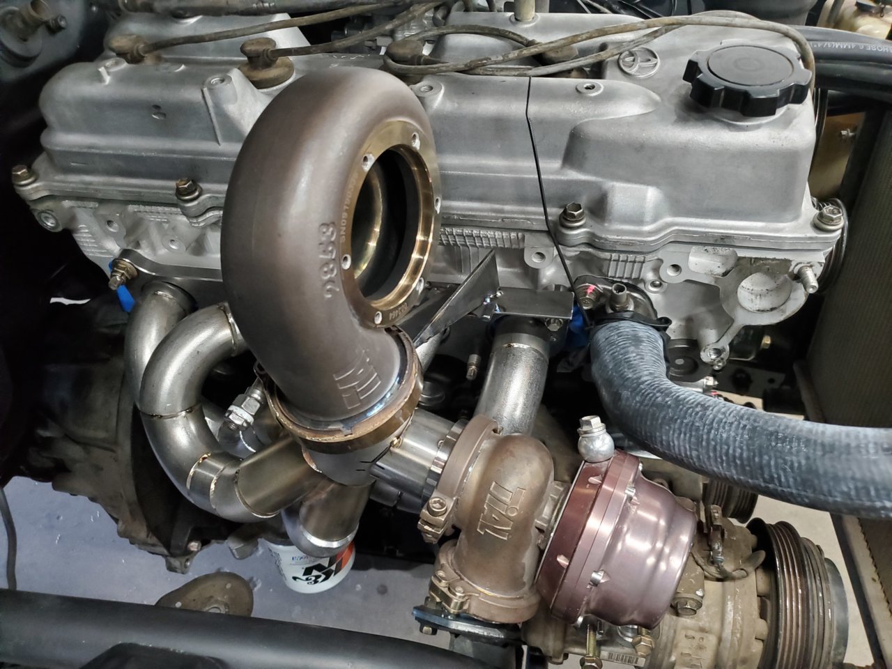

  5. Nov 16, 2022 at 2:33 PM
    Jon64l
    Jon64l Well-Known Member
    Jan 12, 2016
    #174799
    1,682
    Jon
    2000 4runner, 1996 Tacoma
    Making progress..

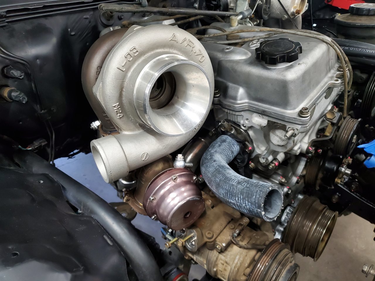

    What color did that w/g begin life as?
  8. Nov 18, 2022 at 1:06 PM
    Jon64l
    Jan 12, 2016
    #174799
    1,682
    Jon
    Haha idk black maybe. My buddy ran it along time ago, then I did, now it's just for mock up.

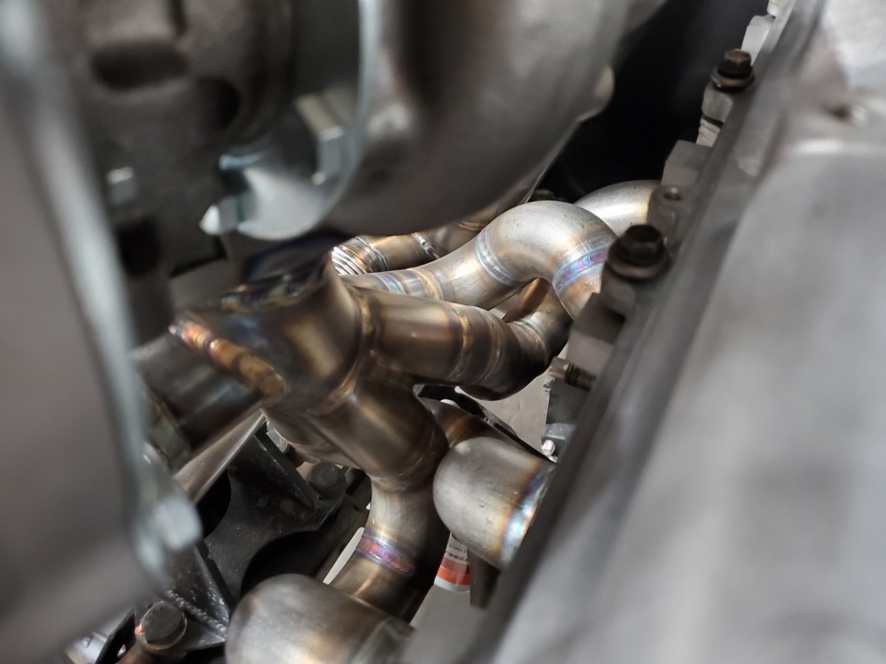

  9. Nov 18, 2022 at 6:28 PM
    Jon64l
    Jan 12, 2016
    #174799
    1,682
    Jon

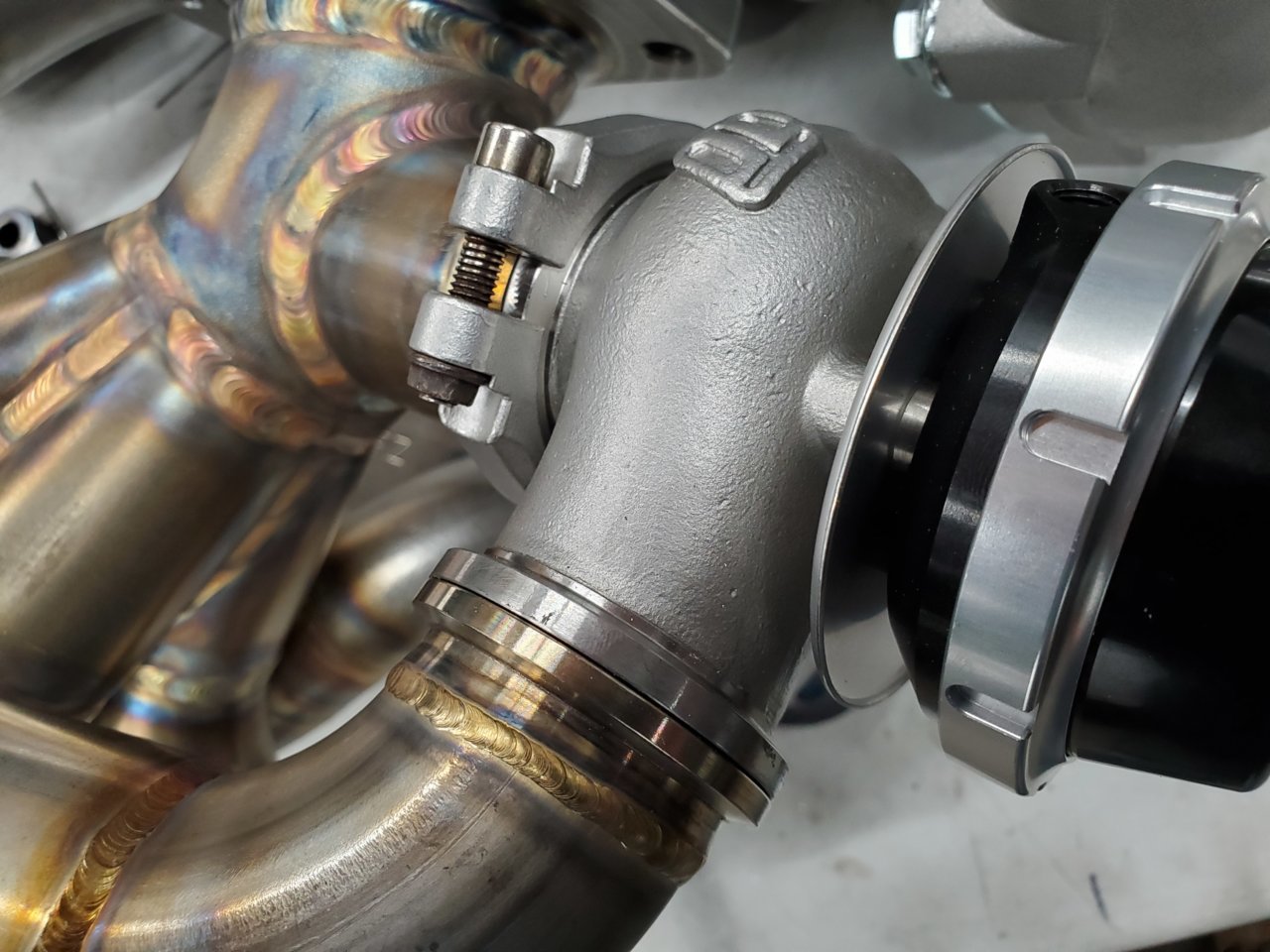

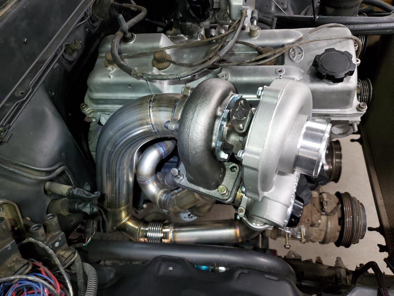

  10. Nov 19, 2022 at 12:05 AM
    betterbuckleup
    betterbuckleup Well-Known Member
    Jun 26, 2017
    #222483
    4,832
    Ian
    Concord, CA
    2000 Tacoma SC 2.7 4x4 5spd
    What's the purpose of that flex joint thing in the dump piping? It's all already rigid so I couldn't imagine there being any flex there?
    Manifold looks awesome though. Great welds.
    Speedytech7 likes this.
  11. Nov 19, 2022 at 6:14 AM
    Jon64l
    Jan 12, 2016
    #174799
    1,682
    Jon
    Flex allows for thermal expansion and a little wiggle room when putting it together. Any misalignment in turbo or downpipe won't let the wastegate seal.
  12. Nov 19, 2022 at 6:46 AM
    Torspd
    Torspd Tor-nication
    Sep 18, 2009
    #22958
    26,473
    Tor
    The Great America!
    MMVI 4.4L 4x4 Access Cab
    Torspd Custom Turbo kit [] Borg Warner 9180EFR Turbo [] Haltech Elite 2500 [] TiAL Q BOV [] TiAL V44 Wastegate @ 15psi [] CP Pistons [] CP Carrillo Rods [] ARP Head studs [] ARP Main Studs [] ARP Header - Head Studs [] Ported Heads w/ 1mm oversized valves intake/exhaust [] Brian Crower Forged Stroker Crank [] Darton M.I.D. Sleeved Block [] Kelford Camshafts [] Torspd 160* T-stat mod [] APR Large Fuel Rail [] Walbro 460 LPH E85 Fuel Pump [] FueLab FPR [] APR T56 Conversion Kit [] KP RACING Built T56 [] McLeod Racing Custom Twin Disk Clutch [] One Piece Aluminum Driveshaft [] MGW Shifter [] Custom lowering kit [] Ohlins Front Coilovers [] QA1rear shocks [] Custom Ron Davis Radiator [] Dual SPAL Electric Fans []
    Saw the same on a race car that was high hp. The same thing, the color faded into what you have there pretty sure it was black as well. Performance goals. :D

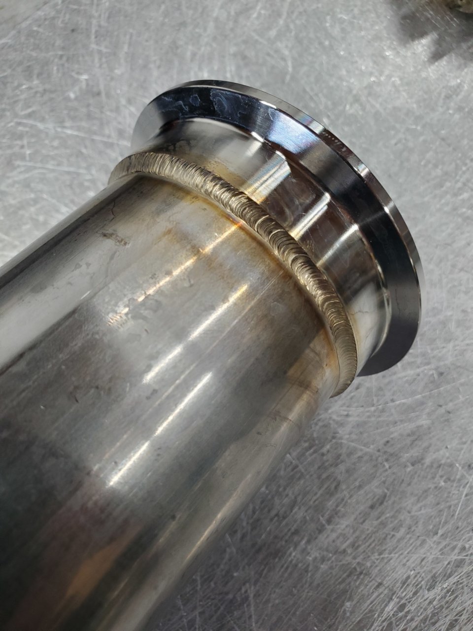

  13. Nov 19, 2022 at 6:49 AM
    Torspd
    Torspd Tor-nication
    Sep 18, 2009
    #22958
    26,473
    Tor
    The Great America!
    Fantastic work as always. :thumbsup: I also like the design of that T3(?) flange.
  14. Nov 19, 2022 at 10:23 AM
    Jon64l
    Jan 12, 2016
    #174799
    1,682
    Jon
    Thanks! Doing what I can.
    Yeah it's a cool billit transition from round to T3 I found on ebay.
