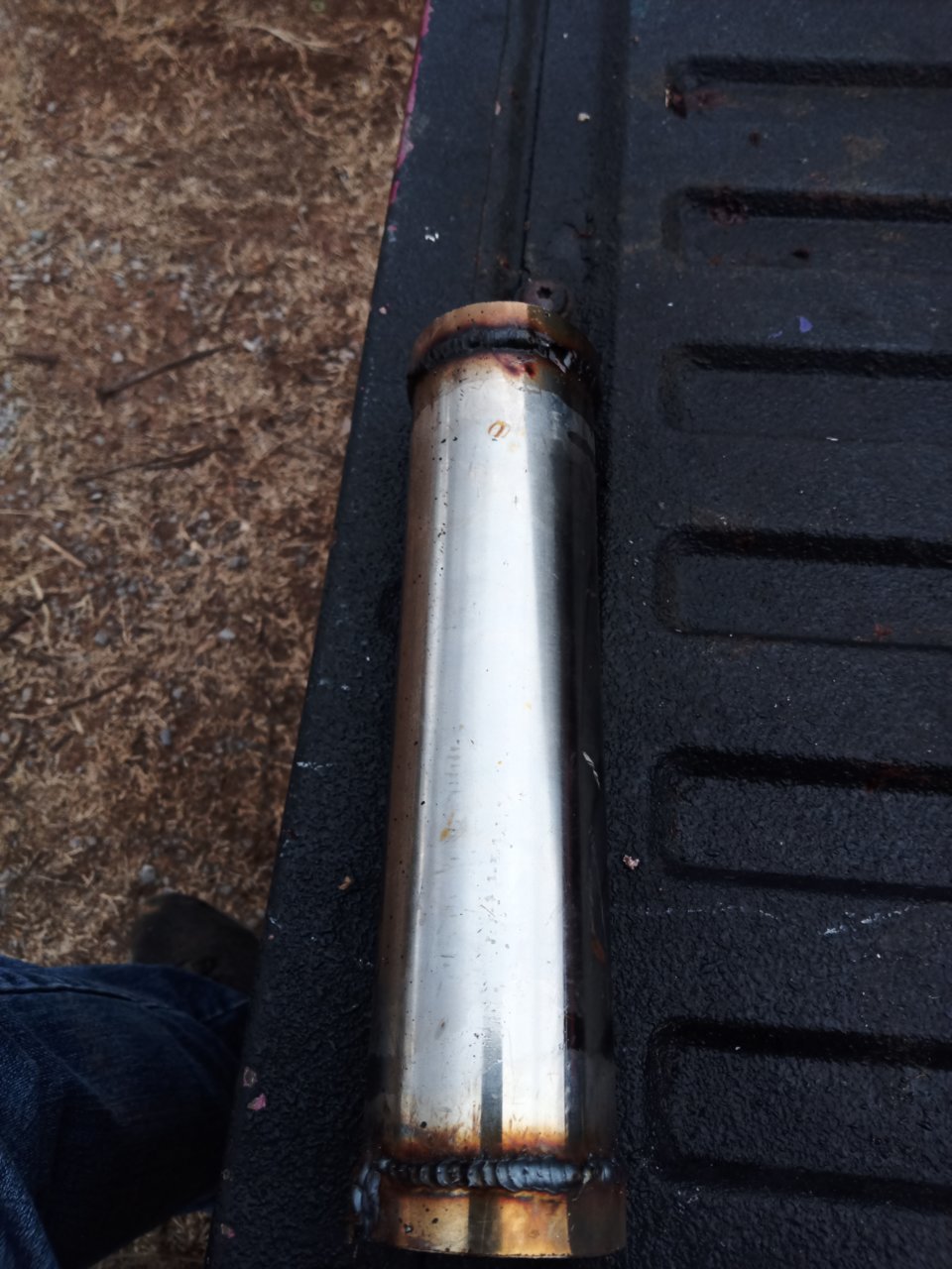

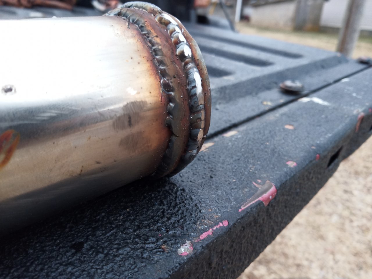

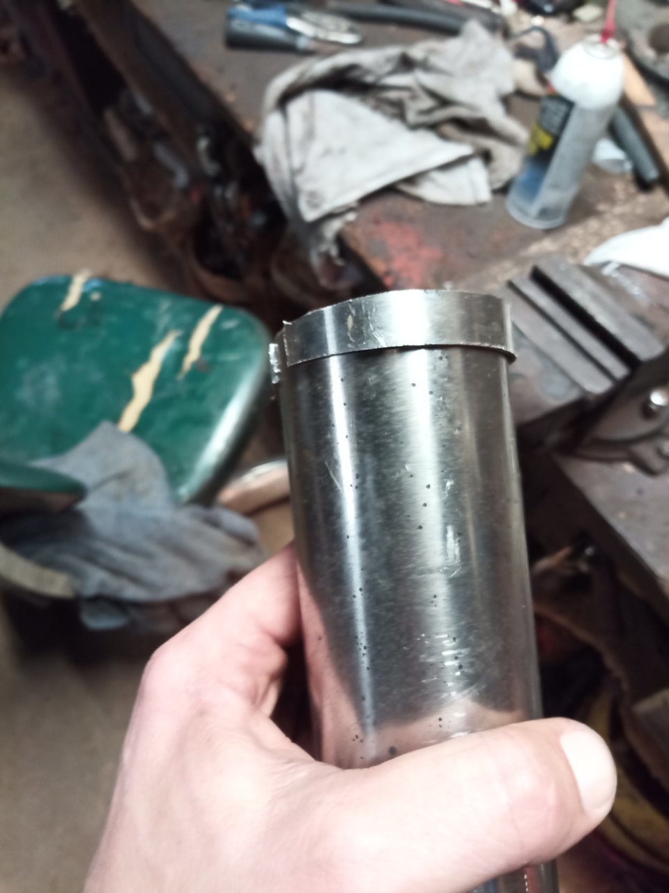

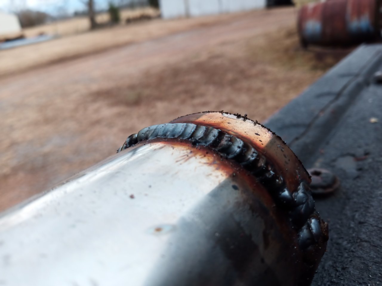

    Well at some point that chinesium diaphragm in my bov went out, had been noticing a rough idle once the truck warmed up and I pinched the line going to the bov off and the idle got better... I didn't have any 2" pipe, just 1.75" so I cut one to length and then I cut two more rings for each end to get me up to size and glued it together. No bov for me... For now waaaahh tu tu tu tu tu
    IMG_20221230_140826_071.jpg IMG_20221230_140836_915.jpg IMG_20221230_142726_518.jpg IMG_20221230_142822_780.jpg
    Just gotta knock some burs off and tighten it back up

    Oh and for those of you that were keeping up with math and stuff... 1.75"+ the thickness of exhaust pipe doesn't quite make 2". Had to add another bead all the way around and then even used some old water hose to make sure everything was good and tight
