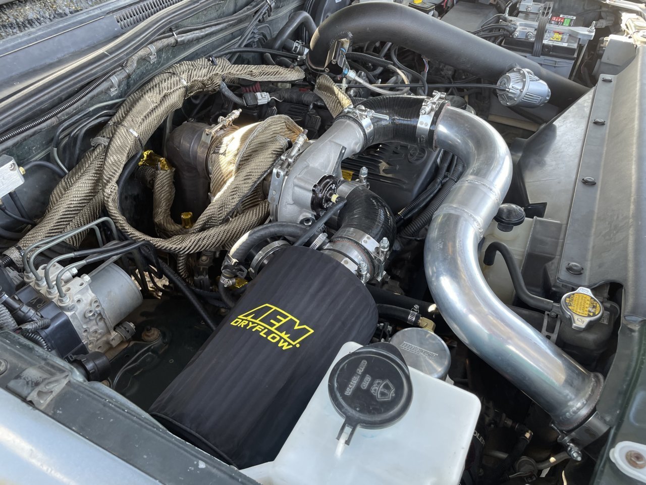

    I had planned on using a 3rd gen stock airbox in my 2nd gen, but there was an issue with the lower section of the box hitting the wastegate so i just scratched that idea and sold it. It would have bolted up in 2 of the 3 stock holes though and i was going to cut off the extra one that is off the side. I too wanted a stock style airbox since i drive on a dirt road everyday, but it didnt work out in my case. I am running a large AEM cone style filter and one of their socks which has worked well so far, but i dont drive the truck thru water, so it probably isnt great for that

    Gotcha. Ya it seems people have good things to say about the pre-filters on those.
    Is that a dry or oiled filter?

    It is a dry filter
