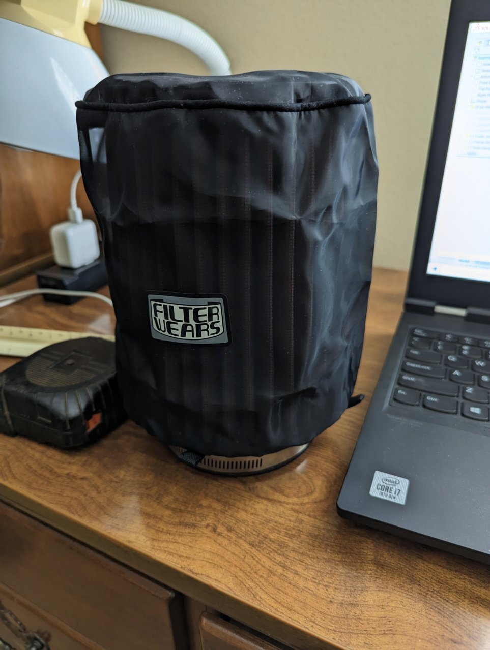

    Going to try out this other type of prefilter. Tighter fit than the aem and almost half the price.
  15. Jan 18, 2023 at 2:03 PM
    betterbuckleup
    betterbuckleup Well-Known Member
    Jun 26, 2017
    #222483
    4,769
    Ian
    Concord, CA
    2000 Tacoma SC 2.7 4x4 5spd
    Got the same one for the intake I just finished up
