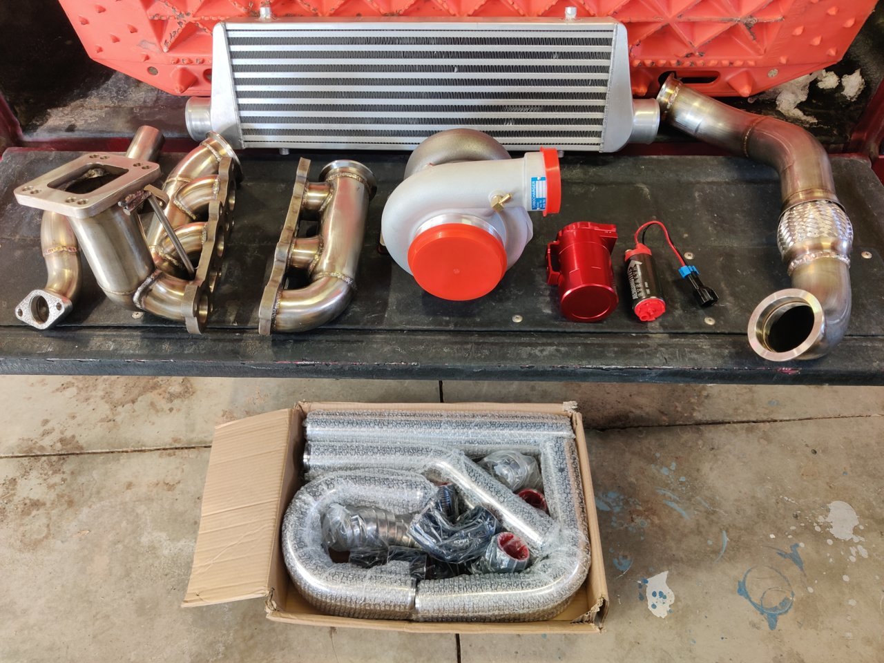

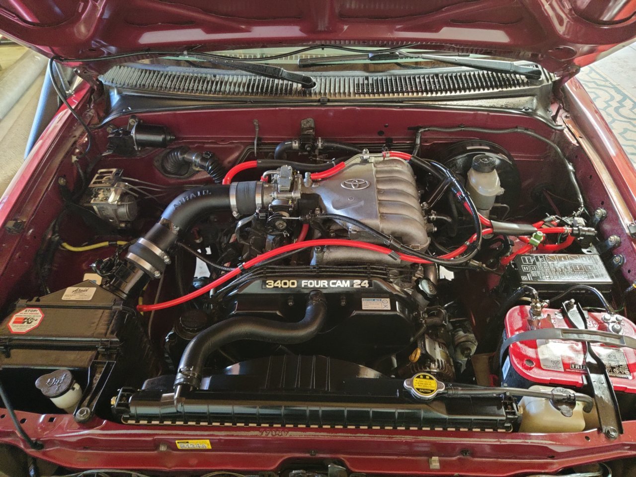

  14. Feb 20, 2023 at 8:26 PM
    unstpible
    unstpible Well-Known Member
    Aug 16, 2012
    #84909
    3,593
    Derek
    Cedar City, Utah
    03 4x4 boosted V6 Auto 341k miles
    CX Racing Turbo kit. TransGo shift kit. All Pro Apex bumper and skids. Smittybilt XRC 9.5 winch. All Pro Upper control arm's. Bilstein 6112's with 600lb coils. Eimkeith's lower control arm reinforcement plates. Perry Parts bump stops. All Pro spindle gussets and alignment cam tabs. All Pro standard 3" leaf springs. Bilstein 5125's rear. Extended rear brake lines. Rear diff breather relocation. MagnaFlow catback with resonator. Bluetooth stereo. Memphis 6x9 door speakers. Diode Dynamics SS3 Pro Amber fog lights. Single piece headlights. aftermarket grille. Anzo taillights. LED 3rd brake light. 4runner sunglass holder and dome lights. Master Tailgaters rear view mirror with 3 directional cameras, G shock sensors, and anti theft system. Honda windshield washer nozzles. Stubby antenna. Scan Guage II. 2nd Gen Snowflake wheels powder coated black. Cooper Discoverer ST Maxx 235-75/16 Denso 210-0461 105 amp alternator. Speedytech7's big wire harness upgrade. Aeromotive 340 fuel pump. Haltech Elite 2500. Tacomaworld sticker. Tundra brakes with Adventure Taco's hardline kit
    Here's my starting point. Total boost noob, literally had to Google the different between a wastegate and blow off valve but I'm not completely useless with a wrench.
    Technically the turbo is on the truck now right?
    GT35, T4 .68AR, ball bearings.
    CX Racing manifolds.
    2.5" intercooler pipes.
    PCV oil catch can.
    when I bought the truck it had a few evap leak codes so I've gone through and replaced damn near all the vacuum and evap system so no old vacuum lines here.
    Maybe I couple Silicone lines that shouldn't be Silicone but I didn't know that at the time. Thanks @Speedytech7 for the heads up.
    Now for a little word vomit :puke:
    Maybe this would be better posted on my build thread (Little Red Creeper) since it's mostly me collecting my thoughts and parts but I welcome and look forward to the collective insight, suggestions, and feedback :hattip:
    Looking at TiAl wastegates but I don't know what size to use 38/44mm :notsure: there's also different mounting styles, I'm assuming I won't be using the Vband style
    I'm going to pull the trigger on this Innovate Motorsports Boost/AFR combo guage and a 52mm A pillar mount.
    https://www.summitracing.com/parts/inn-38920
    LCE has a nice manual "Boost Tee" boost controller that should be enough for my application
    https://www.lceperformance.com/ProductDetails.asp?ProductCode=1072103
    I haven't decided on a Blow Off Valve and might just skip that for now
    :crapstorm:
    I need Oil feed and return lines, not sure on the correct AN sizes (or what AN even means).
    Still need to make a decision on injectors.
    I need to replace mine just from a maintenance standpoint but feel like I might as well put in slightly larger injectors.
    I don't plan on using meth injection just yet but believe it will be in the future, heat can be brutal around here.
    Spark plugs are fresh coppers from the dealership so ill just gap them a little tighter.
    I don't think I've seen anyone using a snorkel with a turbo so that's something ill have to figure out or remove.

  15. Feb 20, 2023 at 8:56 PM
    Jon64l
    Jon64l Well-Known Member
    Jan 12, 2016
    #174799
    1,604
    Jon
    2000 4runner, 1996 Tacoma
    Congrats and welcome to the club.
    For that kit you would use the older style Tial 35/38mm 2 bolt diamond flange wastegate. Don't buy ebay junk, even if it says Tial. Lots of fakes. Only buy from a real name brand shop. Spending a little more on a quality gate is worth it.
    You could move to a V band gate, 38 or 44 but will need to modify the manifold and dump.
    Next skip the boost controller for now. That money has other holes to fill. Just run a low psi spring and be happy.
    Just because the plugs are new doesn't mean they are correct. They need to be a colder heat range. Good call on knowing you need a tighter gap though. Ik22 are good, or Bkr-7e (must regap).
    You could probably get away with 4psi with stock injectors. I couldn't rev out stockers with Trd SC without leaning out. They were good to 4k rpm and 6psi. Turbo can flow sooo much more, and IC helps alot too.
    Let the games begin.
