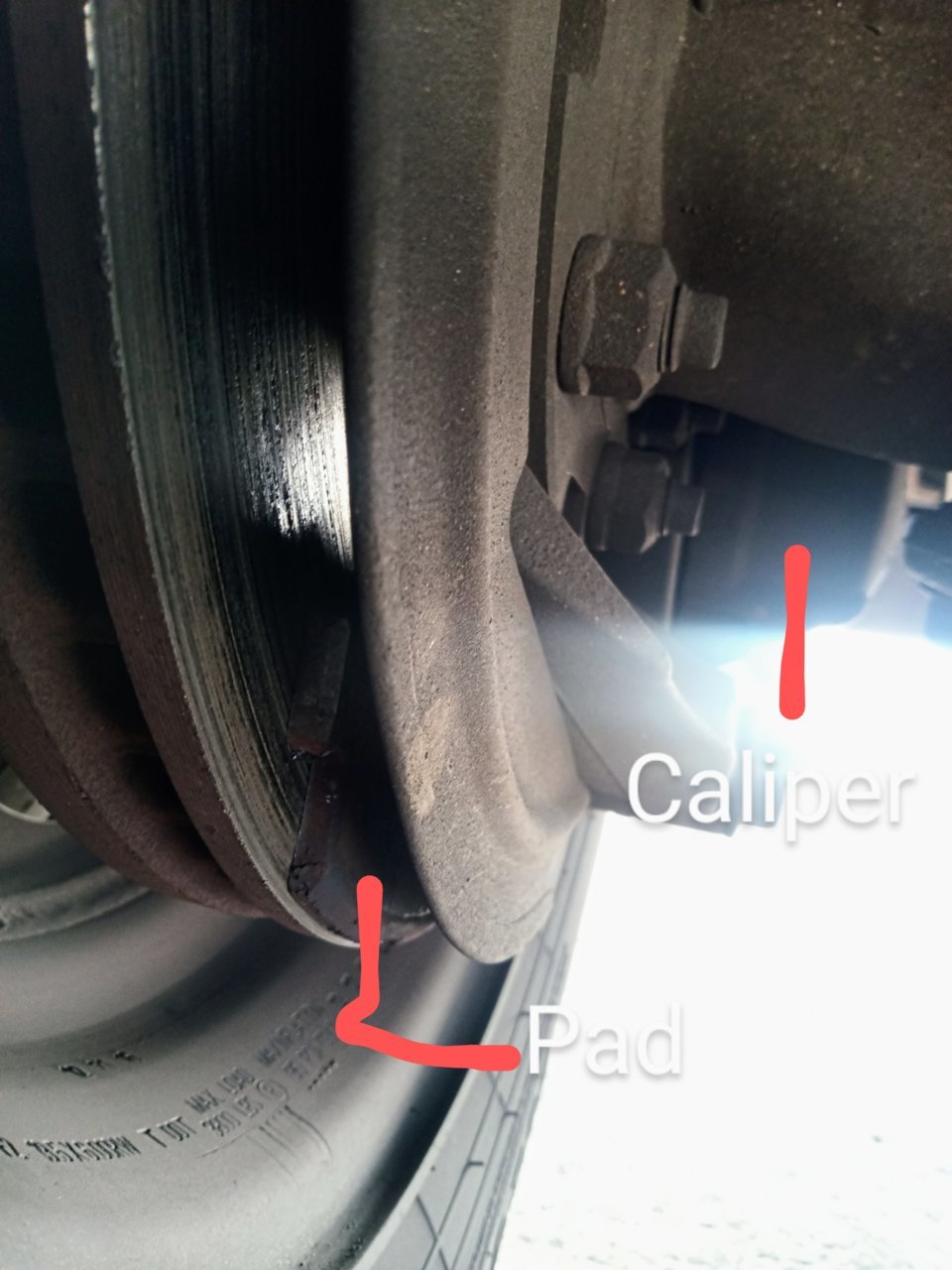

    Just got a different work truck (ram 4500 so it has a turbo) as a spare for our branch... Glad we made it back to the shop

    Well now. Full float brake pads. Neat-o

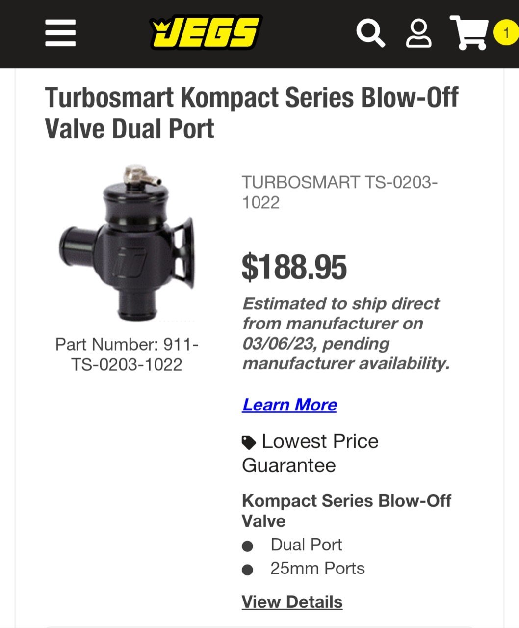

    This is the recirc I'm using.

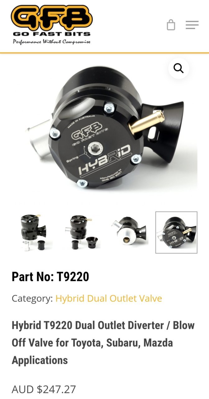

    Still looking at BOV's. GFB makes an adjustable dual port plum back that's got my attention.
    Or there's a turbosmart dual port bov similar to what @Jon64l is running.
    My feverish covid brain is a bit fried so everything is sorta blending together but I believe the GFB is completely adjustable and the turbosmart is set at 50/50 but comes with an optional plug for 100% atmosphere venting.

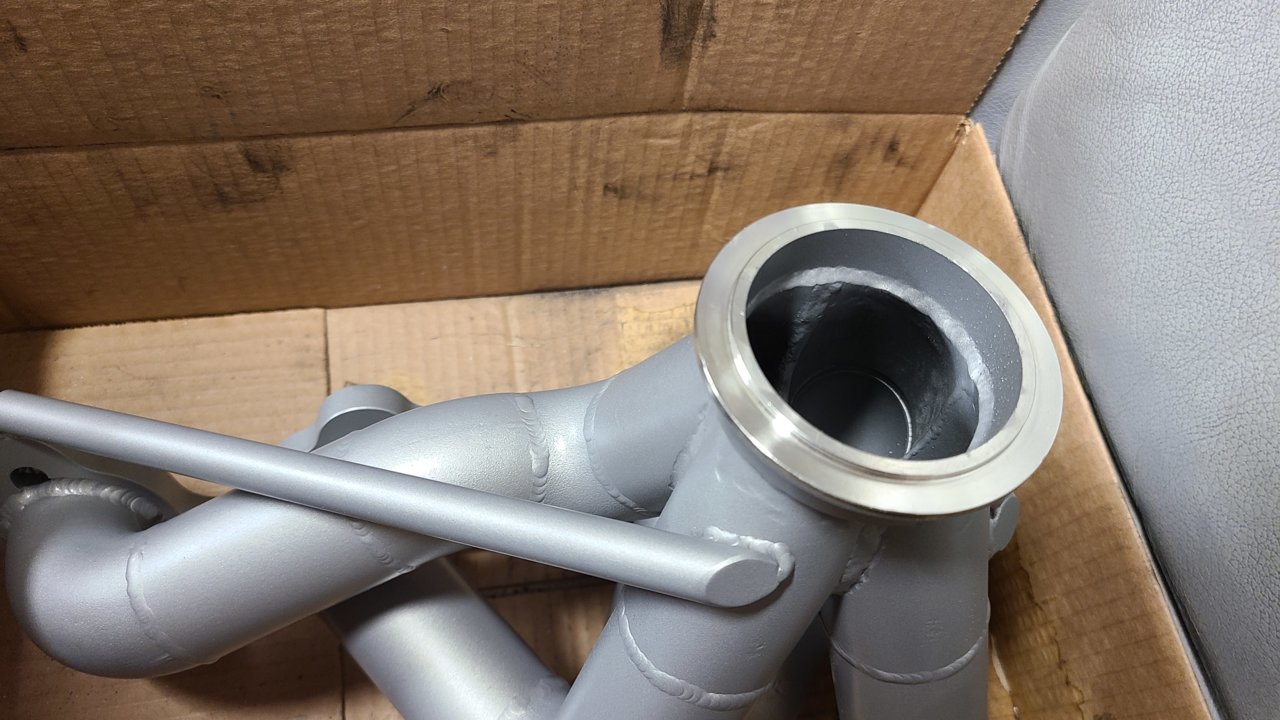

    I had this one ceramic coated for @BassAckwards, by Polydyn. Very well done, and still holding up just fine. Last I heard. The difference between the metal use in that manifold, versus Chinese ‐eBay ones, is that I used 321 stainless for his.
